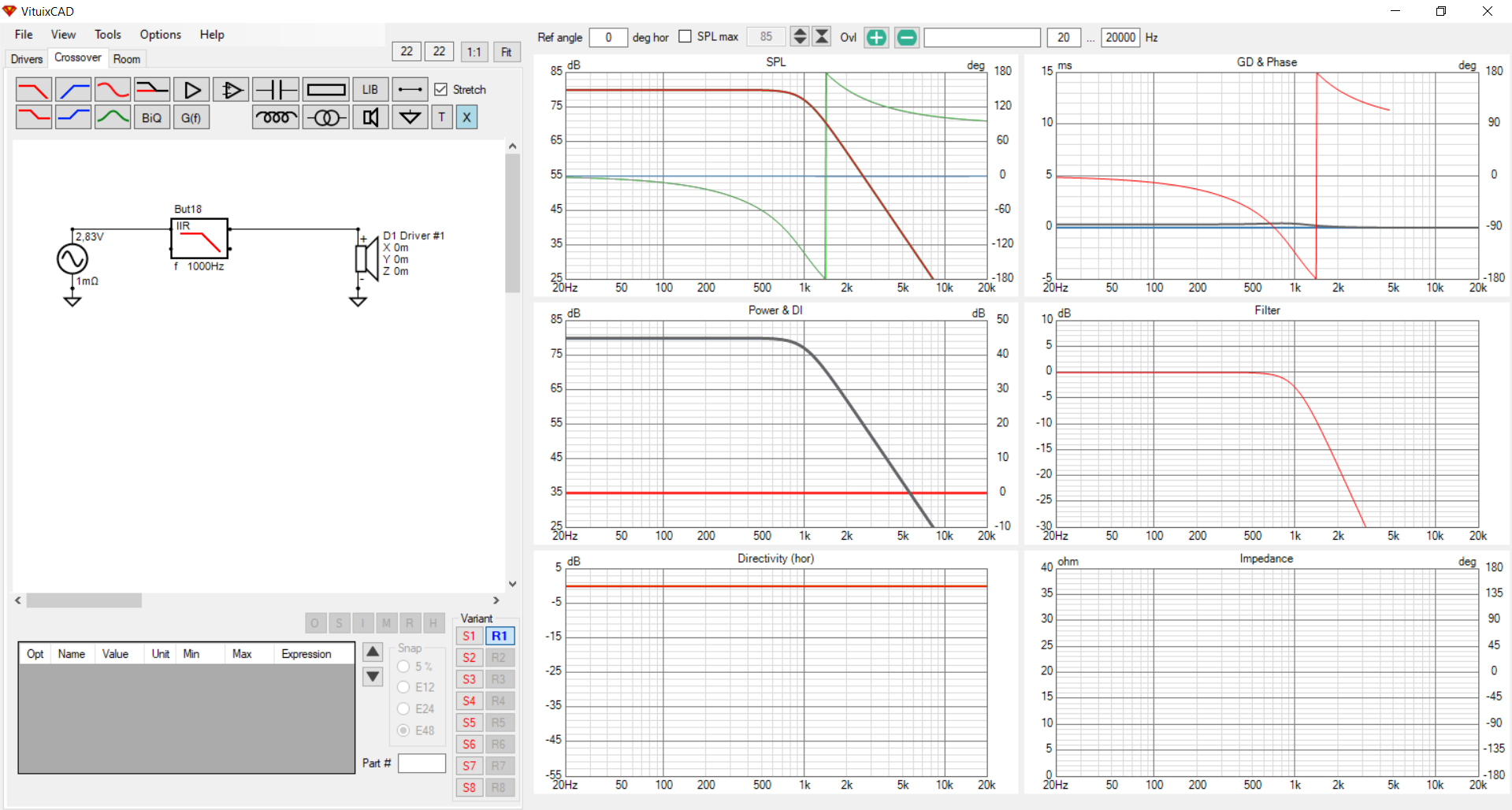

VituixCAD has target curves built in so no need to export or import anything for crossover work in VituixCAD. Maybe there is possibility to export FRD of a target curve as well if you have to use some other program.
edit. easy and fast with VituixCAD if you need to generate FRD for another program, hope it helps: open up a new project, it already contains "ideal" driver so drag and drop digital filter to the xo diagram and wire it all together (source-filter-driver). Hit Export from the File menu. There is frequency response export that can output to .frd file among all kinds of other options. ps. use diffraction tool to export full "spinorama", simulated frequency responses to off-axis angles as well.
