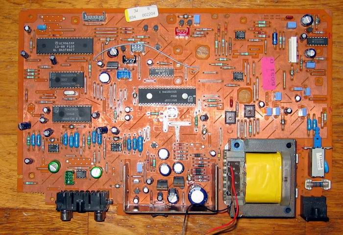

Hi DoctorWho70! Now I know that you have CDM4.Can you help me with any value for the two trimers-4K7 and 22K ,because I can`t hit the precise position for this two.The cold start is in the big capacitor in my CD-65DX-6800uF/16V.In the schematics I can`t find any error ,but when the player start with 10000uF/25V(new capacitor) I haven`t this problem.Pls help for my CDM4-I can`t sleep like a log when my CD-65 is dead for this moment :bawling:

Pls if anyone can ,I attach one picture of the CD582 like my CD-65DX.
I can`t find the read points for the tuning of the two trimers- 22K 4K7.
If the answer is top-secret I have e-mail in the user info.Thanks!
this image is of the DAC and filter board, you are watching the wrong card, the trimmers of the laser adjustements are on the card under the motor and the laser head, all the CDMs have this electronic card on-board.
Check the service manual and you will see how the cdm is constructed, to accessing at your electronic, maybe you have to dismount the complete cdm.

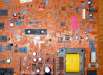

And what is this?I try to tune this two trimers in the attachment - 22K and 4K7.This is the problem in my case:
Default value : The player is Ok
I try to tune up this trimer : the player can`t read any CD
And now if anyone can help me: what is my problem.I love my player like ...
:bawling:
EDIT : if anyone can give me the value of this two trimers on my mail will be great: I am may be very stupid,but this value is for? 🙄

ok, your electronic is different from mine, but what you can see on page 10-11, regarding the sheets i sent to you, probably you have it in the card of your cd (a single card), in my cd there are many cards... but what you see on page 10-11 is probably the same that in your cd (if it's a cdm4) with the only difference that it is integrated in your main board.
so, read at page 45 about the regulations, and read also from page 40 to 46, giving an eye to the schematic of pages 10-11...
try to reconstruct your part of the schematic about your two trimmers and check if the circuits are similar.
if your mech is a cdm4 i'm quite shure that the circuit that controls the focus motor and the laser power need to do the same thing, also if the circuit seems to be quite different...
I don't know your cd, so this is the maximum help that i can give you.
Good luck
DoctorWho70

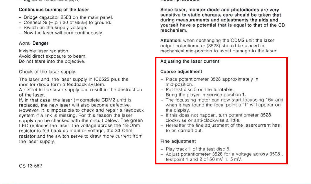

Sorry to dredge up an oldie but I just searched for the information contained within this thread and am grateful to those who provided it. What I really needed to know was what CD to use instead of "test disc 5" and in the end I used a normal commercial disc.
My laser current voltage read about 53mV but my focus offset was reading over 7 volts and could only be adjusted down to 6.xxV. I think the 22K trimpot is bad! On a quick test it does seem improved by that small correction. It's not dropped out yet and doesn't seem nearly as bothered by floor vibrations.
This is in an original Arcam Alpha.
Simon
A piece of advice: factory reference discs mentioned in service manuals are made of glass and have known focus offsets. There is no replacement for n original reference disc and in this case it is always advisable to use 5 to 10 different pressed CDs (not CD-Rs) for measurement and adjust player to an average value. This goes for focus offset. As for the laser current, make sure that it does not exceed the maximum tolerance on any of selected CDs.
