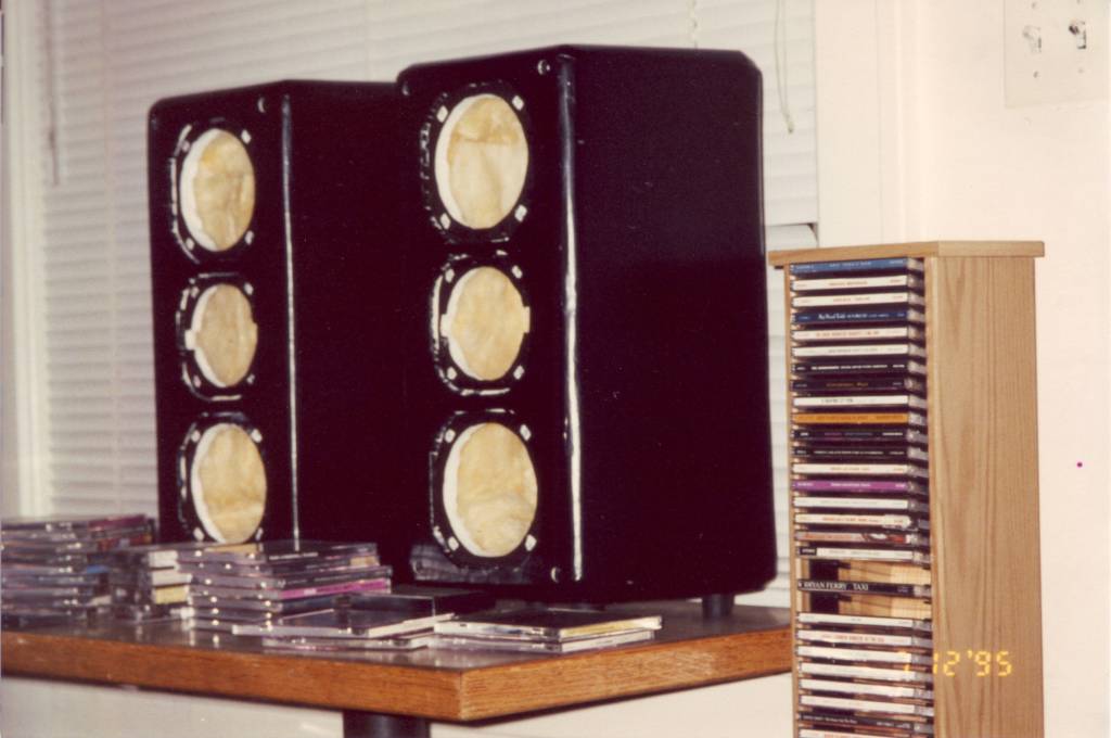

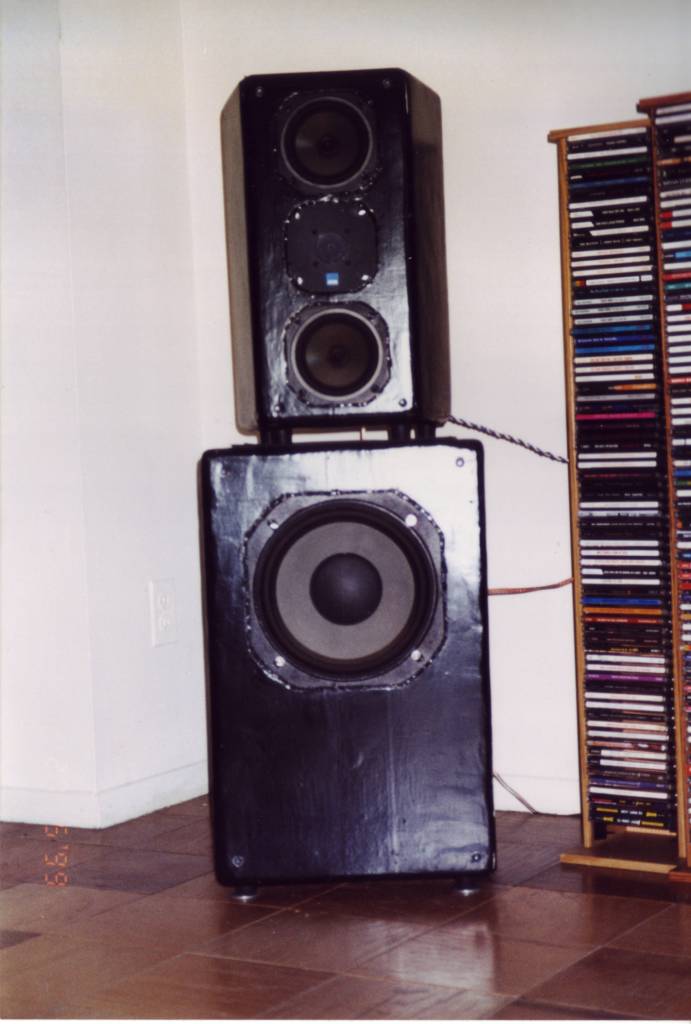

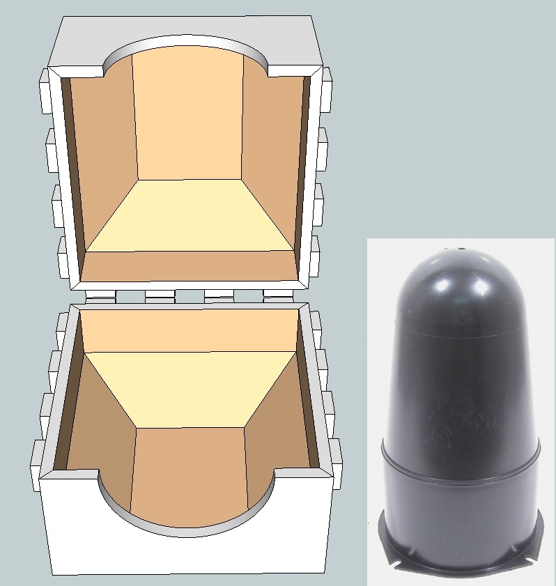

I made a concrete subwoofer
I cast a concrete subwoofer quite a few years ago. The outside of the mould was particle board. The inside of the mould was a 12*12*12 inch cardboard box that can be torn out though the speaker mounting holes afterwards. I used baby oil as the release agent. A trick was making temporary dividers that get fastened halfway down all around so that when half is poured, screw down a mould panel to close off the side, turn the mould over, remove the other panel, remove the dividers!, and pour the other half. I recall vibrating the thing by striking it with a wooden board many times in succession.
I didn't use metal reinforcement. I gave them almost a week to set.
The advantage of concrete is not only its mass, but also it's great stiffness when cast as a single piece.
