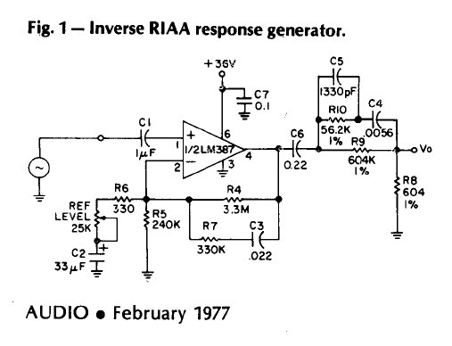

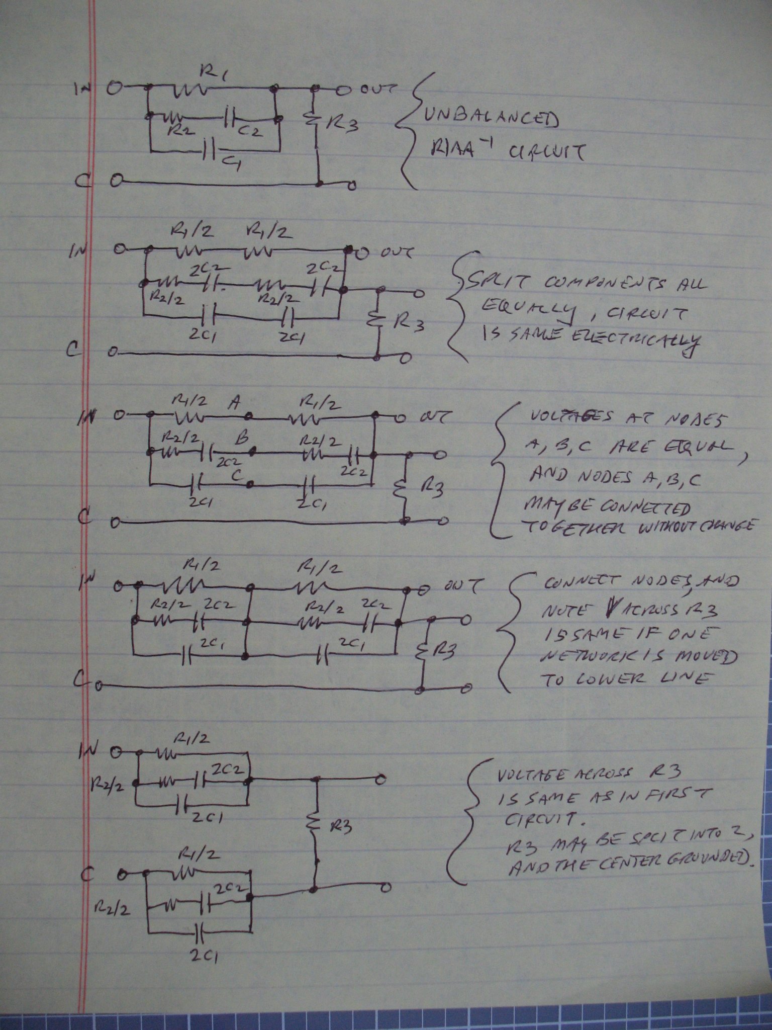

How to make an Inverse Balanced RIAA network?
Most inverse riaa circuits are single ended, though they can be applied to balanced circuits, but on conditions: what's the balanced circuit look like? Lipschitz is leading unconditionally always.
