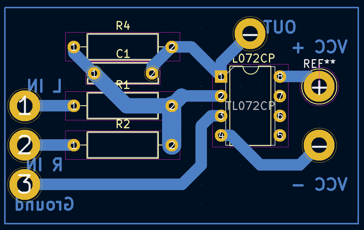

This is what I made and regroup the tube preamp art with schematic from the link of Rayma.
IS it ok please ? with resistor R1, R2 and R 4 will be 1Megaohms resistors Chris Hornbeck ?
I thank you
I thank you
With an opamp for the summing junction, R1 and R2 values don't have to be quite so big, but it doesn't really hurt anything. High frequency response isn't an issue feeding a subwoofer. But for stability, you'll want a small capacitor in parallel with R4. Maybe something like 1000pF to 10,000pF, and physically small enough to be mounted very close to the opamp pins. R4 can probably be a lower value, maybe as low as 100K (if R1 and R2 are 1M ).

BTW, the cathode resistor on your 12AX7 seems kinda large at 2K Ohms. Is that value correct?
Chris
Chris
Hello, Yes it's the good value....

the schematics, I add a capacitor C1 for the stability in parallel with R4
Is it ok Can I make it please ? Do I need a symetrique power supply? or not ? can use only pin 4 and 8 with a 9v supply ? Thanks

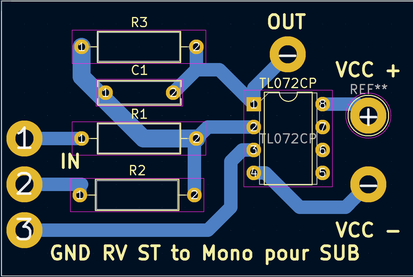

I made the last version and rename R4 to R3 it's more logic....
if it's ok I will make it Thanks
Opamp power supplies should be locally decoupled to ground, and the output isolated from the outside world with a couple-hundred Ohm resistor.

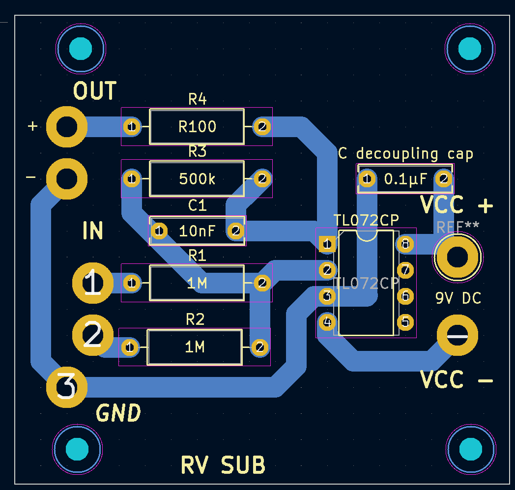

Hello Chris Thanks for the reply. I made some modifications after searching technical informations, I found a book of Texas Instruments OP amp and I calculate the value of R3 resistor, this is my last file I will made it with JLCPCB so if you have time to verify please before I buy the pcb it will be great. I thank you
Note: the 9VDC is filtered outside of this circuit
Sorry , I'm not very shure to understand because I'm French So I must put the decoupling cap connected to VCC+ and GND ? a MKT capacitor ? but what is the value ? how can I calculate the good value please?
I put the R4 between output and the aop
Am I right ? Thanks
Am I right ? Thanks
I would make R4 1000 Ohms and C1 330pF. Both Vcc+ and Vcc- need to be decoupled to ground, and they cannot just "float". They must be positive and negative with respect to ground, and their common "ground" connection needs to be brought to your board.
It's usual to tie off the unused opamp in the package, pin 7 grounded, pins 5 and 6 tied together.

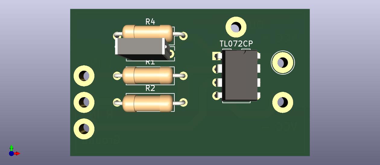

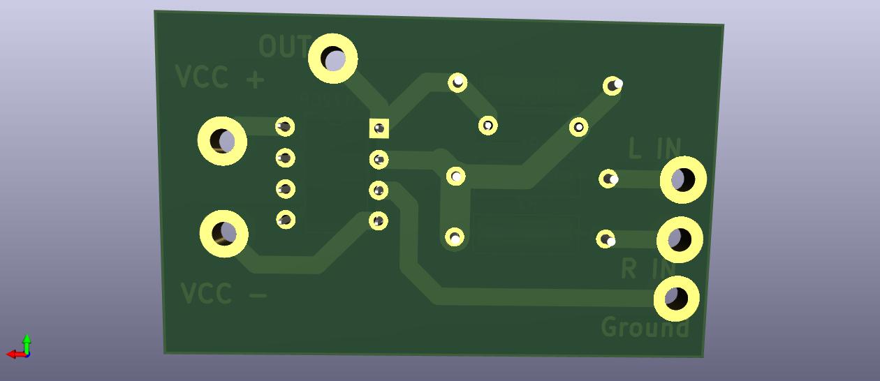

Bear in mind Your circuit is inverting the signal. (input on the inverting pin)
So invert the sub speaker leads or activate the phase switch if there is one.

Hello Thanks for the answer, I will make some modifications, and Yes my circuit is inverted because I connected the input signal on the IN negative pin 2 .
I must change it and connected the input audio signal on IN positive Pin 3.
Opamps don't work that way. You really should study a tutorial first, before wandering about in the dark. Opamps are not complicated if approached from a position of basic knowledge, and the general principles of feedback are necessary to understand any linear electronics. Everyone on this forum needs to understand the principles of feedback, and opamp theory is a perfect way to learn.

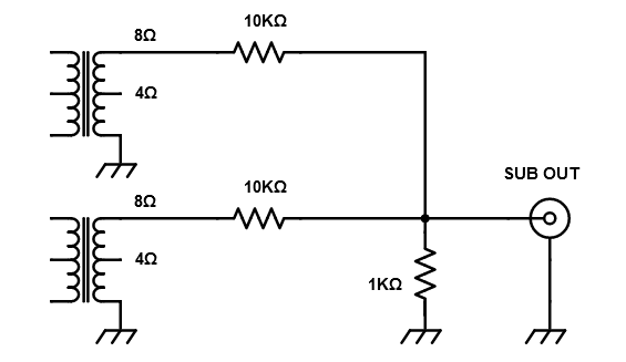

I bought my first tube amplifier the reisong A10
But there is not output rca signal to connect a subwoofer.
Try this passive circuit, it works!
It connect to the output transformers, 1/4w resistors should be adequate. If you found the output level is too high, reduce the 1KΩ resistor value.
