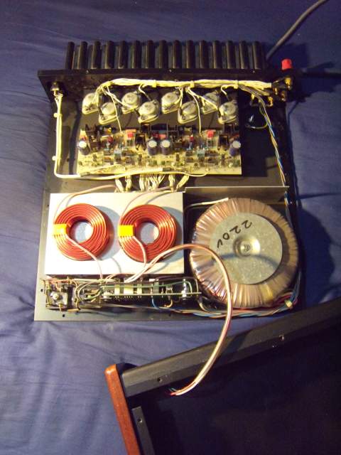

seen inductors inside an A/B production amplifier before ?
More exotic choke power supply examples, which may sound less rare to you ;
- Cello, e.g. Performance, Encore.
- Viola, Bravo model.
- From fellow forum member Mr Gerhard, bass amp for the Cerubin loudspeaker.
Example of a current production power amp with regulated output stage rails (capacitance multiplier), Orpheus Privilege.
(I was informed recently that the Sanken regulated amp got booted to obsolete stage. As the Omega man is retiring in a couple of years also, all good things come to another end)
The L in a an rCLC PSU reduces mains interference feeding into the amplifier.
It also reduces the rectifier noise trying to feed in with the interference.
How is the value determined ...?

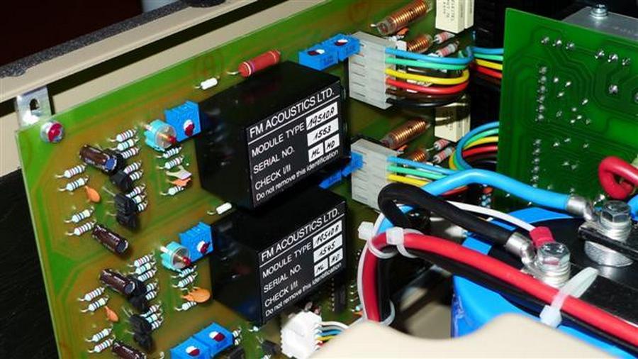

Here is an example of an amplifier that eventhough made almost 15 years ago preserve some rules that a lot of people scream about in our forum for many years ( for people that manufacture and construct ) and the amp it shelf sets a level of perfection in amplifier construction .
kind regards
sakis
I see a huge number of potential problems with this amplifier, from the use of Fastons for signal wires, to screw terminals for power leads, to various other quick disconnect fittings on the circuit boards. All of these kinds of connectors can cause a relatively high resistance, or in the case of the screws, work loose. Heat cycling for example can make screws come loose. Any connection that's important to me gets soldered.
