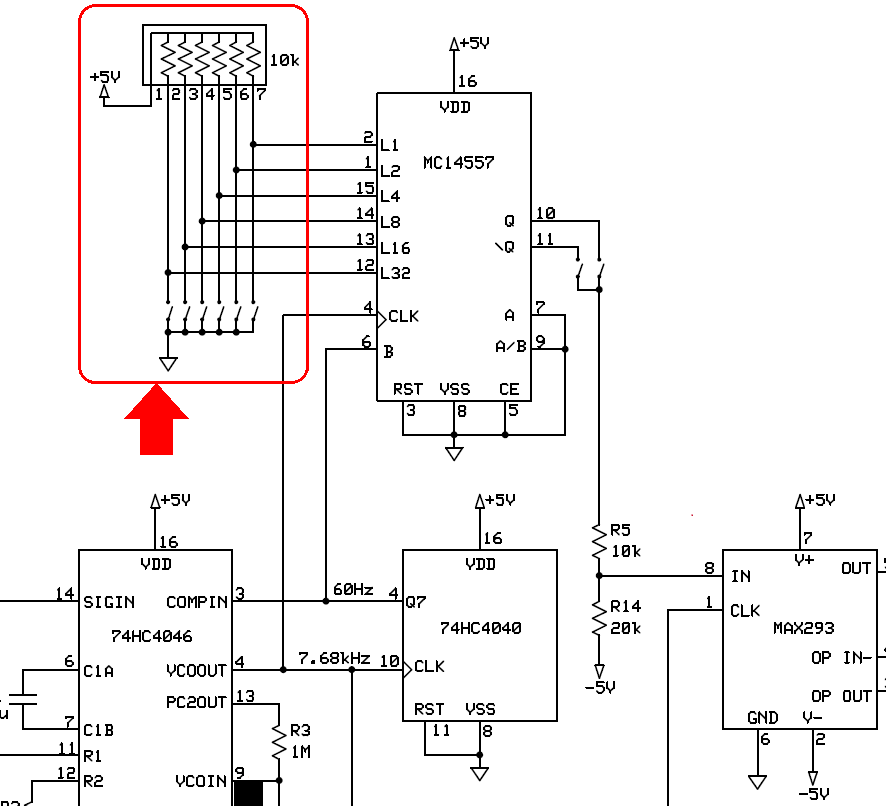

In the attached schematic fragment, it's circled in red. "Phase" is treated as "delay" ; the MC14557's delay is adjusted. The six dipswitches on the left provide fine_adjustment, and the two dipswitches on the right (@ pins 10 & 11) perform coarse_adjustment.I don't see a phase offset adjustment on yer diagram? I would of used a common CMOS Schmidt trigger instead of a linear +/- circuit.
