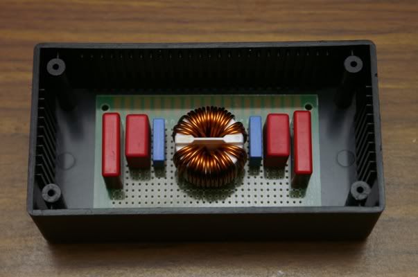

I think Felix PCB's are no longer made, but if someone wanted to make them up again, it's worth it.
I'm not contributing anymore to design in this topic, but I do want everyone to get accomplish the pleasures of power conditioning.
One note, if possible put the Felix close to your conditioned piece. It's convient to box them together and away, but the closer the better. Part of that is to reduce the RF the secondary capacitor sides have to load down as there is a limit on attenuation.

Typical EMI filter with common mode suppression? What is so great about this.
it will work well when placed on your PC etc

It was a (430 post) hobby group project (often having very little electric/electronic knowledge). Sometimes they would use rather large capacitors (some with questionable safety ratings) and small chokes.Typical EMI filter with common mode suppression? What is so great about this.
Note that the thread run for a period of about 6 years. The questionable components arrived late in that time span.

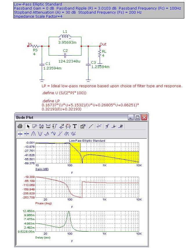

Can you please show us how it should be done then?
You could follow the power transformer with a symmetrical PI and calculate the values for L & C for any characteristic Z, slope and amplitude ripple you want.
An elliptical filter, hope this helps mrWagner.
