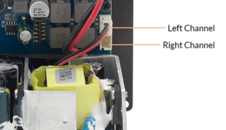

Using 2 Arylic Up2Stream Plate Amp 2.1, I intend on building 2 wireless speakers. When I use these speakers together via the Arylic app, one should function as the right speaker and the other as the left speaker. But if I only connect to 1 of the speakers, I would like it to play both left and right channel, so that I don't miss out on anything. How would this be done?

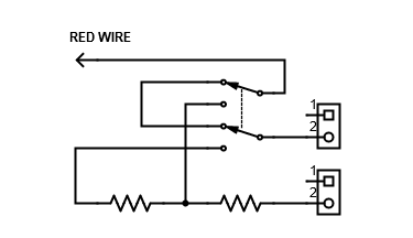

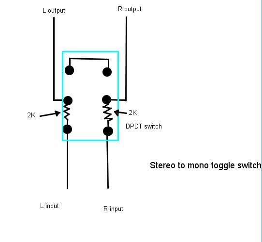

If you want to use a switch, My suggestion is use a DPDT switch and two resistors (1kΩ) to sum the stereo channel to mono.
