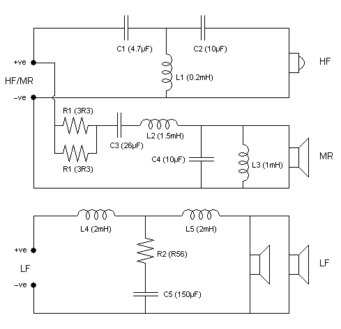

B&W 802 XO
This is the XO. The LF section, I have lost L5 in 1 speaker. Hoping to replace just 1, but 2mh ferrite core isn't available easily. So I may do both of em.

You could order the 2.2mH and unwind (or backwind) a few turns...
I mention adding backwind just incase the enamel is all melded
and impossible to peel excess turns away non-destructively.
Adding forward turns to the 1.8mH also an option, but the core
will go into saturation at slightly lower amperage.
Increasing 1.8mH (100%) to 2.0mH (111%):
Requires square root of 111% original turns, or 105.4%.
The reciprocal of this is 95% of original current rating.
Decreasing 2.2mH (100%) to 2.0mH (90.9%)
Requires square root of 90.9% original turns, or 95.3%.
The reciprocal of this is 105% of original current rating.
