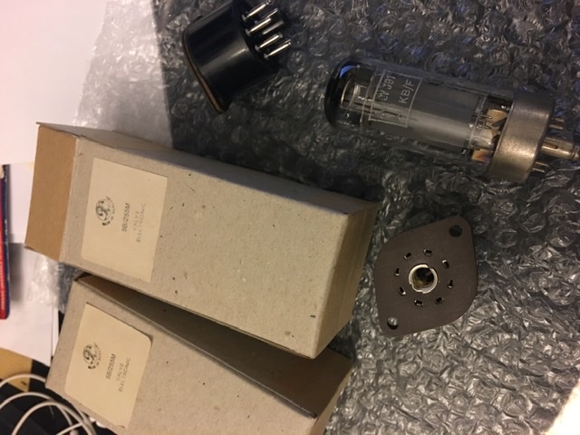

I did a similar exercise to use loctal 5B/255M in place of KT66 in Quad 2s. There were also pins that shared connections to the internal electrodes, and I just selected the easiest match between the pin of the top base and the octal base.
In hindsight, when I looked at 7C5 tubes, which are loctal 6V6 tubes, I noticed that there are standard pins out for loctal power tubes, but because I had not used the same cathode pin on my original attempt, my converter bases only worked for one tube type instead of being generic.
The octal bases are very cheap on eBay - $1 each I think.
I used the phenolic sheet wafer type bases on top so it fitted flush to the top, and was easy to glue together. I think I also added a ferrite bead on the grid pin, because I was worried about the extra wire length.
