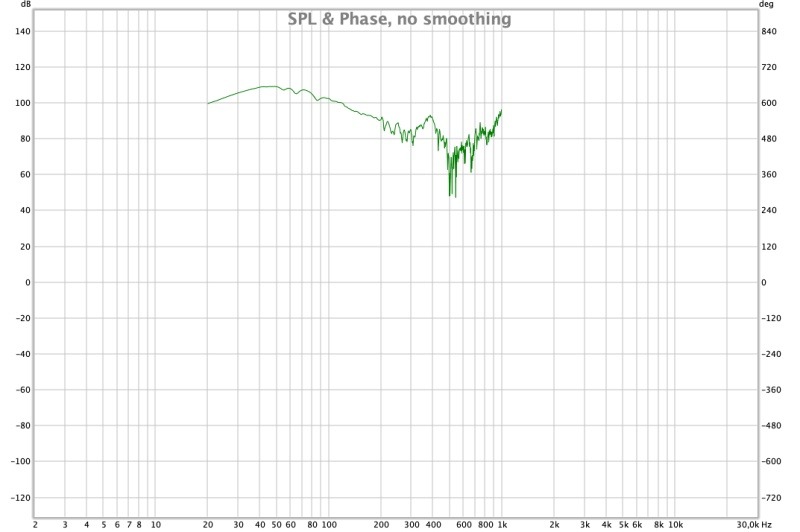

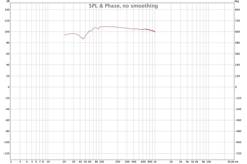

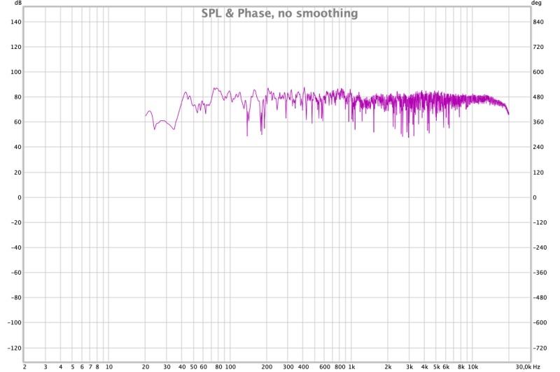

I did my homework... I put the loudspeaker in the middle of my living room and took some more and hopefully better measurements: 1)20-1000 Hz one inch from the midwoofer 2)20-1000 hz one inch from the port (now set to 13 cm) 3)20-20000 of the speaker from 1 mt

Even with the wrong scale it's clear that the level decreases some 5-6dB between 100Hz and 700Hz. The big 2m4H series coil could contribute to that. Combine it with some reinforcement from nearby boundaries (what is the listening setup?) and I would suggest a change in the baffle step correction. This doesn't seem a low frequency tuning problem to me, more a setup and crossover issue.
Take my comment as that of an inexperienced DIYer: yes midwoofer has a declining trend in that area but this is not so obvious from 1 mt measurement The inductor is 2,2mH 0,18ohm, for the sweeps I have used a calibrated Umik-1 the RME ADI2-DAC and a LFD zero mk3 integrated amp
