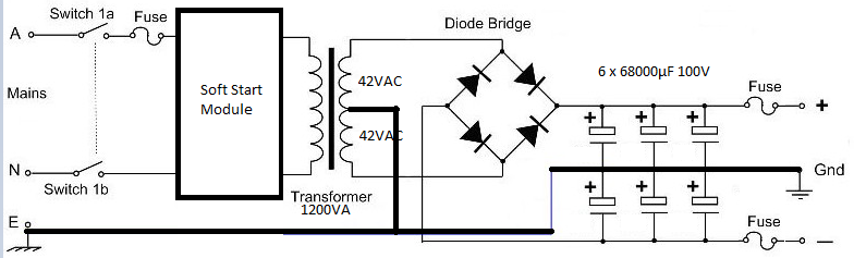

Hello

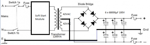

I have some problems of blown fuses on the +/- Rails when it was put just after the rectifier my question was is it better in this configuration ? the Power aplifier was chines copy of KRELL KSA100 What kind of fuse i must put on the +/- Rails for supply the power amplifer boards?
THe shematics display the NEW setup! Before i have put the fuses on +/- Rail Just after the rectifier. And some time i have blown fuse when i turn on the PSU (Fuses 10A) My question was is it better to do like on the schematic.
What kind of fuse i must use to put on the both raill for supply the 2 power boards a chinese copy of KRELL KSA100? Fast or Temporized Fuse and how much Amps?
Thanks for your help.
Here is it the setup:

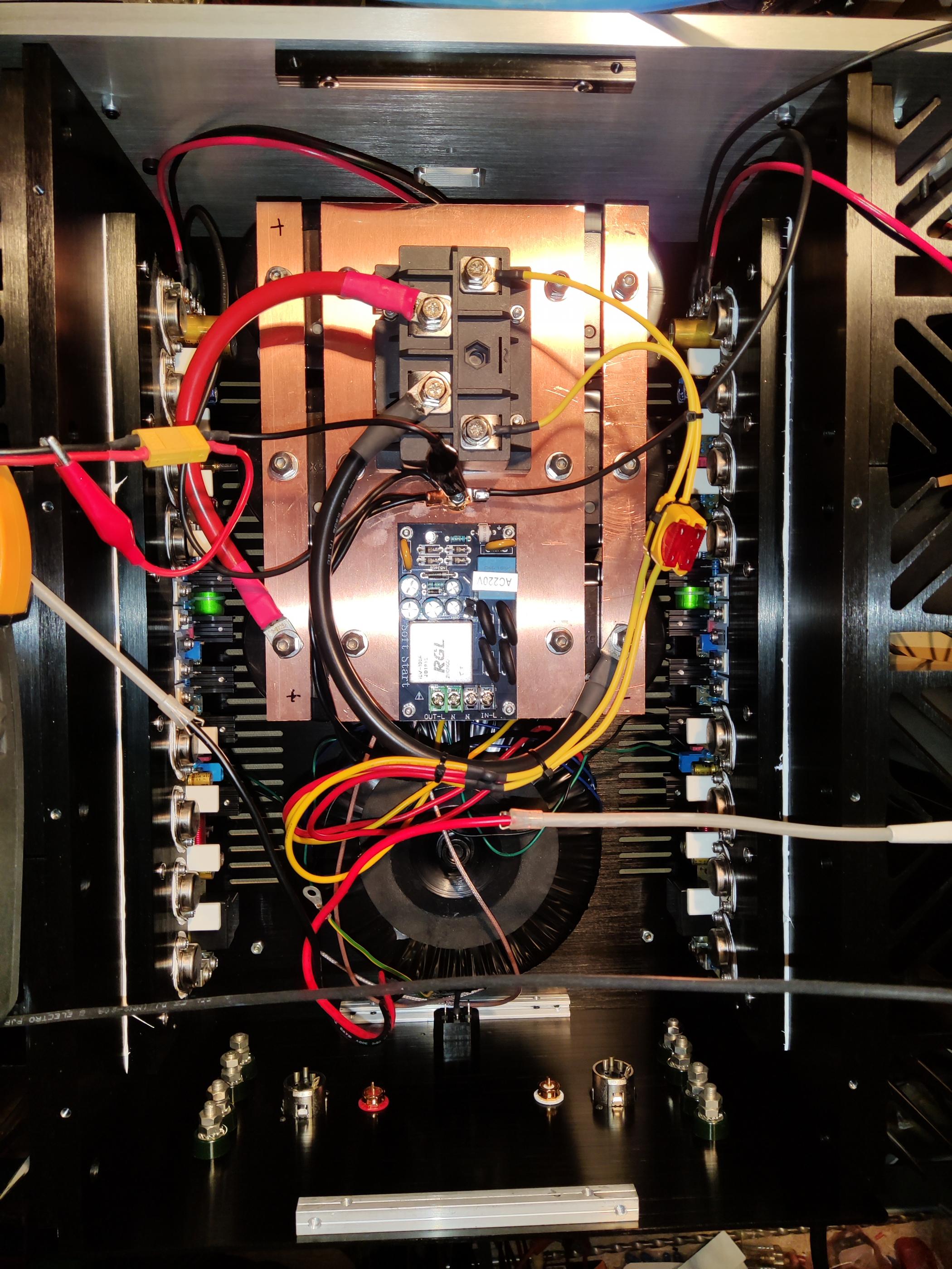

The Transformer was a 1200VA 2 x 42VAC at the secondary Primary was 230VAC the capacitys was a 6 x 68000µF 100V On the amplifer board i have not the current but it was a 80W class A amplifer very few information about it here the chiniese description of the boards:
