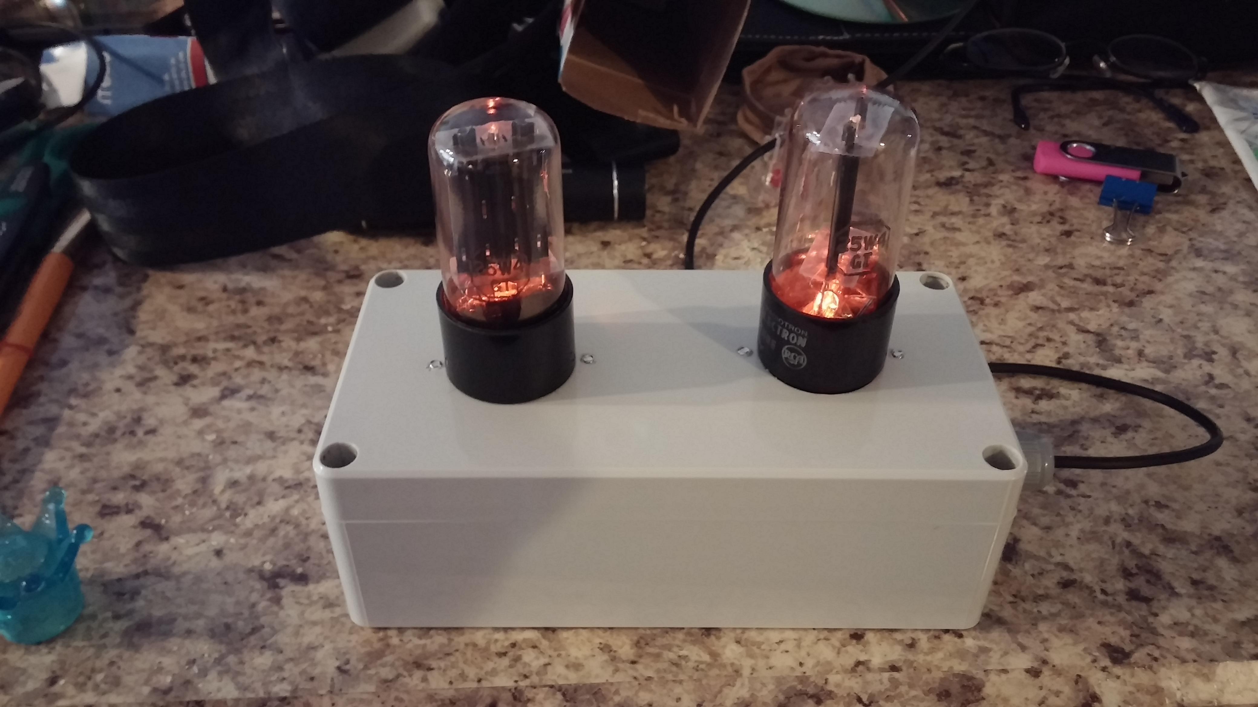

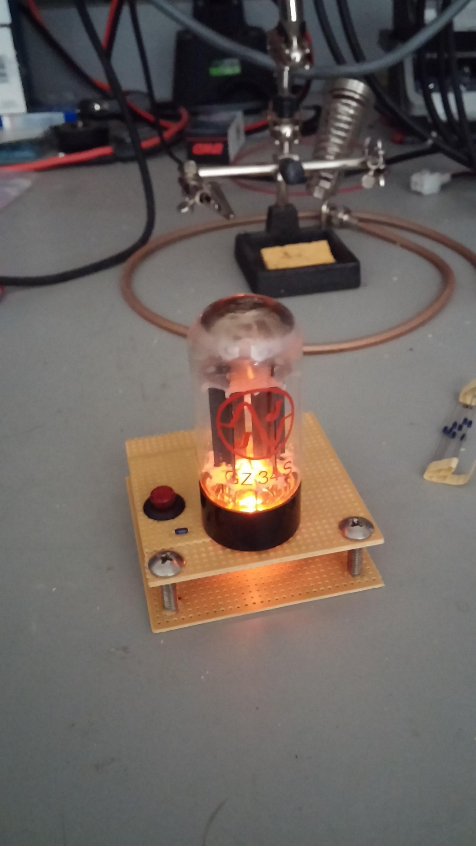

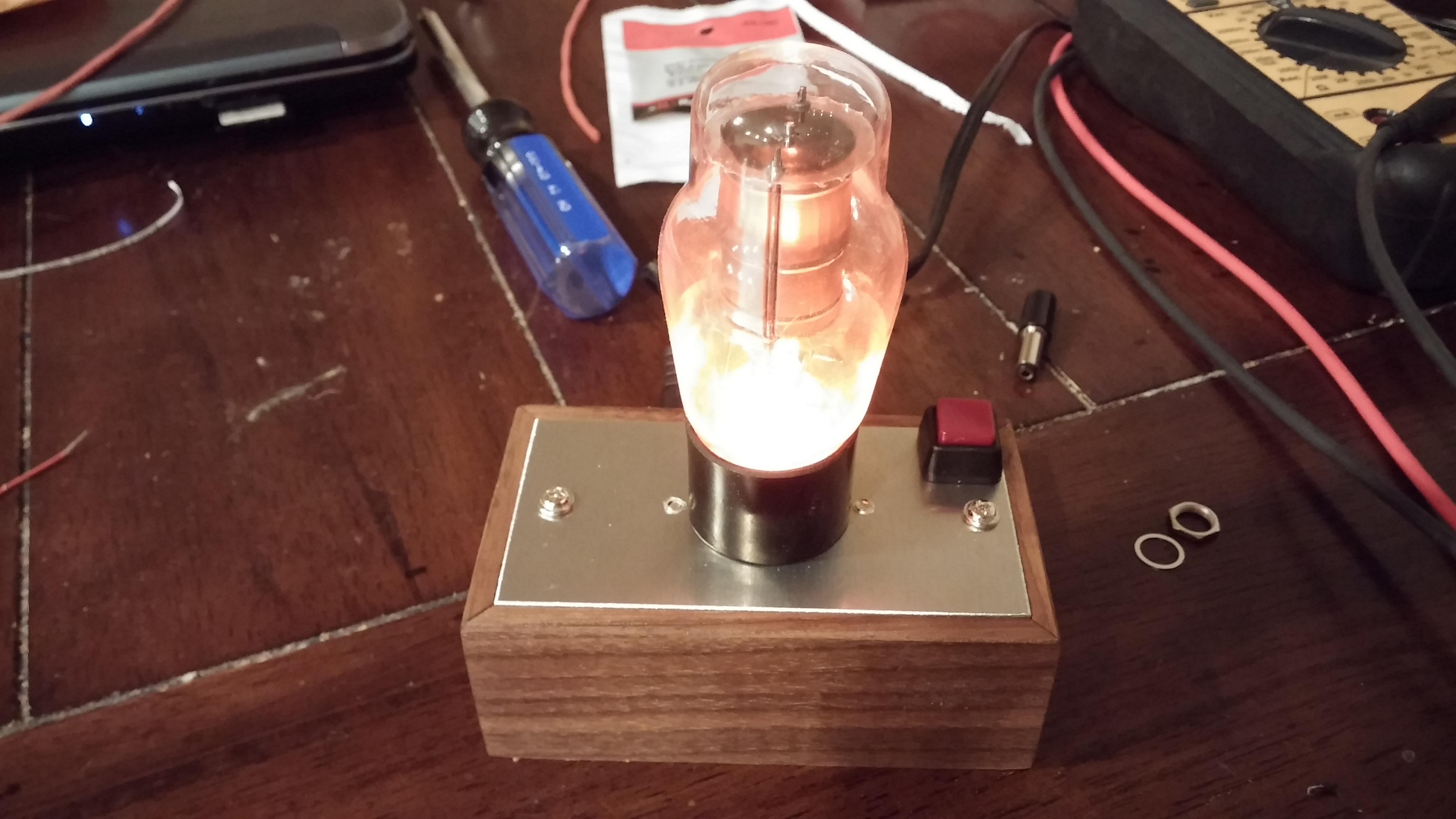

Here are the most recent ones.
The KT66 was for my daughter and she wanted a white light.
The one with 2 tubes is actually USB powered and the guy keeps it on his desk at work.

On the Octal sockets I will grab the locator pin and snap it off being careful not to break the tail end of the envelope that is inside it.
Even if that happens it's no biggie, you just need to shake the tube until all the bits of glass come out.
Then you can use 2 of the unused pins on the socket to solder the legs to and just point the LED through the tail end of the tube.
It is important to find an LED with a narrower angle, 30 degrees or so works well.
