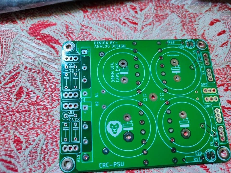

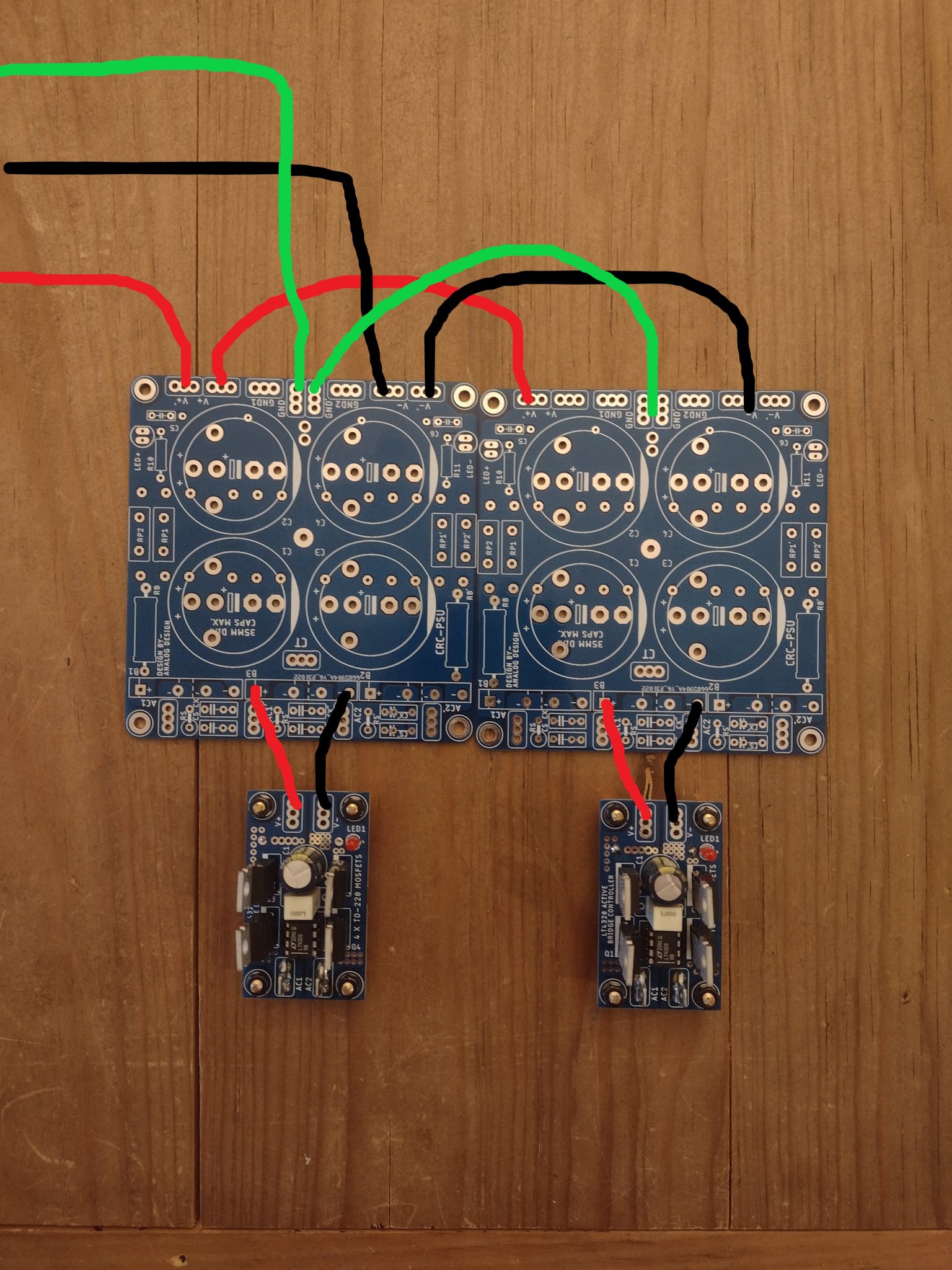

After studying the stores universal psu, I think I see what I need todo. Not dumping the output of one board into the other. So still crc just with more c.

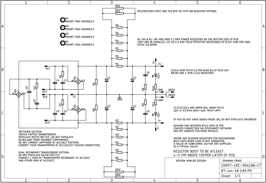

The correct way of joining two capacitors is to use a resistor or much better, an inductor between them.Is this the proper way or should there be a resistor between the two C'S?
