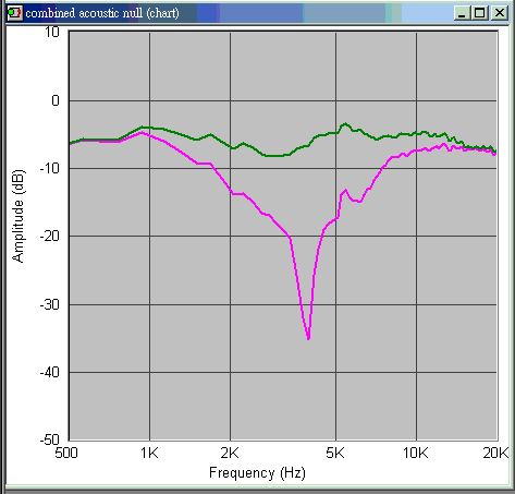

How to interpret reverse null?
I do pay attention to the reverse null and try to get them as deep as possible, however, I concentrate 99% of my efforts on getting phase response as smooth as possible. It's when the phase is smooth that the sound opens up allowing more insight into the studio/venue etc. Poor phase control can make the sound vague and lacking depth.

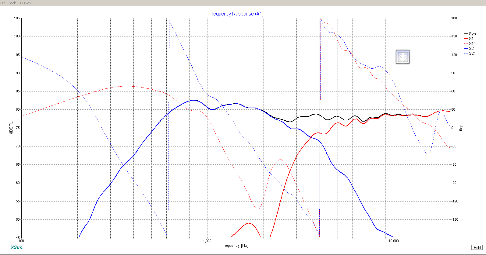

Here's some response curves from my SEAS L18 / Morel EM1308 / SEAS 22TAF/G.
My first attempt at this speaker was to design a crossover with textbook roll off curves - LR4 for the bass/mid and LR2 for the mid/treble. It measured well but somehow the sound didn't gel. It was flat and colouration free, but that feeling of being in the room with the performers was missing.
My final design lead to the images below. I abandoned the textbook slopes in favour of producing a speaker that put me in touch with the music. I can now tell where the studio walls are! It has depth, ambience, separation, excitement and rythm - all the things the early version lacked.

Can you please post the response curves as
remove the System curve freq resp and phase
add the phase to s1 s2 and s3 and post it.. I want to see how the phases are gel in your speaker. Overall they look quite interesting.
schematic would also be great help.
The main advantage is that the levels across the crossover region will change smoothly as you move around the speaker, avoiding any weird lobing effects.
Also helps the two drivers add more smoothly together. :)
Deep null just tells you that drivers in phase at that observation point
However, this doesn't guarantee good off axis. Actually, it could be quite the opposite. It depends on the off axis behaviour of the 2 drivers.
