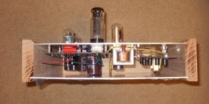

PCB's, Sand mix well with Glass. It must be done with cross coupling and parasitics in mind on all traces, just like wire routing in a P-P. Heat management / dissipation must be involved in the design and implementation into a chassis. You can do etch in a ziploc bag, toner transfer etch resist. All PCB's were done this way. For feed thoughts I used Brass eyelets, wire attach points and to mount caps to the back side.
I've seen bad PCB designs and bad P-P wiring, Good PCB's and P-P designs just take longer and more effort in the planning stage.
