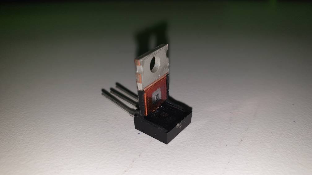

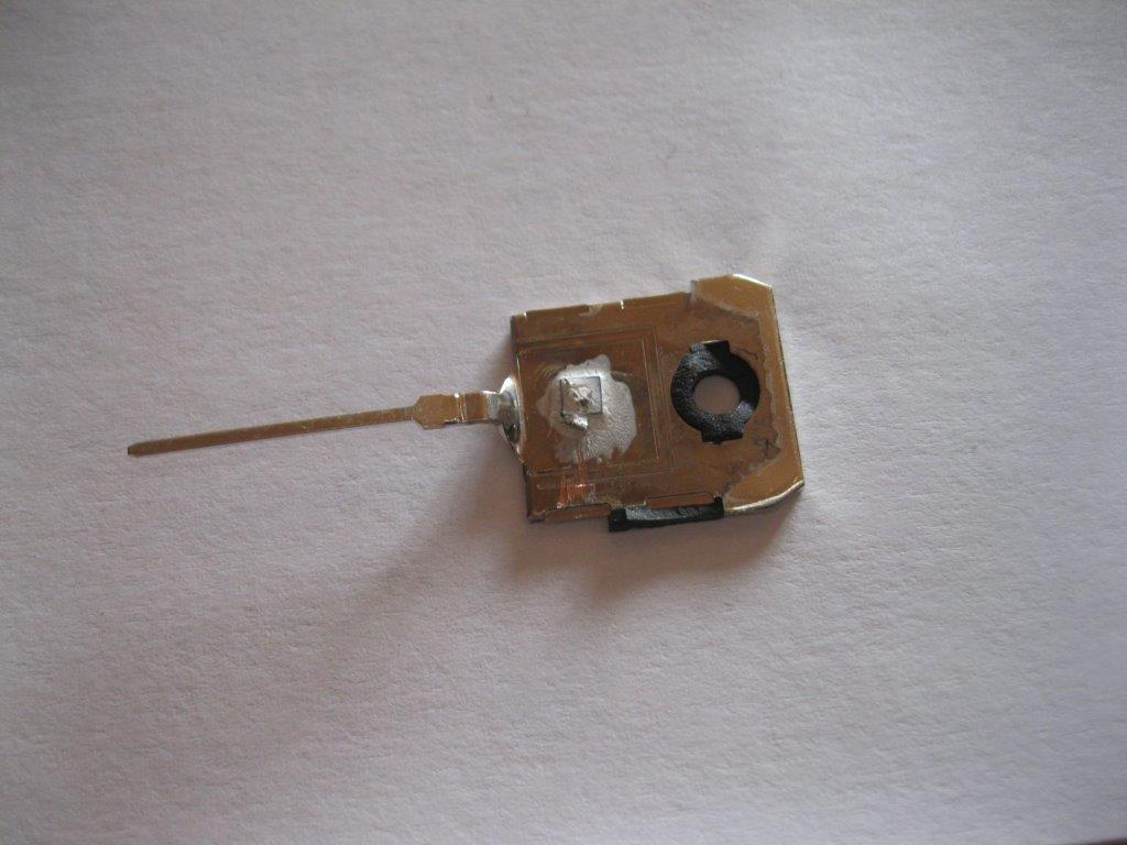

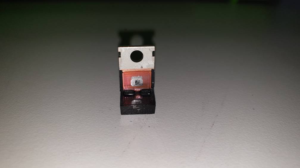

I bougth these at ebay, popped one open and saw silicone.
got my money back ..

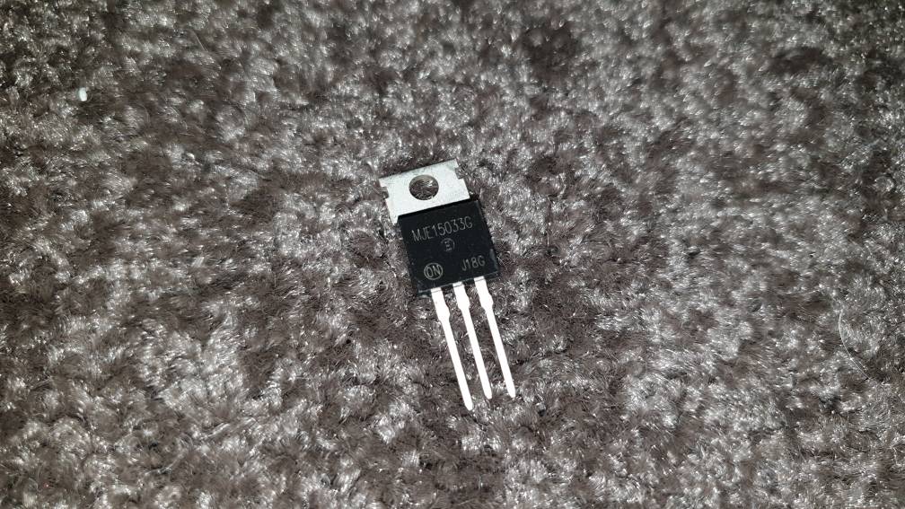

Look absolutely nothing like the ones I got from newark in 2012. Those you had to use a 20 W lamp to even see the writing. No notch on the heat tab, either.

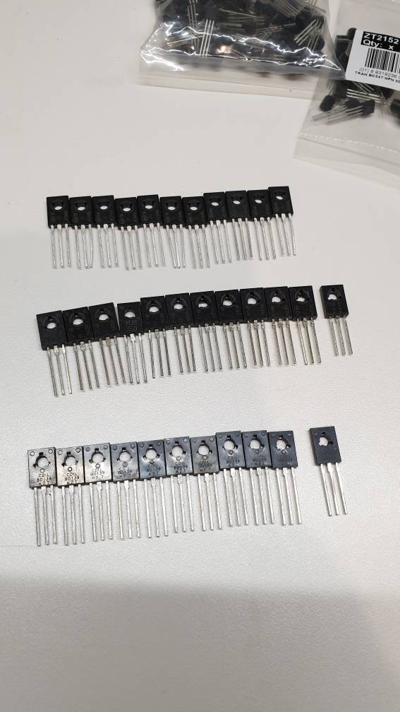

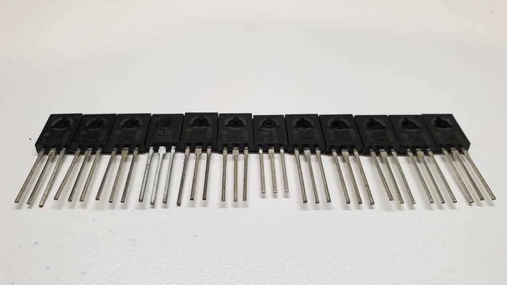

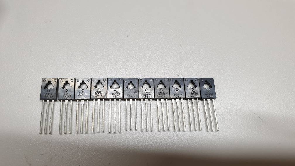

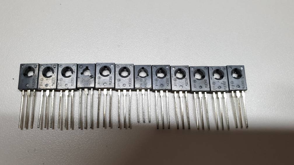

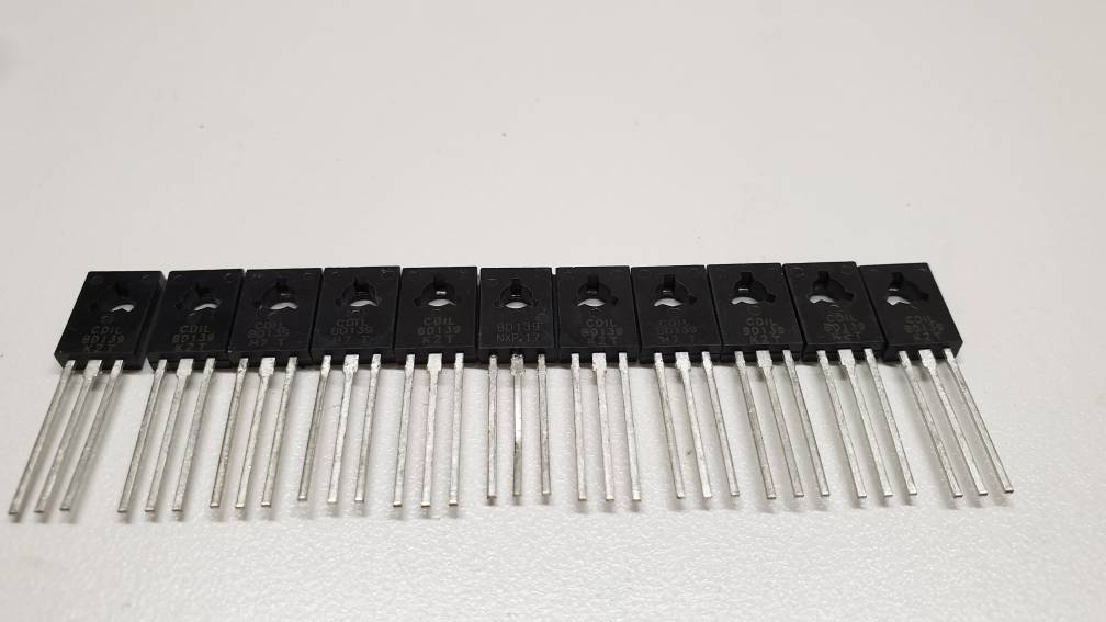

Bought some more bits yesterday at my local store. Was surprised to see that had them available. I have a variety of digikey transistors arriving today and tomorrow to further compare.

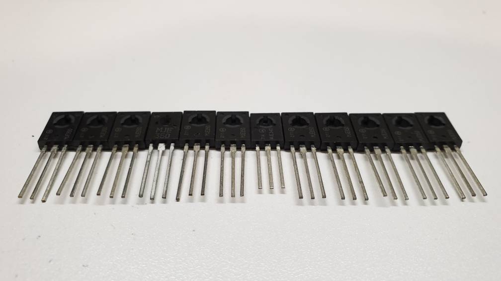

The shorter leads are the aliexpress variant. Also found some interesting finds at my local store. I reckon someone might have done some swapsies. 20190721_201349.jpg 20190721_201336(0).jpg 20190721_201336.jpg 20190721_201212.jpg 20190721_201230.jpg 20190721_201047.jpg

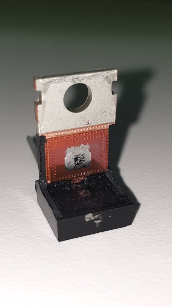

The only ways to tell a fake is take the lid off and check size of die.
Or do a full SOA test of the transistor and see if it survives.
I have a transistor tester that does breakdown voltage which is a good indicator.

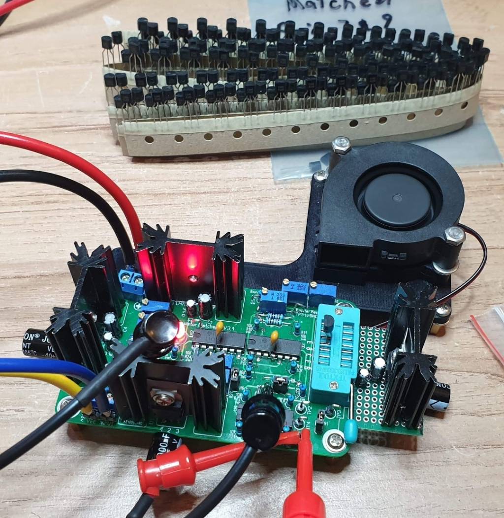

Visuals can help you if it´s VERY poorly made, but it´s easy to make a legit looking one.
Personally since I commercially manufacture Guitar amps it´s worth for me to do a real world test.
meaning:
* I check breakdown voltage. Surprisingly, don´t know why, many fakes meet and surpass that; so I guess it´s an easy to reach goal even for fakers, so by itself does not tell me much.
Of course, if it does not even meet that ......
* Hfe at rated current.
Now that is harder to meet.
IF datasheet states, say, Hfe 40 at 4A, I build a simple jig to test that.
Nothing more complicated than a couple resistors, a 12V 4A supply and , of course, a multimeter.
*most significant and impossible to meet unless fake is as good as original, is a second breakdown test.
