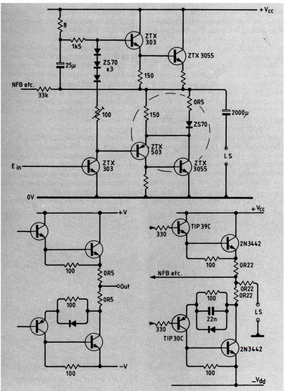

Well, Its a heavily modified version of the schematic for a single Naim NAP250 amplifier board. The original has been in circulation for many years and is accepted as a classic Quasi-comp. design - replete with Baxandall diode. The original draft is somewhat easier to follow:
................................The quasi without a "baxandall diode" is just bad sounding, full stop.
The diode makes the bias loop much more symmetrical...........
The "network" of components on the PNP driver's emitter came from three different amplifier Designers in the 1960-1970s.
Shaw suggested the addition of the resistor to improve the quasi complementary performance.
Baxandall introduced the diode and kept Shaw's resistor. This implies that Baxandall agreed that the resistor introduced by Shaw was a good modification.
Finally Hood added the capacitor to the Shaw resistor and the Baxandall diode. (again confirming that he too thought the two previous improvements were correct).
We end up with the Shaw/Baxandall/Hood network of R/D/C loading up the lower driver's emitter.
I note that the post27 sch of the NAP circuit omits the Hood capacitor.
I would like to see our sim experts comparing simulator predictions for each of the Shaw, Baxandall and Hood improvements.
Shaw-PJB-JLLH mod
Shaw suggested the addition of the resistor to improve the quasi complementary performance. . .
... I would like to see our sim experts comparing simulator predictions for each of the Shaw, Baxandall and Hood improvements.
There is a minor correction to the above statement:
Shaw suggested the addition of a diode in the collector circuit. (Top pic)
PJB suggested moving the diode to the emitter of the driver and put a resister in parallel. (Bottom left)
JLLH added a capacitor in parallel to Diode and cap. (Bottom right)

Quasi means acts as if.
So quasi complimentary means the NPN's act as if they were complimentary.
I think that is a good definition.
You can draw a box around the top darlington and the bottom sziklai and then the boxes can be seen as 'devices' which act as complements to each other, although the output devices in both boxes are the same (NPN usually).

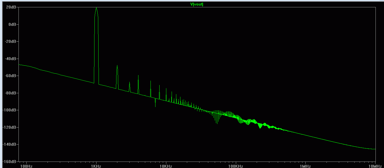

Yes, a quasi has asymmetrical topology and therefore produces asymmetric distortion, that is, even order. End of argument, that is the truth. Here is the FFT for the quasi at 1KHz into 8R using good models from Cordell. This is around 0.046%, and about 95.2% of this THD is H2, which is at 67dB below.
HD
