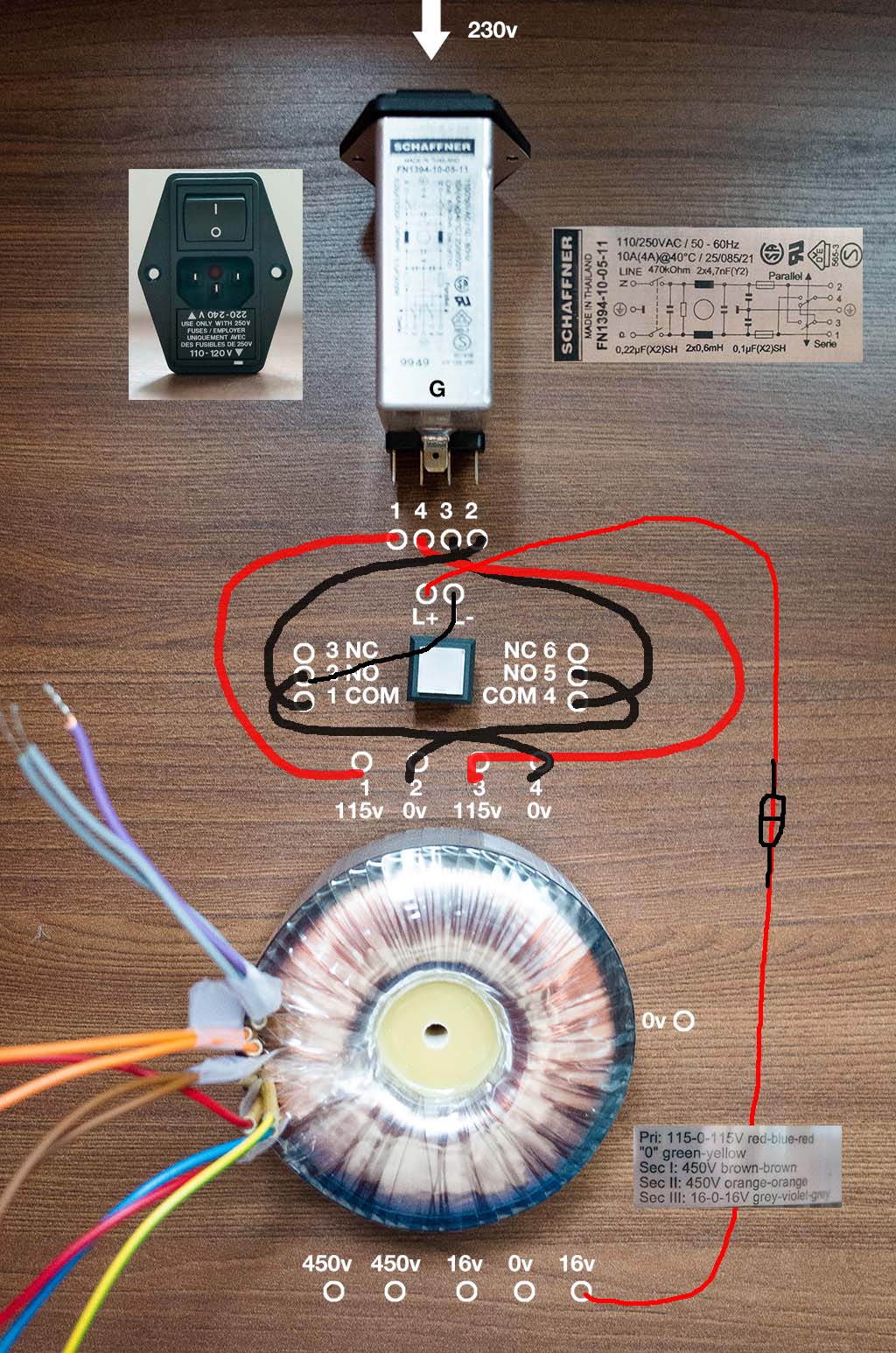

Confirmed, the 115-0-115 transformer is a single primary for 240v usage only, e.g. 115 to P, 0 to ground, 115 - N. I need to order a different one (115-0, 115-0) for dual voltage duties.
I've added the LED wire into the circuit too. Does the neutral wire look ok? I traced it back to the neutral lug.
