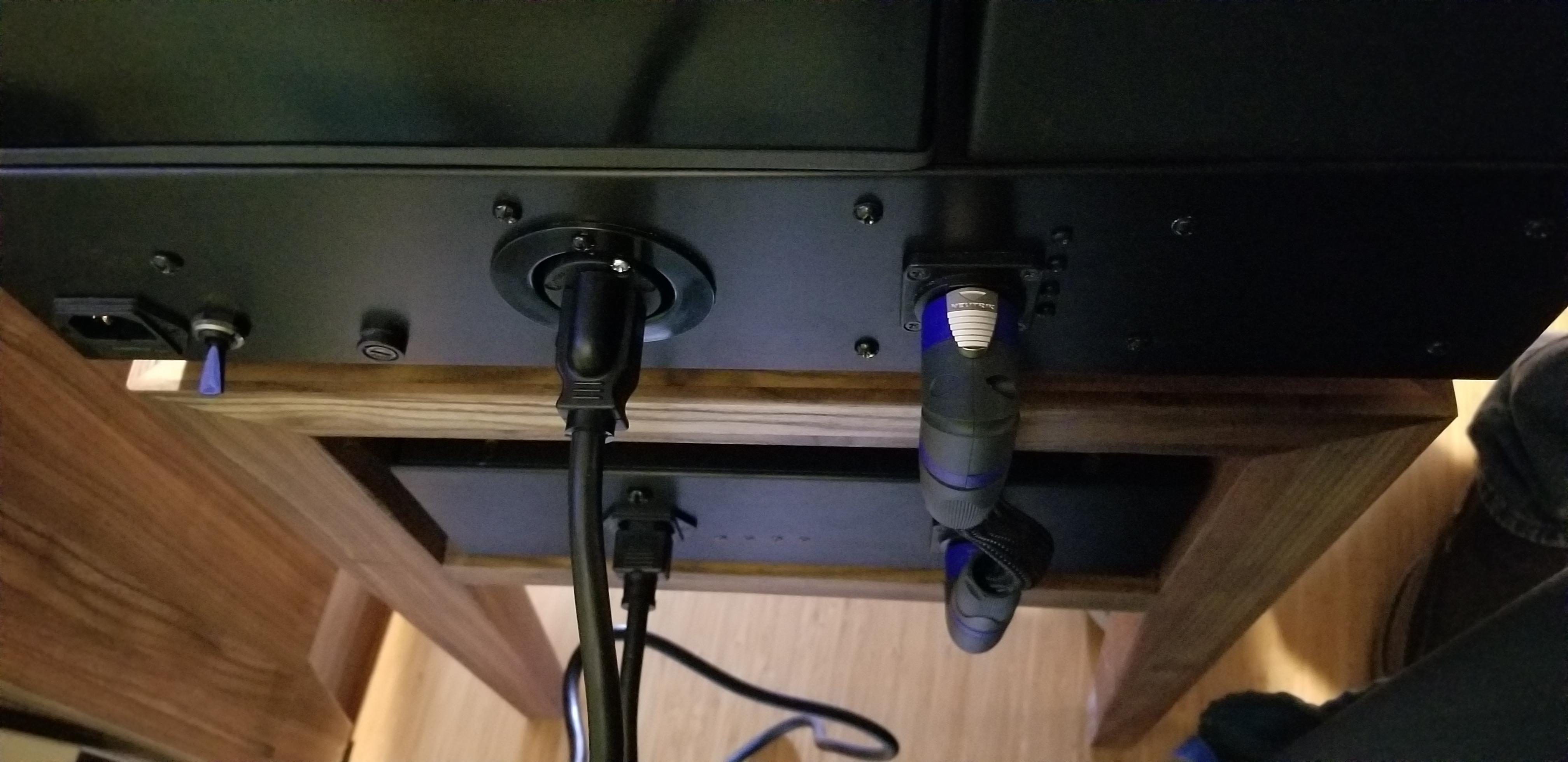

For my preamp/DAC I use the separate PS and signal chassis scheme, safety ground the PS, and connect the two chassis through the 8 pole DC umbilical. All signal grounds are in the signal chassis.
For my mono amps I have AC going into the amps with soft start circuits for HT and 833C filament and 6E5P heater supplies. I then run the 833C filament and 6E5P heater supply AC back out to a separate filament PS chassis using a standard 3-prong cable with the safety ground wire connecting the two chassis. The filament and heater DC then return to the amps via a 4-pole speakon. Dead quiet.
Picture of the amp connections attached. I've since made a shorter AC cord to connect the two chassis.
In the picture above, the mains AC comes into the IEC outlet on the far left. The paddle switch next to the IEC turns on the filament, heater and 833 bias circuits, and the filament and heater AC then go out the AC connector on the back of the amps to the filament/heater chassis and the DC returns via the Speakon. All signal grounnds are in the main amp chassis, as are the filament and heater grounds.
The main 833C HT (2300V) is activated via a pushbutton on the front panel, after the filaments have warmed up.

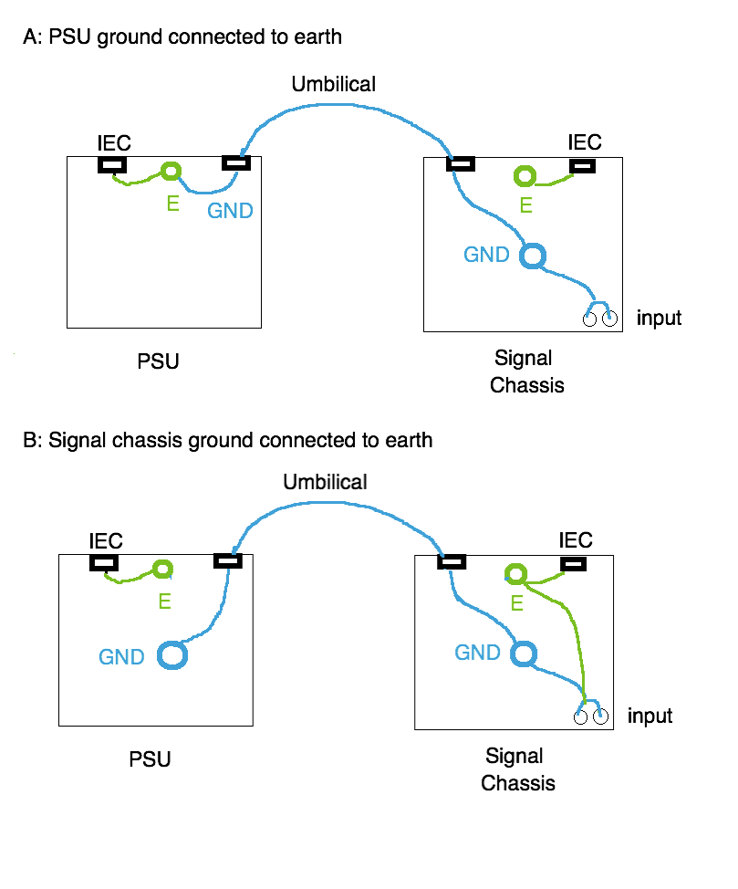

Thanks Magz and Rongon, your comments are very helpful. I'm going to try out this:
- HT in separate chassis
- filament supplies and signal all in one chassis
So in the signal chassis the mains earth is connected to the chassis. The filament supplies are floating. The output filament supplies get grounded through the cathode resistor. The IDHT input DC will be grounded at a single star ground which also serves all the signal grounds.
Hope the above works. It's my preferred solution weight-wise. I'd like to separate the HT supply since it's heavy because of the mains transformer and choke(s).

Question: I've rewired my 6B4G amp as above. In the signal chassis there's no connection between chassis ground which is connected to mains earth and signal ground which comes from the PSU. Is this correct or should I think of connecting the two via come combination of resistor, diode, cap etc?
The way I've done it is
- Mains safety ground is a wire from mains plug earth wire straight to PSU chassis at the IEC socket. That's solely for safely grounding the chassis in case of short circuit. It shouldn't have any direct connection to 0V signal ground.
- 0V (signal ground) is connected to signal chassis at the audio inputs.
- Ground wire in umbilical connects 0V of signal chassis to 0V of PSU chassis.
That means that if you power up the PSU without the signal chassis connected, its 0V ground is floating.
I think that possibility of a floating ground with the PSU disconnected from the signal unit is a danger we have to accept. Perhaps put a bleeder resistor in the PSU to protect from that condition? (I'm not sure...)

Not sure I like the idea of the PSU ground not being earthed. But in terms of hum I don't like the fact that in the signal chassis there's no connection between the chassis and signal ground, though the chassis is earthed. Like you, I just don't know. I hope somebody does!!
Sorry, I think I didn't describe what I was thinking very clearly.
The 0V signal ground should be connected to chassis at the audio input jacks.
It's the AC safety ground that's not connected directly to the audio signal chassis. However, yet another separate wire in the umbilical could connect the two chassis together.
I like to consider the two chassis as effectively ONE chassis with PS and signal components separated by some distance. As long as the two boxes are solidly connected to each other with a large enough gauge wire, that is true. In my preamp I achieve this through the DC umbilical. In my amps I achieve this through the safety earth wire of the AC cable between the boxes.
Also, why have a separate mains connection in each box? You can just connect one box to mains and connect the two boxes together in one of the two ways described above so they are both safety earthed.
Strictly speaking, the AC safety earth connection should be bolted directly to the chassis with a double nut to prevent loosening, and nothing else should be connected to that earth connection.
I need the mains connection in the signal chassis for the transformers feeding the filaments. If the filament supplies were in the PSU chassis then the signal chassis would only need the umbilical as you say. But then it would be necessary to run more cables from the PSU to the signal chassis. If only the HT is in the PSU chassis it eliminates the extra cables.

Yes !! And here's what I'm doing: 😀
I have a PSU / signal chassis split as well. (EL84PP)
PSU chassis generates B+, heater supply, and bias voltage.
PE is going directly to PSU chassis at the IEC inlet.
I then bring seven wires in an umbilical to the signal chassis:
- B+ and 0V return
- heater and return
- bias and return
- PE (the thickest wire in my bundle)
In my signal chassis,
- PE is wired directly to chassis
- 0V line of B+ is wired to chassis through a CL60 (10R cold resistance)
- heater is referenced to B+ / gnd as necessary
- bias is referenced to B+ / gnd as necessary
This way, I can use the PSU for different amps (signal chassis), as all referencing of the voltages from the PSU is done in the signal chassis.
If I recall correctly, I may have connected B+ gnd to the PSU chassis through another CL60 as well to not have HV floating around when the umbilical might be unconnected.
CL60 acts as effective hum breaker, but can transfer enough current in case of short to trip the mains fuse.
Regards, Claas
