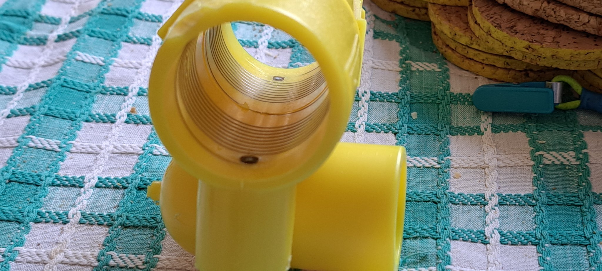

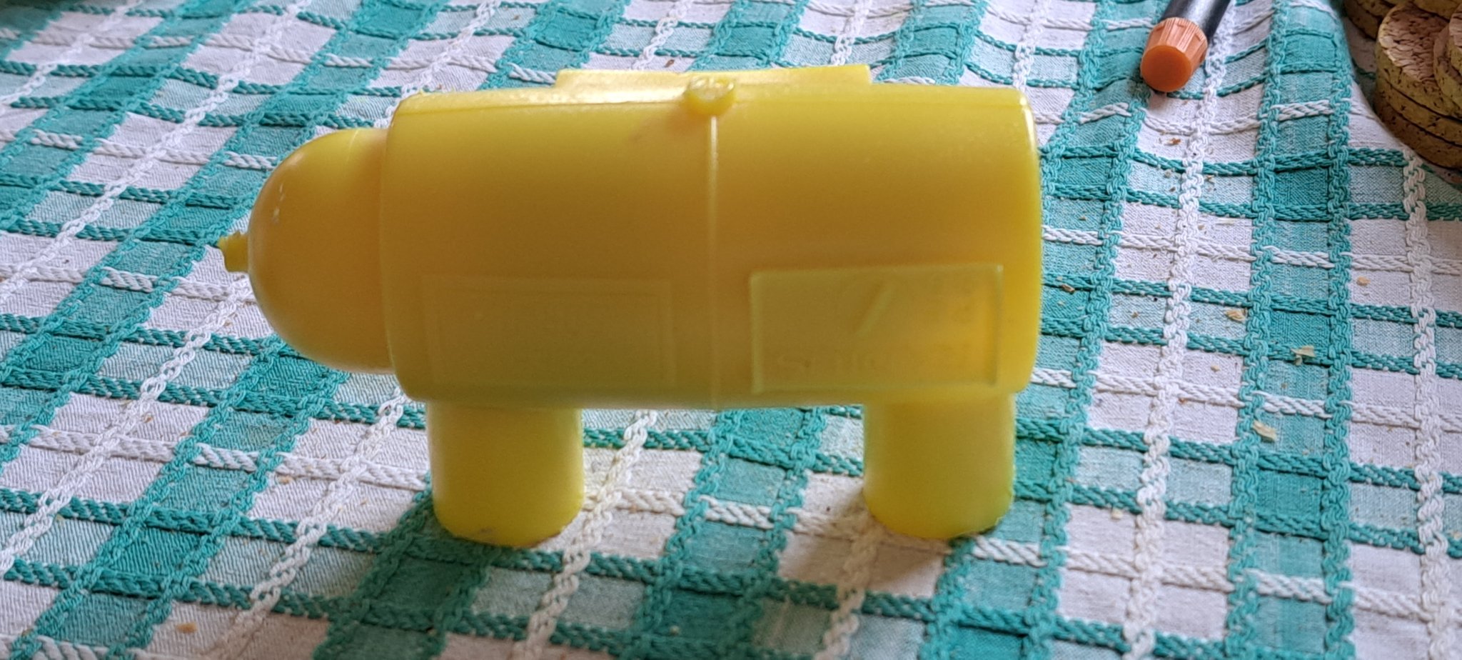

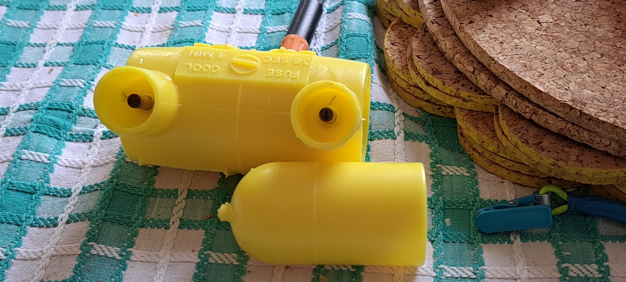

How to glue your gas pipes without glue...
Was out for a walk and found this left behind after some roadwork by the local energy company.
When I'd got it home I realised what was going on and thought it was pretty cool.
Or hot, unless you leave it a minute to cool...

A ring heater is the normal way to join HDPE gas pipes, it is one of the really difficult materials to glue.
Or sometimes a 'mirror' is used, again a type of heater.
Can't take chances with gas.
That goes for other HDPE, LDPE, PP and many Nylon grades as well.
Even for printing, you have to prepare the surface using high voltage discharge, flame, hot air and other methods, sometimes the effect is temporary, the printing has to be done within minutes, or the ink will not ahere.
