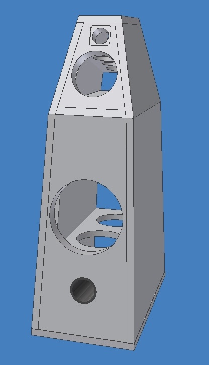

One other thing that helps speakers to sound more open is to use the biggest cabinet that you can that still has good group delay properties.
For instance, say you have decided that your wife will only accept a 2 cubic foot cabinet. Then instead of stuffing a bunch of drivers into it try creating an ideal alignment for a 6 or 8 inch driver.
Here is an example of a modest sized three way floor standing cabinet that I worked up some time ago. About 34 inches tall it was designed for an 5 inch midrange and an 8 inch woofer in about 1.5 cubic feet. The idea was for bass reflex tuning of the woofer and aperiodic of the midrange but you could use aperiodic on the woofer also. I think you could build something like this and leave the upper cabinet open back and experiment with different damping materials on the walls and different filling until you found the optimum configuration. Also, for a closed box speaker I can't emphasis enough how important the cabinet construction quality is to get that more open sound.
