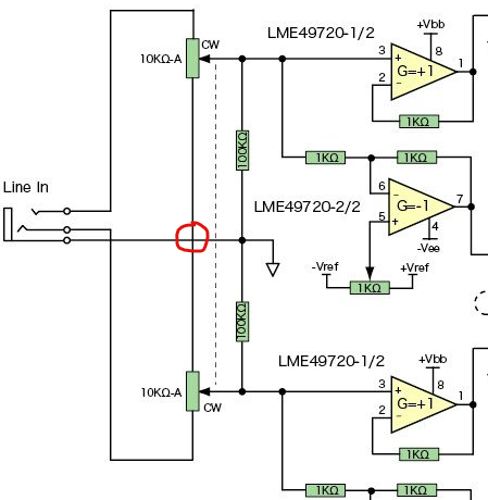

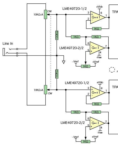

How to make a correct connection of single ended inputs to TPA6120 schematics in startpost of this topic ? I want to make dual input balanced + unbalanced amp. DRV134 or something else ?
upd, I've found another variant of input stage, but anyway the question is how to properly match it with differential input ?
Hi, it's clear to me, but the question is how to make dual input for that amplifier. For ex how to add correctly this input stage to your amp. I don't need any switches, just want to left one of inputs unconnected while using another.but is is basically 2x the same circuit
I do not understand what do you want. You want 2 different balanced signal source connected to the input and use either A or B source? Or, you want both in the same time, so mix it? Either way, if you leave both connected, you will mix. I do not know how to do with balanced signals. The circuit section you linked I do not understand. I see it makes balanced signal from unbalanced, but as I see that adds some amount of crosstalk ?? What is that pot? If there would be a dot here:

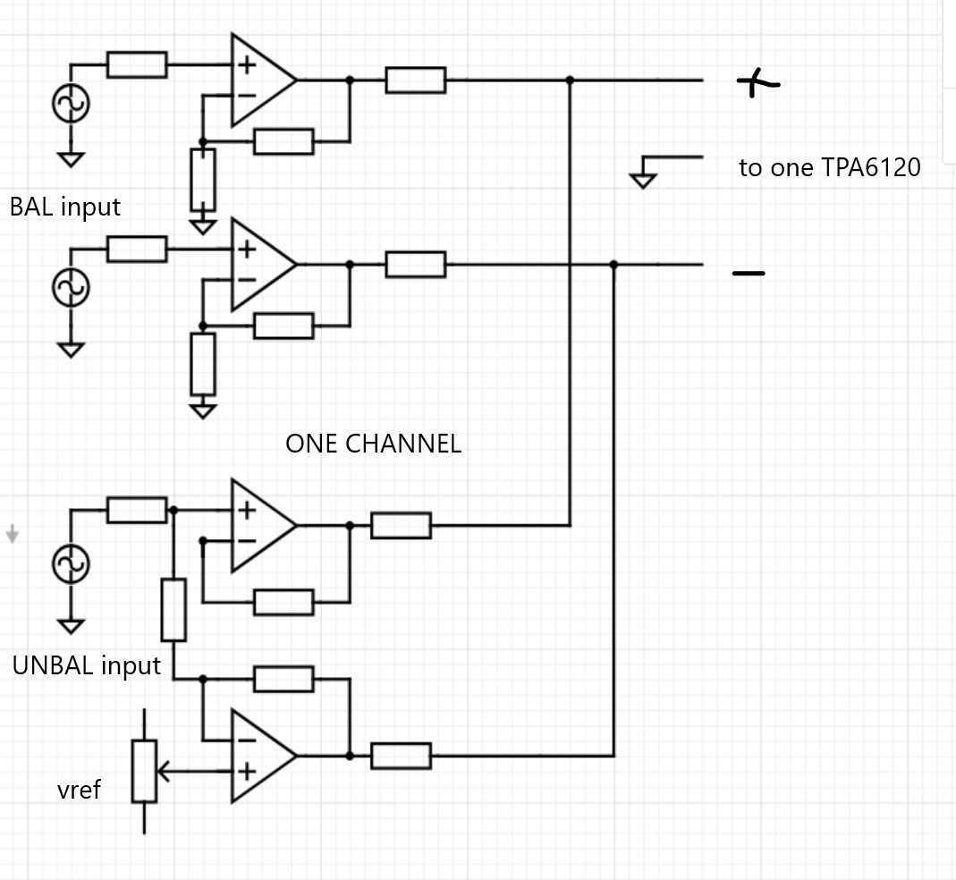

So, if you want to mix two inputs, you could do easy on unbalanced side. You add a buffer on each input and a series resistor on each opamp output before you connect them together. I guess you can do that with balanced signals also, but someone else should answer that, I have no experience mixing balanced signals. Than, after connecting the input buffers together you can connect to your unbalanced to balanced circuit. On the other hand, if you do not need both in the same time, I would suggest to consider a switch. You add less opamps and you are not listening to the noise of both inputs.
If it is the balanced signal input what you mean dual input, than your circuit should work. but if you search for "line level unbalanced to balanced circuit", you will find more. Or, you could use an interstage transformer with middle tap. If my signal source would be unbalanced and I would really want to make a balanced headphone amp, I would look here for potential candidates: https://www.lundahltransformers.com/input-and-dc-free-line-output-application/
I did not use any on my balanced amp, because the signal source I've used is balanced (TC Electronic Konnekt 8). ... and even for that, I've dropped the TPA and other solid stage amps and use OTL headphone amp (unbalanced naturally).

I want to have both inputs (differential and single ended) with differential amplifier.You want 2 different balanced signal source connected to the input and use either A or B source?
Should I do something like this (picture only for one channel) ?You add a buffer on each input and a series resistor on each opamp output before you connect them together
