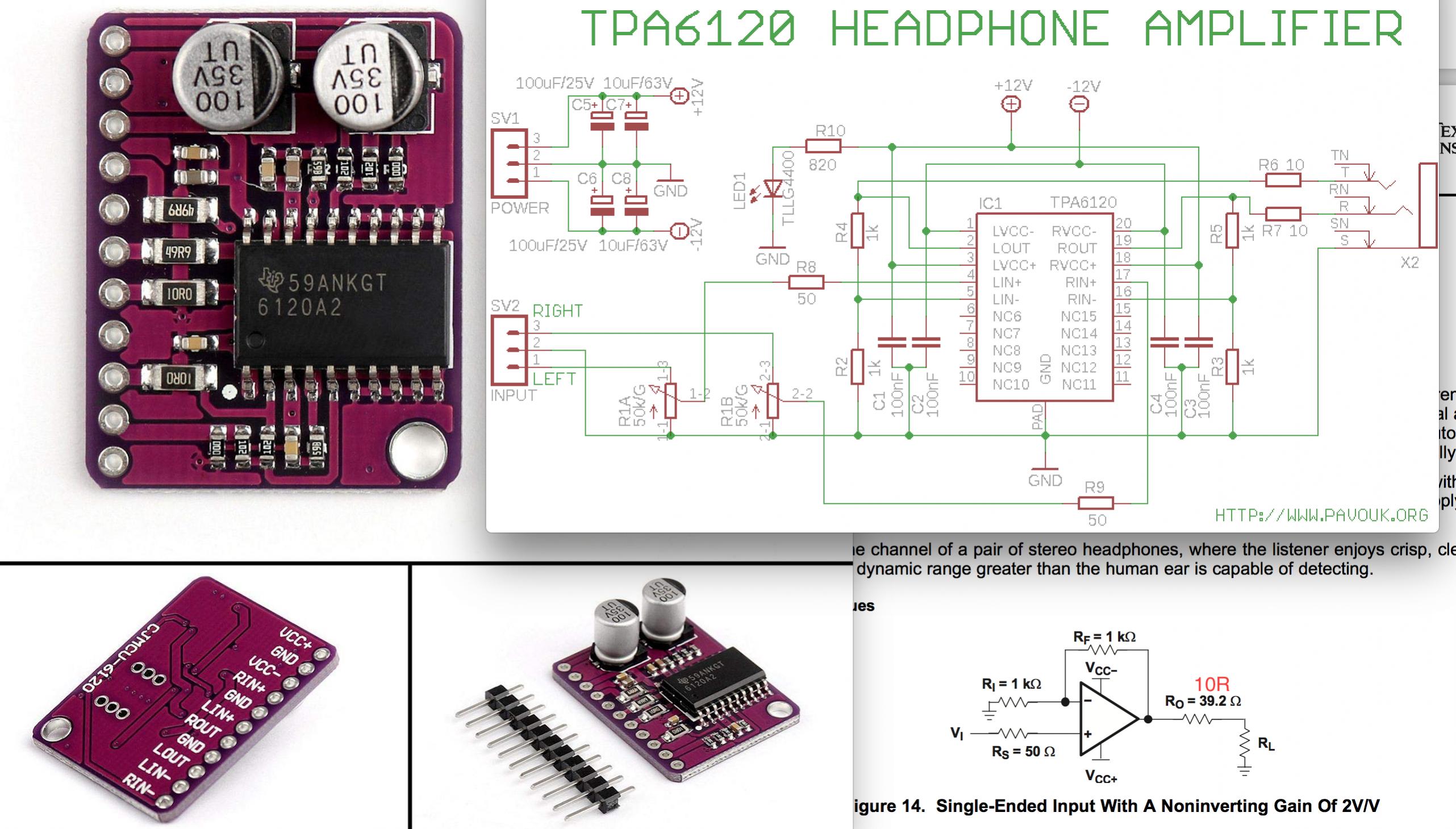

I bought a couple of these Chinese boards with Pavouk's layout to try, but still haven't gotten around to connecting them (sidetracked by O2 and ACP+ preamp). Plan to run one on +/-12V (maybe using Murata SR7812) and one on +/-15V using cheap TPS7A type vregs.
If you poke around there are a couple of versions using TPA6120 plus an input buffer....
But yes, at least you are on the right track about the PS being critical, and generally very expensive (10:1) relative to the actual audio circuit.

Read the Datasheets of TPA6120A2 and THS6012. They are high-speed current feedback amplifiers and the feedback resistance value plays a role in setting their bandwidth (incorrect values can cause peaking and other trouble). If you check the datasheets, the reasonable range of feedback resistor values starts somewhere around 750 or 820 Ohms with 1kOhm being the general recommendation from application examples if I remember correctly. The THS6012 datasheet is more detailed in some aspects, although the TPA6120A2 datasheet has at least one graph regarding this as well. I also don't know if the devices are 100% identical or if they have any slight differences in internal compensation.

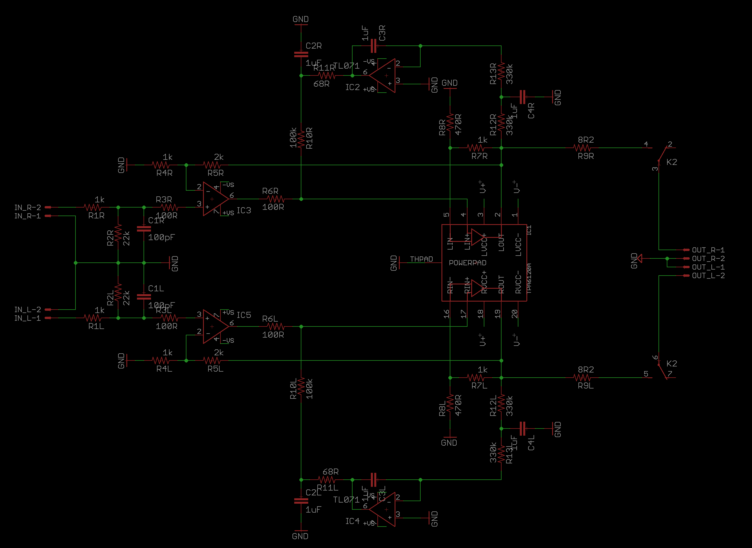

I also might add that what Andersonix described as an Input buffer might really be the VFA part of a VFA-CFA Composite amplifier. This is probably also the way to get the most out of this chip, BUT I would strongly suggest you only follow this approach if you have access to a reasonably fast scope so you can check for oscillation. Look at datasheets, evaluation boards as well as other commercial or noncommercial implementations and strive for a compact but clean layout, no matter what approach you end up choosing.
This chip also depends on the power pad being attached to a good amount of copper for power dissipation, and if you have trouble soldering it like that you may want to turn it upside down and attach a heatsink like that instead.

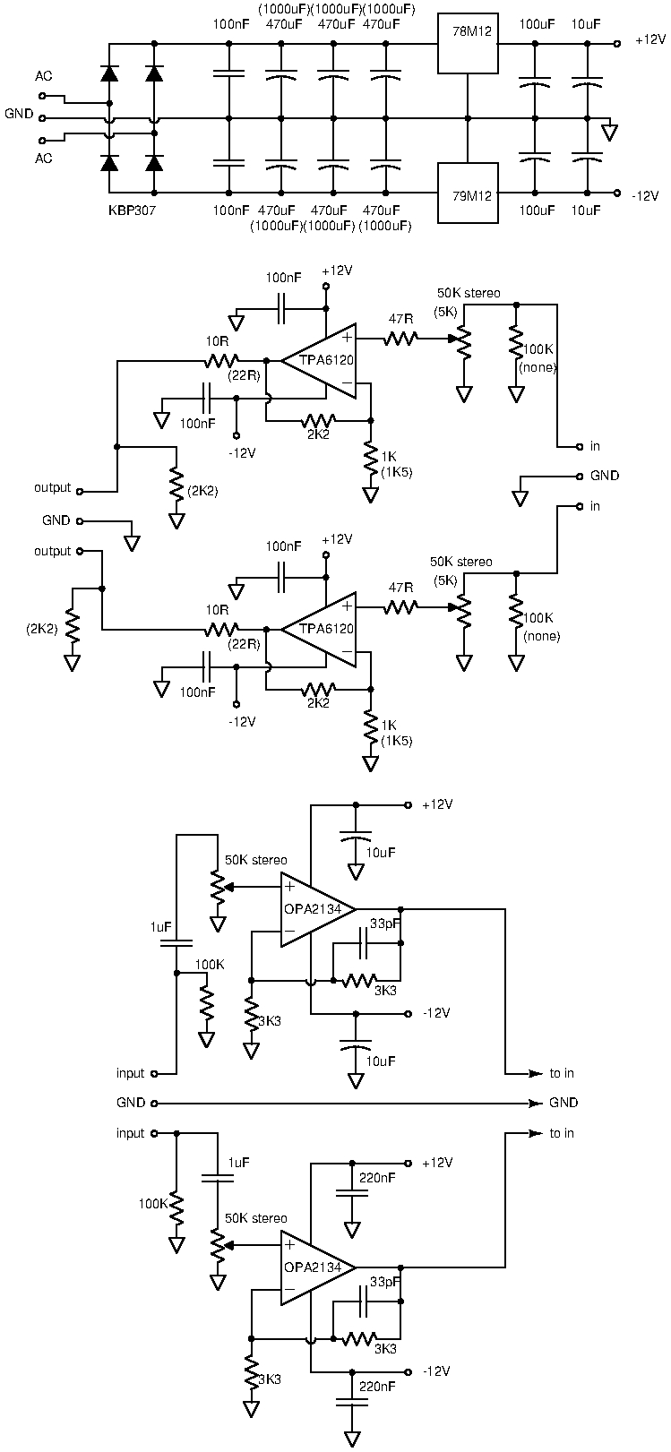

I attached the two schematics using input buffers that I've seen here at Diyaudio.

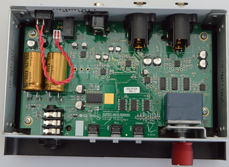

Also attached a photo of the Rubert Neve RNHP which appears to use an input buffer, along with output caps.

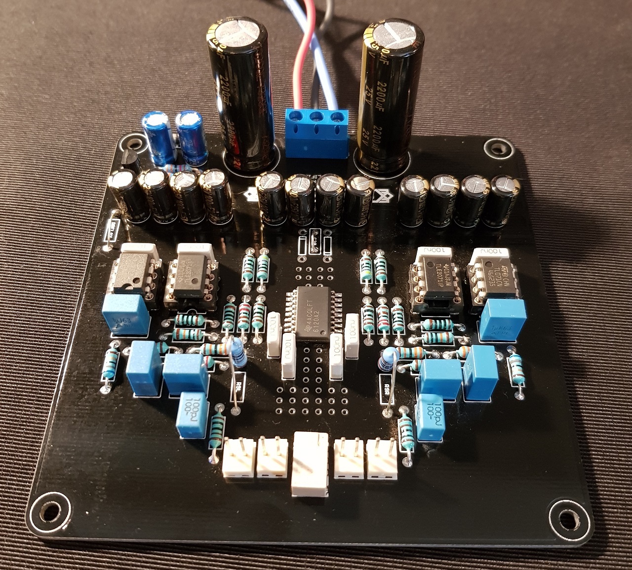

You can take a look at my composite TPA6120A2 headphone amplifier.
High performance OPA1602 + TPA6120A2 Composite Headphone Amplifier

I recognise one of those 😀! That amp is in daily use. Composite TPA6120 with servo HPA
Be sure to pay attention to the layout guidelines in the data sheet, especially the part about not having ground pour under the input pins.

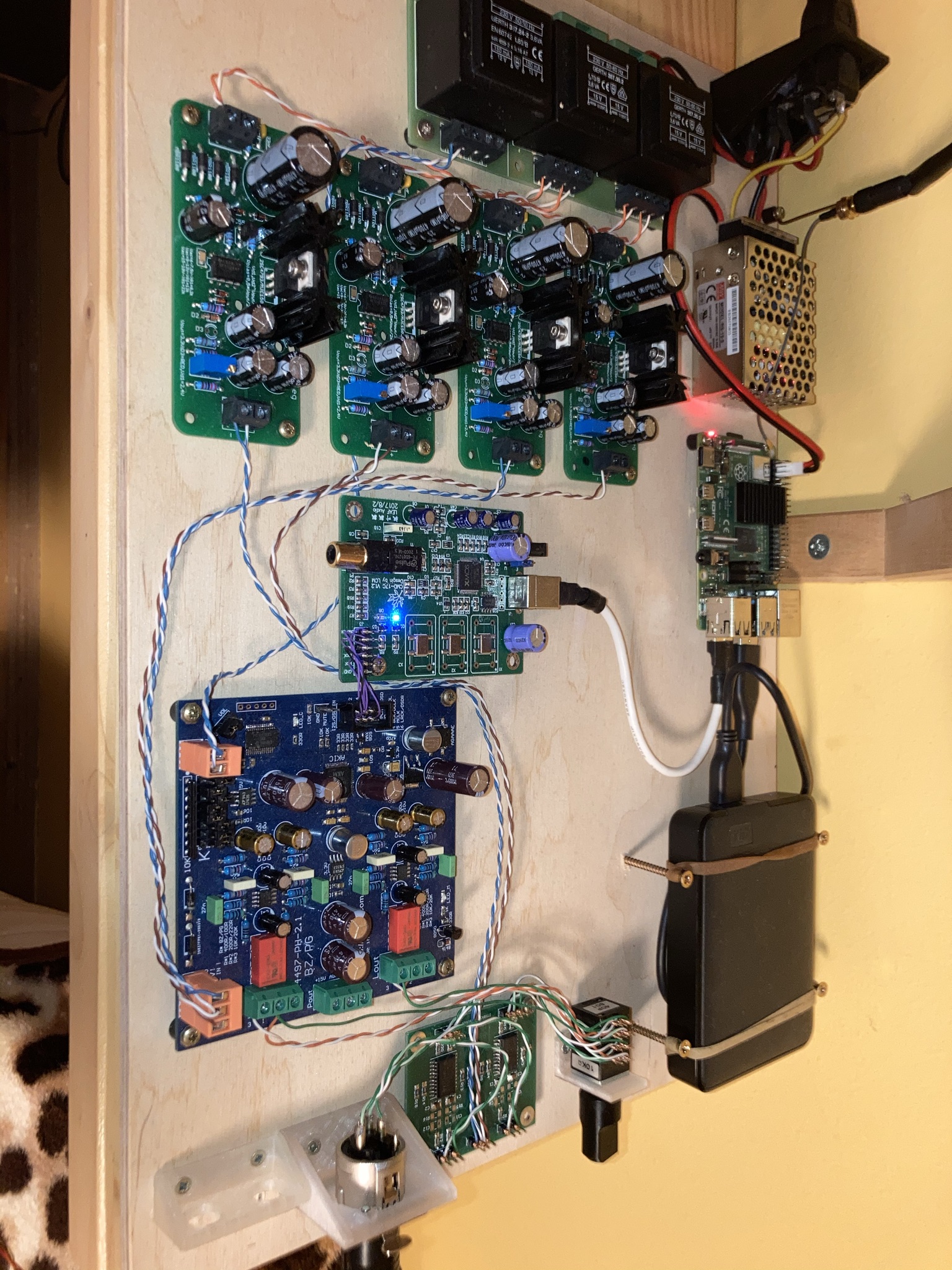

I am listening to a balanced version for a few weeks now and I can say I'm impressed. The source is a cheap Chinese DAC, which is not bad, but I think my AD1865 based DAC is still better. Anyway, after some experiment on the bench, I built it on a piece of wood and listening for it. I think it is either the "superreg" PSUs, which are really good (too bad that I ignored them for years) or the balanced config.
It has a natural, wide soundstage, no problem with top and bottom and the main thing is, while it is detailed, does not make me tired. It is for sure in the direction to a triode SE OTL I built on my firend's design. It is not the same at all, can not really tell which is better, but I feel this is my first solid state headphone amp what I like.

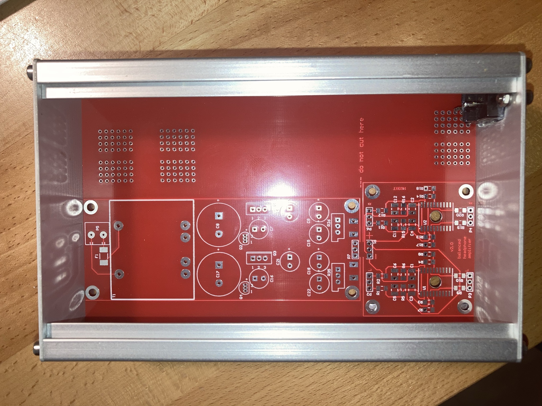

Hello,
I have tried to build a DAC+headphone amp from a Chinese DAC pcb, 4 superreg PSU and a balanced TPA6120 amp. The DAC is bad. But, the headphone amp paired with the superregs became a great success. I really enjoy it. Detailing, but not harsh. Pairs well with my sennheisers.
I'm desigining a more compact version, I include the status here, if you guys have time to review it and has comments, I appreciate that.
