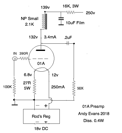

I've been doing several permutations of a 2-stage SE amp recently. Some are with 300b outputs, and some with EL12n outputs. The EL12n amp interests me a lot, since the mu of EL12n is 18, which allows me to use DHTs as drivers. I have so far tried 10Y, 26, 4P1L and 01A. I would dismiss the 4P1L as tonally inferior to the others. The 10Y is excellent and I can happily use it as a solution. The 26 struggles a bit at 7mA current, though the tone is good, on the warm side. The 01A is tantalising - the tonality is very fine, as we know, but at 3.4mA current it's asking for something in the circuit that would give it more drive.
So what are my options here? The aim is to preserve the tonality of the 01A intact but give it better drive into the EL12n outputs. I don't need more gain, just better drive. I'd be very grateful for any and all suggestions here - the tonality of the 01A is too good not to use it. I attach the schematic as it is currently.

Andy, you know I love this valve. However, isn't expected to swing large volts. Depending on your output stage, with the 3mA you could run into slew rate distortion issues.
I'd go for a cathode/source follower at the output. DC-coupled to 01a anode. That's what worked best for me.

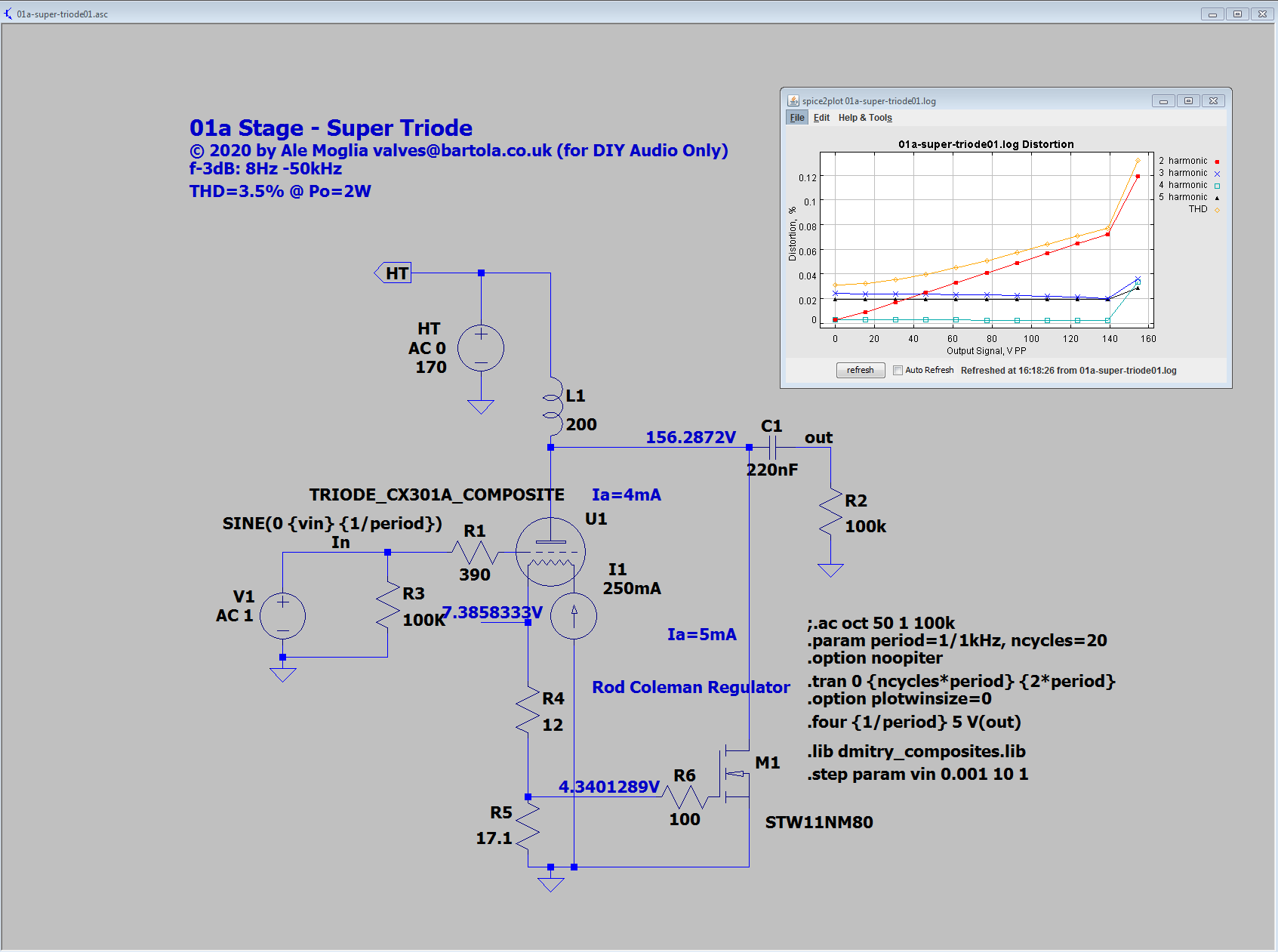

Alternatively, I was thinking on implementing a "super-triode" or assisting the 01a with some silicon. I know you're not a fan, but can keep the sonic signature of the 01a whilst providing current drive. See the attached
Challenge will be to calibrate the circuit on R5 as every MOSFET has wider parameters including VGS(th) and GFS. If you vary R5 by 100mR you can get a big variance on the drain current. Without a servo (or a trimming circuit) it may be hard to implement.
you can see that beyond 100Vpp, you are asking for trouble here with the 01a.
cheers
Ale

Thanks Ale. You're a wizard with solid state, and that's not true in my case as you know, my knowledge base is valves. Before I try a solid state solution (which I could do), how would this compare with using a tube as a cathode follower? Direct coupled as per your suggestion? If so suggestions for what would make a good tube? I've never used cathode followers so would have to look up all the theory, but I have plenty of tubes I could use. I may have one of your boards already - I remember trying something out a few years ago. May be an older version.

A cathode follower is rather more complicated to implement and with poorer performance IMHO compared to a source follower.
I don't think you have my SF boards. I can send you a pair if you need.

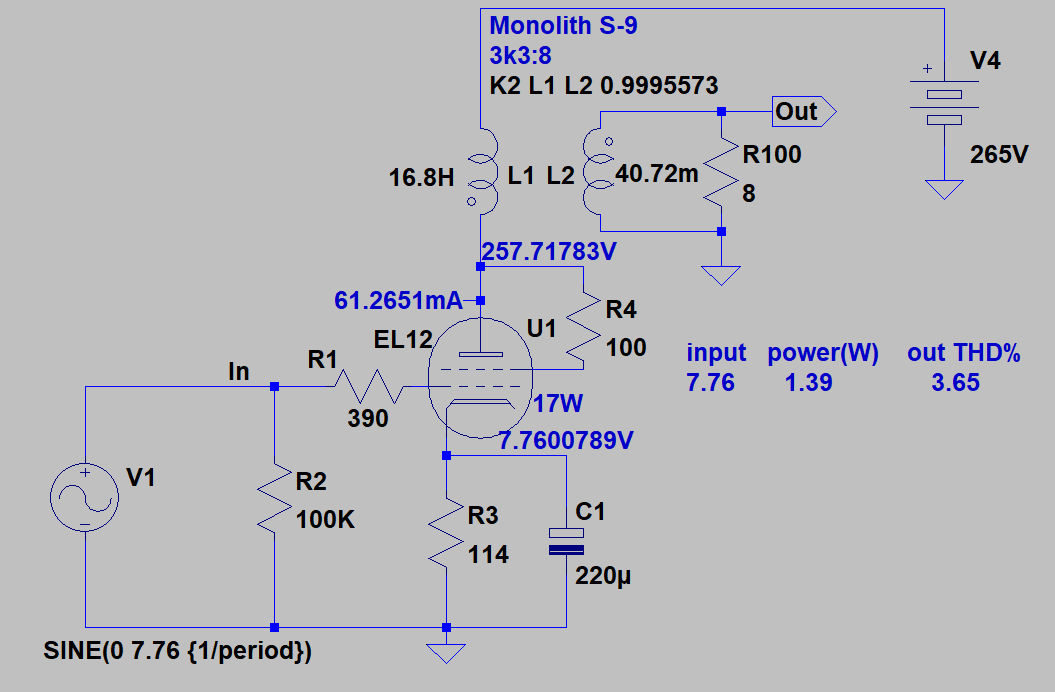

Ale - here's the output stage. Don't know the input capacitance of the EL12n in triode. It's an 18W valve, S=18, Ri=1K approx.

So the 2K plate load isn't going to be too low for a tube with 10K internal resistance? The following parallel grid resistor is only a small part of the input impedance the tube will push into. Why are you looking to increase the drive if 2v gives enough output signal? Looks like you only need a gain of 4 without using FB. What problem are you trying to overcome, exactly?
The plate load is a 136H choke.
The issue appears to be slew rate according to Ale, who knows the 01A tube very well and has worked with it for several years. Would you agree to that?
