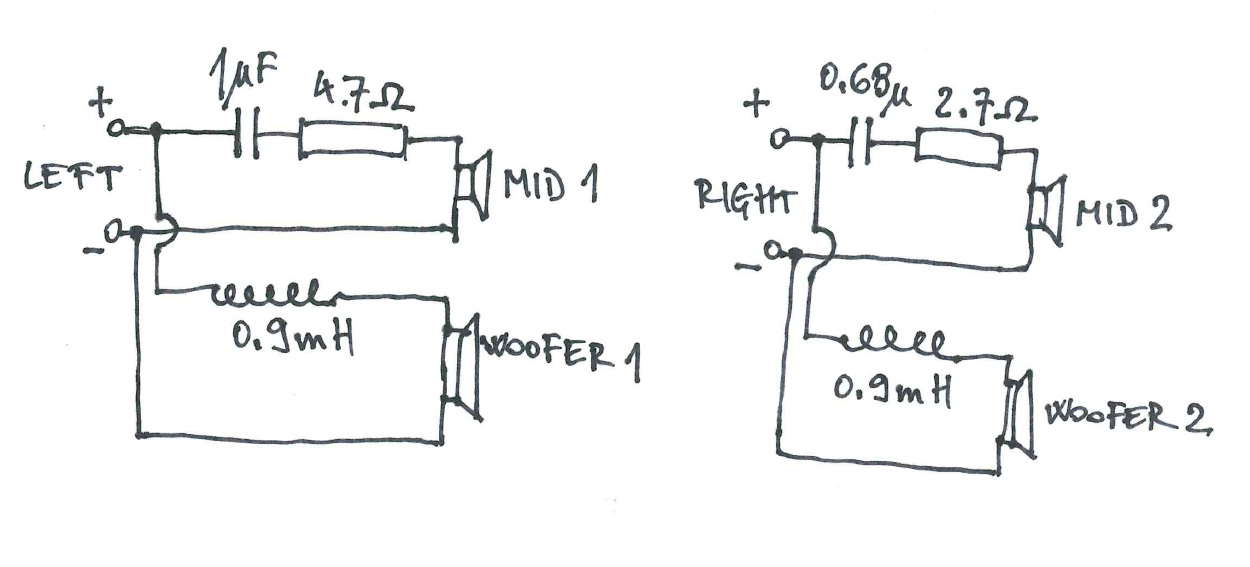

I will attach the photo later but just imagine two mid drivers at the top of the box and two 8'' woofers below. One mid and one woofer on left channel and the second mid and woofer on right channel. Below is quick drawing of crossover.

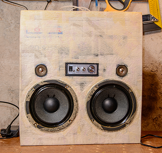

I have attached a photo of my boombox. The loudspeaker is half finished. I need to finish a small box to put in power supply, amp and bluetooth module. It will sit on the top of the boombox.
I run left mid driver and upper woofer on left channel of the amp and right mid driver and the woofer at the bottom on right channel of the amp. This was the easiest way to connect the drivers with the amplifier I have available at the moment Lepy amp:

I have done lots of experiments:
-Insulation:
First I lined all internal walls with loudspeaker insulation (white polyester sheets about 2 centimeters thick). I had a feeling like the insulation was sucking bass energy. The bass was there but like it was stucked in the box and didn't came out.
Then I started to remove the insulation piece by piece.The best results I get if the insulation is only on the back wall and at the bottom. This sounds much better and it lets the bass go out of the box.
-Ports:
I tried removing both BR tubes but the bass became weak and small. Then I tried one port - 6 centimeters length gives the best bass. But the box gives bigger bass with 2 tubes. I played with the length of tubes and it seems that with length of 16 centimeters I get the most bass the box can give. I will try again and shorten both tubes during weekend inch by inch and listen.
It could be this is the limit with those woofers and I can't do anything else with the box and the only thing I can do is to crank up the bass potentiometer on the amp. Perhaps I could decrease the volume of the box to see the effect.

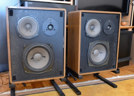

Those woofers are from old loudspeakers made by Ei Nis (a company from former Yugoslavia) - I have attached a photo I found on internet - about 20 liters closed boxes with mediocre sound and weak bass. I don't have and I can't find no parameters of those old woofers so I can't do simulations.

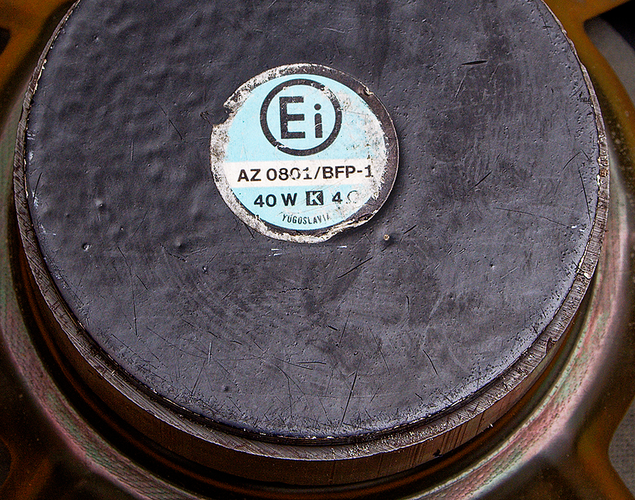

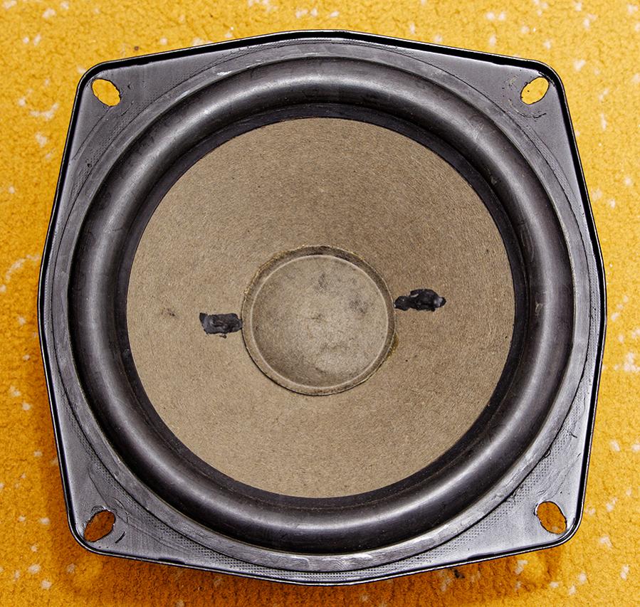

Yes; I’m 100% sure they are copy of some German drivers. They were made by Ei Nis factory. From all I could find on the net those woofers were always used in closed cabinets. Couldn’t find any bass reflex cabinets with those drivers. I also think those woofers are not ment to give fat and boomy bass. As my tests show they indeed are not the best option for my project.
I have attached a few photos of the woofer.
