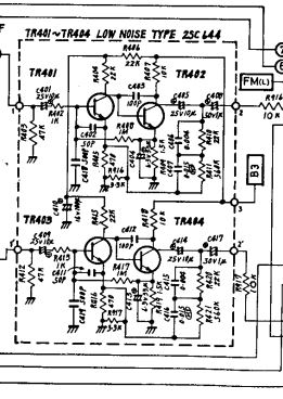

Here is the schematics of the original HK930 phono stage.

2SC244 does it say? I didn't notice till today. That's not really packaging used now. I'm surprised to see something so physically large used there. I can see quite a few electrolytics placed directly in the signal path. Have you already swapped a few of them? I imagine you must of since the 70s.
It's 2SC644, mentioned in the service manual as low-noise transistors. I checked with actual unit on my bench.
I didn't do anything with phono stage yet since I just plan to replace it.
