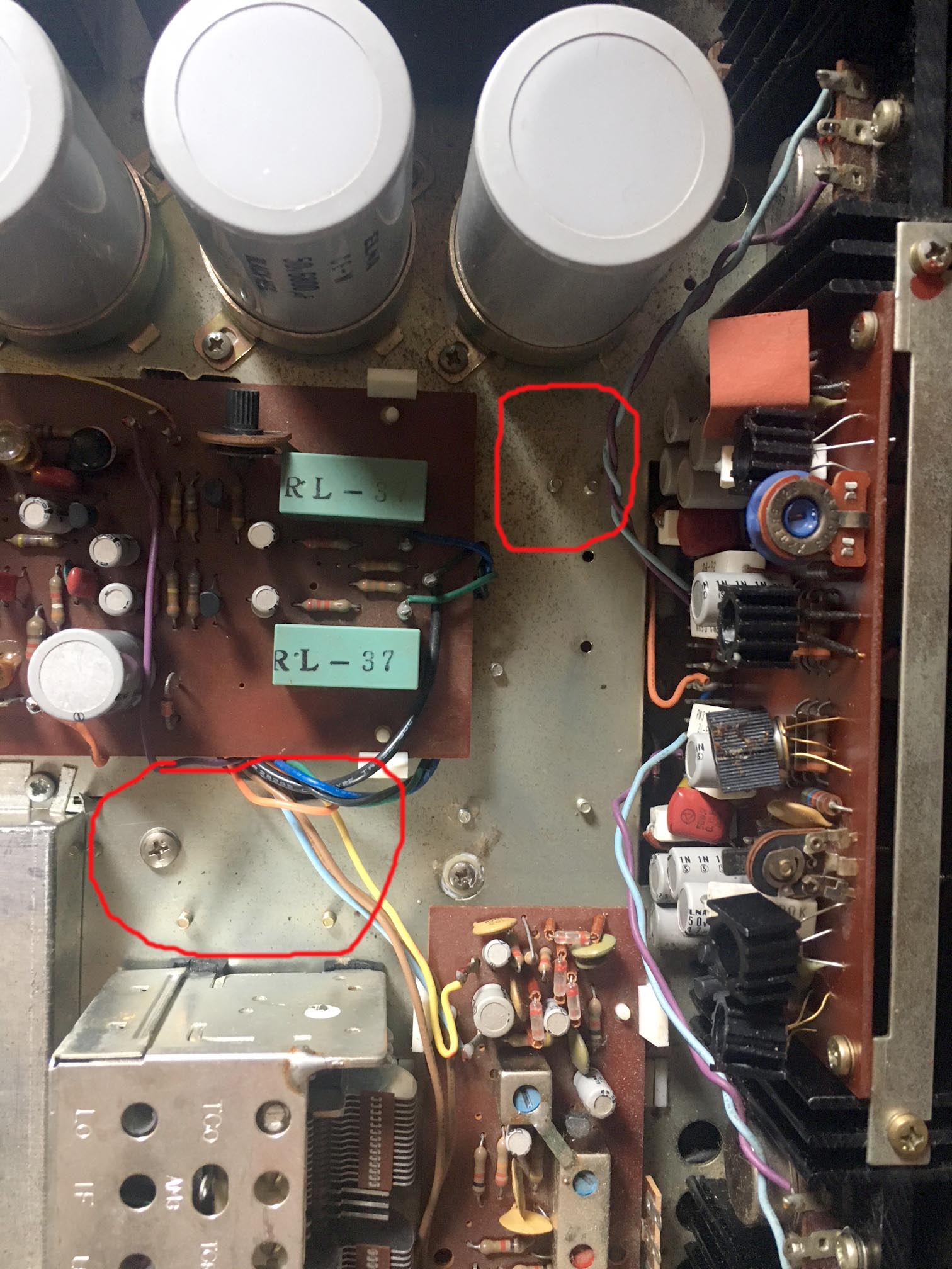

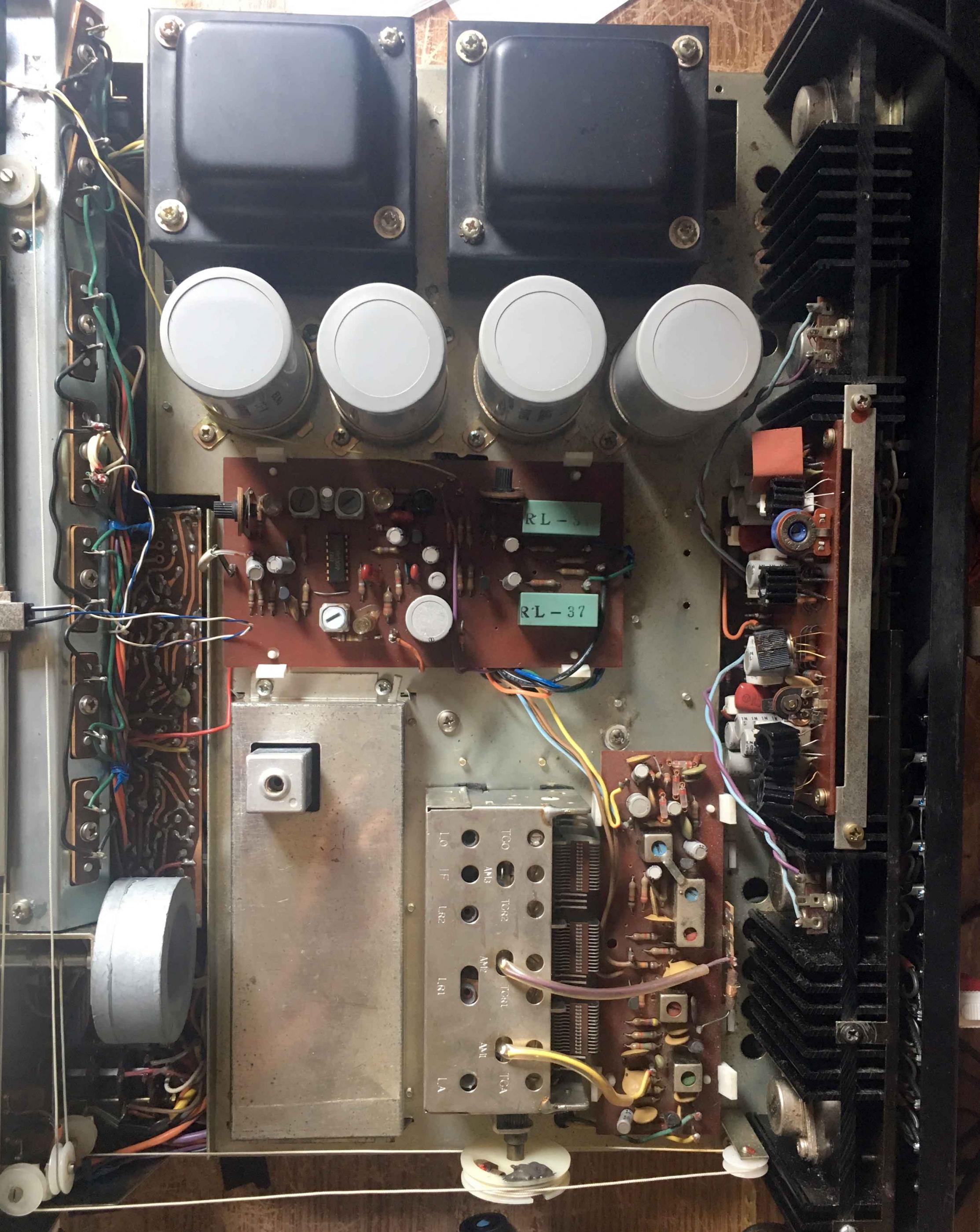

So I have a Harman Kardon 930 vintage receiver in which I'd like to replace a phono stage with something modern.
I can fit Muffsy or Richard Murdey's VSPS in the place of the original phono PCB. The problem is new phono stages require bipolar +/- 9-18 V DC (Muffsy) or +/-12-18 V DC (VSPS) and the old phono stage is supplied by just +20 V DC.
The space inside HK930 is tight and I didn't find a new power transformer for phono stage that fits. The HK power transformers have 29-0-29 V and 6.3 V secondaries. There's also +/- 41 V DC that powers output stage.
How can I use what is there to get a bipolar DC for a new phono stage? It's enough space inside HK for a regulator board or two; however, if going this way I'd strongly prefer a PCB or a kit rather than a breadboard-based one.

Sounds good; however, I'd like to go with the commercially available PCB or a kit. I don't want to go with the breadboard this time.

How about using the Muffsy PSU with the +41V DC?
Skip all the stuff that I crossed out, and connect DC as shown. (Do not connect +/- 41V, only the +41V and GND.)
This will give you +/-15V DC output. Be careful to not connect the Muffsy PSU GND to the existing GND. That's easily done at the RCA connectors/through the chassis or similar.

...or a DC-to-DC converter. This will give you an isolated (meaning you can connect the GND from this to the existing GND with no ill effects, unlike the example with the Muffsy PSU) +/-12V sufficient to power either the Muffsy or the VSPS:
Something like the the WRD241212YS-2W will accept 18-36V DC input, and gives you +/-12V DC out at some ~80 mA max.

The 40x40x35 mm will fit; however, it needs to be shielded since the only place I can install within the chassis is near FM Multiplex and Power amp boards (red areas at the first pic). Anyone knows where to get small metal boxes that could be used as shields? I have MuMetal but I don't think it's possible to wrap the small transformer in it reliably.

Great idea, thank you! I found several like this in Mouser.
I also found some AC to DC power converter such as this RECOM RAC04-12DC/277-E. Input 80 V AC to 305 V AC, output +/- 12 V DC with 166mA current in each channel. It mounts through hole as the one you suggested; can install it on a breadboard; however, it also needs to be shielded since tuner boards near it are sensitive to EMI noise.
Any experience with such AC to DC converters?

Found a WRD051212YS-2W DC to DC converter that takes 4.5-9 V DC as input and outputs +/- 12 V. The input I can get from the 6.3 V AC HK power transformer winding; in one of two transformers such winding is not used at all.
I can find a rectifier PCB module that gives 7-7.5 VDC at the output (with the load) and feed this into WRD051212.
Is this a good idea?

The 20 V DC is there; it's used for powering up the preamp section of the receiver, the FM multiplex board and the phono stage. I always thought it's better to separate power supplies; in some fancy gear phono stages have their own power supply or even power transformer.
The converter you recommended is the easiest option to get +/- DC for the phono stage. I'd like to see if a fancier option, 6.3 V AC conversion with something like "1N4007 AC-DC Converter 12V 1A Full-bridge Rectifier Filter Power Supply Module" from eBay into that 4.5-9 V DC to +/- 12 V MICRODC converter, is viable.

You said there was a 20V DC. That would work with the one I showed you.
