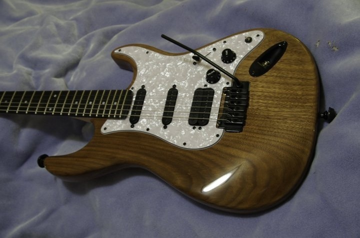

Shellac is typically brushed on and then sanded for smoothing it out unless you are applying the shellac using a French Polishing technique which is a difficult or at least time consuming technique to master.
Spraying Nitrocellulose Laquer and then sanding and polishing is a much easier process and technique to learn. Attached is a sample of something I used Laquer as a finishing media. It's glass smooth and as glossy as you can get.

Using rattlecans of nitrocelluous laquer gets you a finish almost as nice as a French Polish without all the headaches. The nice thing about nitrocellous laquer is it becomes one homogenous coating rather than layers like just about everything else. That way if it chips or you need to fix a small spot you can just apply it in the one spot then sand and buff it until the damage disappears.
