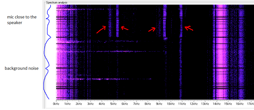

I'm currently driving my two speakers with seperate TPA3118 PBTL amplifier boards, sharing the same 19V laptop power supply. The problem is, there is a constant background noise similiar to cicada noise.
I analysed the noise spectrum and saw two appearent noise bands around 5khz with harmonics(attached under the post).
The reason i came to the conclusion that the noise is due to the power supply, is that when i plug off the psu from 220v mains, it continues to supply the amplifier for around 2-3 seconds more, during this time, that cicada-like noise is absent.

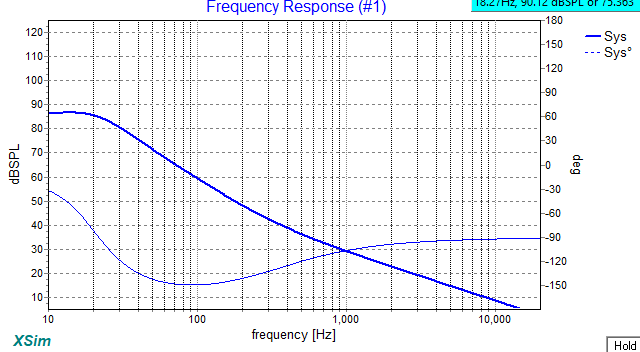

I'm currently planning to put a low pass filter between the amplier and the power supply, i'll be using this circuit:
This circuit is intended to remove 50-60Hz ripple, so i decided that i'll not need a 10H inductor. Through some calculations and considering the ferrite cores i have, i've decided to use a 200mH inductor and a 3300uF capacitor after that. The circuit with those values have around -30dB filtering at 50Hz, -60dB at 100Hz and so on.
On the calculations i've considered the amplifier as a 8ohm load, which corresponds to ~2 amps at 19 volts.
Am i doing this right? Would it work? It is the first time i'll be doing such a circuit so there might be something so basic i'm missing.
If I'm correct, i'll be buying some copper inductor wires and capacitors tomorrow and build the circuit.

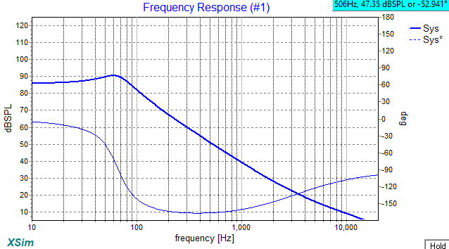

6.2mH and 1000uF should leave a resonance frequency of 64Hz. Thus, not useful for 50/60Hz. Then you either increase the capacitors to very large values or you increase the inductance value in which case the saturation current is lowered for the same inductance core.

1000uF with 6.2mH have 64Hz resonant frequency but:
-It's pretty dampened, and the resonant gain isnt more than a few dB's
-I don't have problems with noise at 50/60Hz
-On my new design i plan to use 10000uF cap with 6.2mH inductor whose resonant frequency is 20Hz with only 1 decibel of gain, and has gives -20dB more rejection at the remaining frequencies.
Both 6.2mH/1000uF and 6.2/10000uF bode plots included in the attachments, I guess i'll go with 6.2mH/10000uF
I'm afraid of going into building a good regulator, passive filters with simple calculations are much easier for me now
