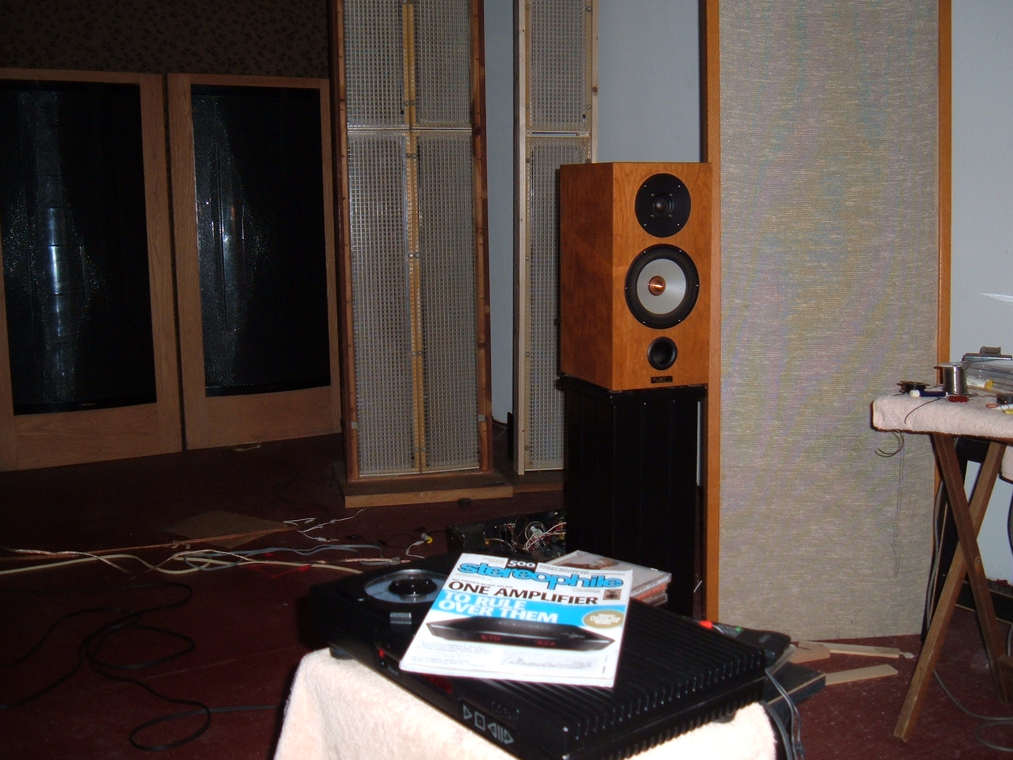

But look what we get with these mylar faceing back 30 years old Maggy panels.....in the pic above mg1c...there 15' from inside to inside....in a 18'X25'X14' room...there 8'feet off my chair... 2' off the back wall.....so that puts them 8' away faceing me .....
Sound stag...18'wide 10' high..... depth....like it gose on for ever...hehe
Big Full pin point image.....sweet tone fills the room....
One an only type sounds from what.... full rang flat panel made up of a peice of mylar... with two types wire...steel,rubber magnets ....wood board....
Lot of Fun.....great sound...

backfacing wires does not sound better 🙂 they might have implement it wrong but turning wires towards you it is the only way to get a flatter response. although i must say they over did it in the 1.7 they sound thin to me 🙁
WrineX....I get your point...this sound is not about flat response...an I know it not magic..
the high frc cant be more than 16-18k...but you you feel as you miss nothing...for years we tried to put the wire.. mylar to the front ....but there was always a peak at the top end...that's why the Q ribbon came on the seen....I have rewired the MG1.4s with the Magnepan Q ribbon tweeter foil..an lost way to much output..like 3db diff in wire..all the new mylar front speakers all sound like the 1.7 to me.....
