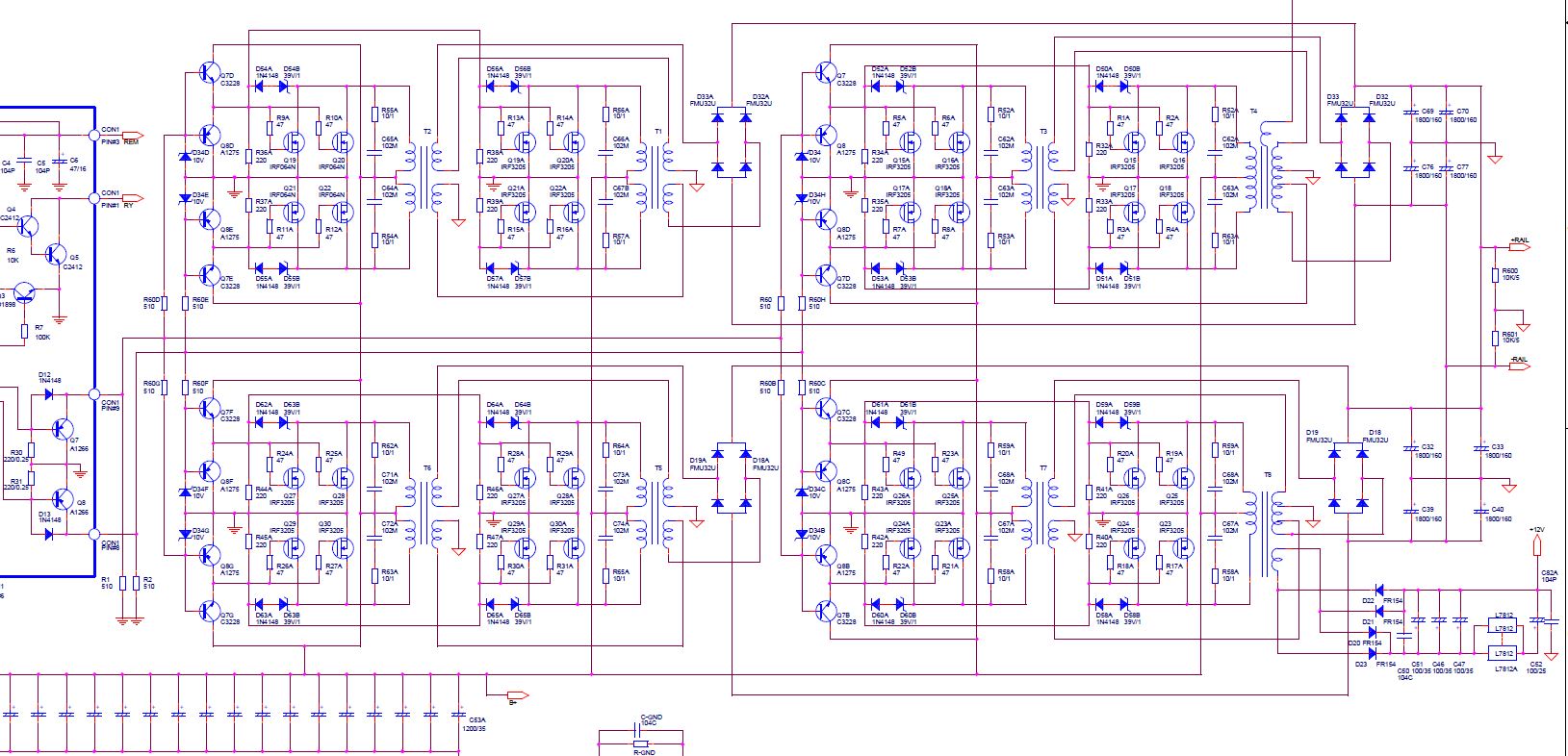

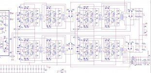

I'm attaching a part of a similar schematics (not exactly the same) of the power section.

Interestingly enough when i've received the amp the damage was only in banks 7 and 8, respectively T7 and T8 (check schematics i've posted earlier for referance)
Other 1~6 banks weren't even slightly affected. I suppose when the short happened, the auxilary voltages were not present anymore and this triggered the protection circuit. So that's how the amp arrived at my door.
So only banks 7 and 8 were bad - mosfets, gate resistors and drivers. Bank 7 is working flawlesly after the rebuild but Bank 8 is still problematic.

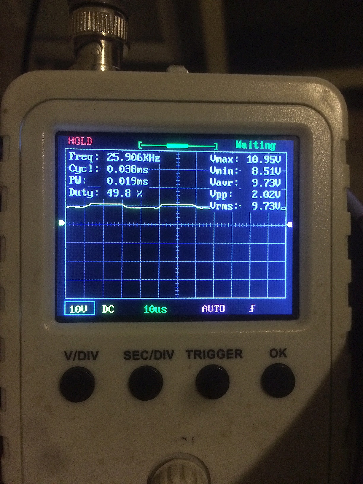

I think maybe i found something. Took the MOSFET out of bank 8 where Transformer 8 sits.

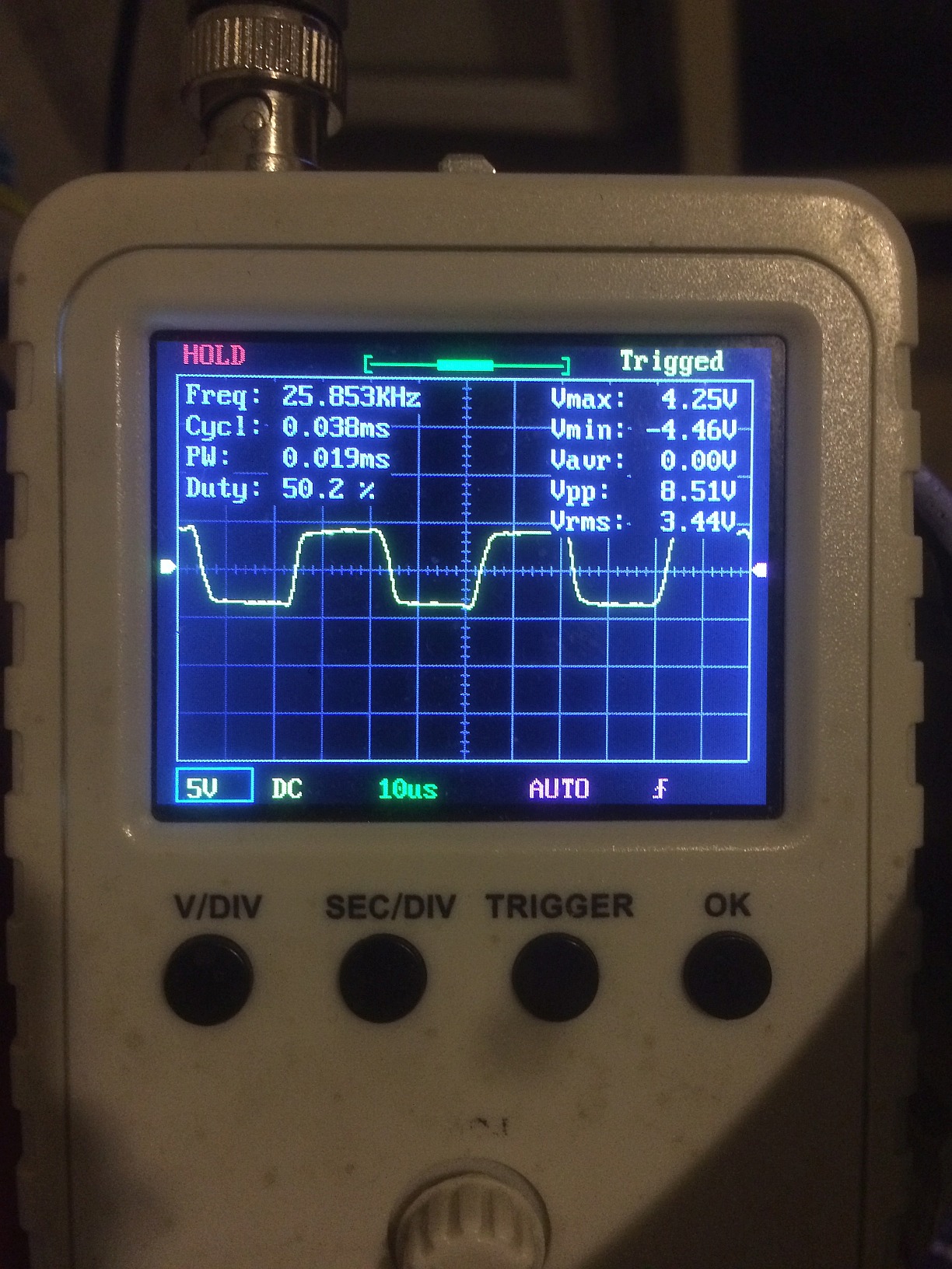

The first picture is what T7 secondary winding "sends" to secondary of the T8. It's a small wave with amplitude of 3.44vrms.

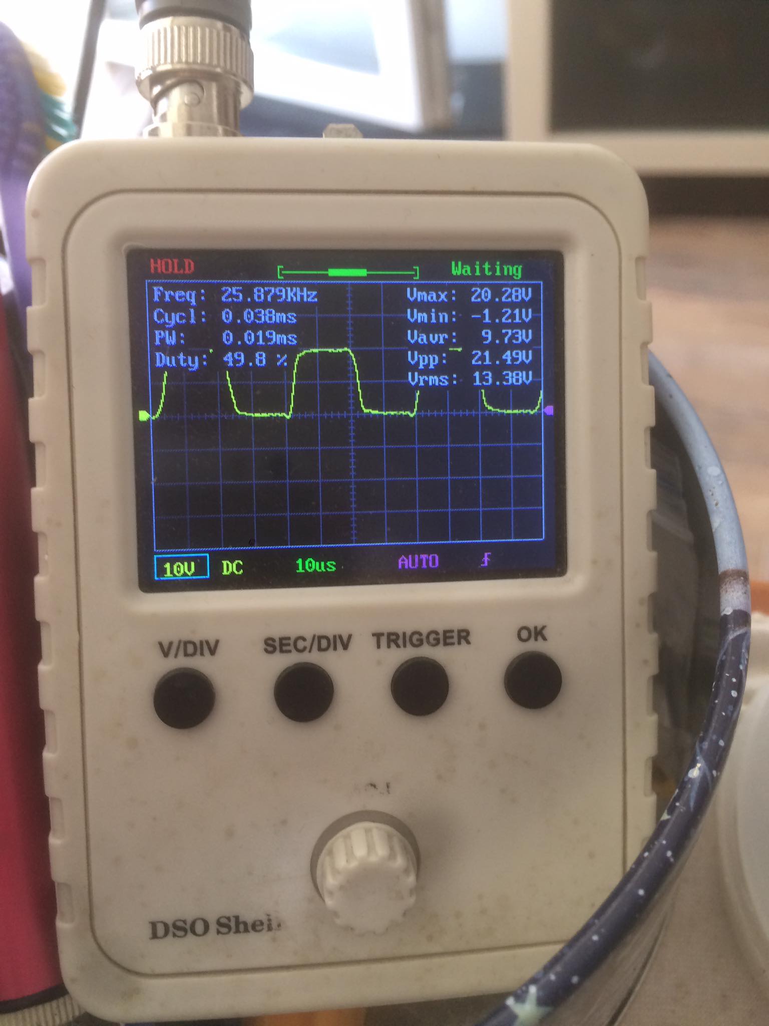

The second picture is what I see at the primary winding of T8(drain pads on the Mosfets at bank 8). It's not even a regular wave.

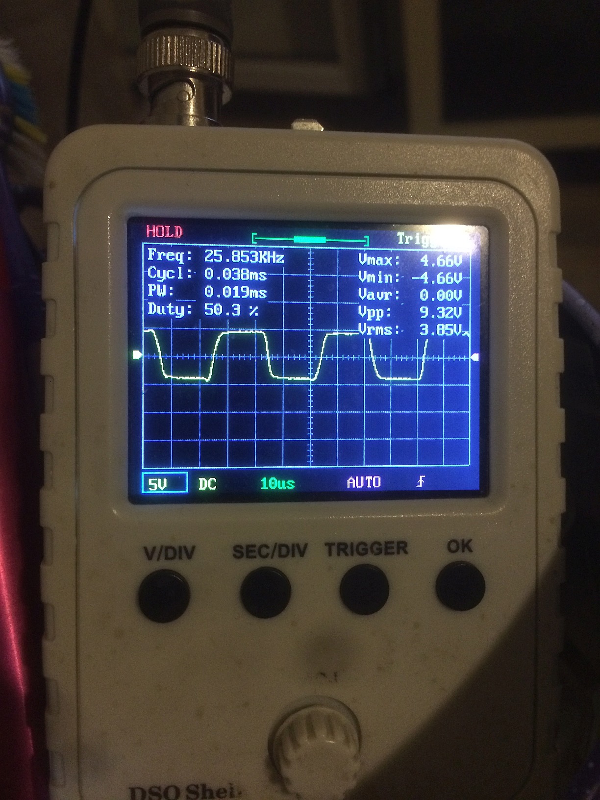

As the rest of the transformers T1~T6 are working perfectly fine I looked at their readings and waves.... and here it is - they are in series but what T1 sends to T2, T3 --> T4, T5-->T6 is the same wave as at picture one but amplutite is like 11 times MORE. Its 3.85vrms but with the probe at 10X, not 1X. Can be seen at picture 3.
Why does T7 secondary winding produces only 3.45v instead of like 38.5v ?
(this is the winding connected to T8, the other secondary one is directly connected with a cable to the rectifier and produces the RIGHT voltage) The wave look the same, but amplitude is not.

This is how the primary winding tied to the Mosfets drain pad looks like on all of the transformers and banks except number 8.
The other primary windings sit at b+ on all of the transformers.
