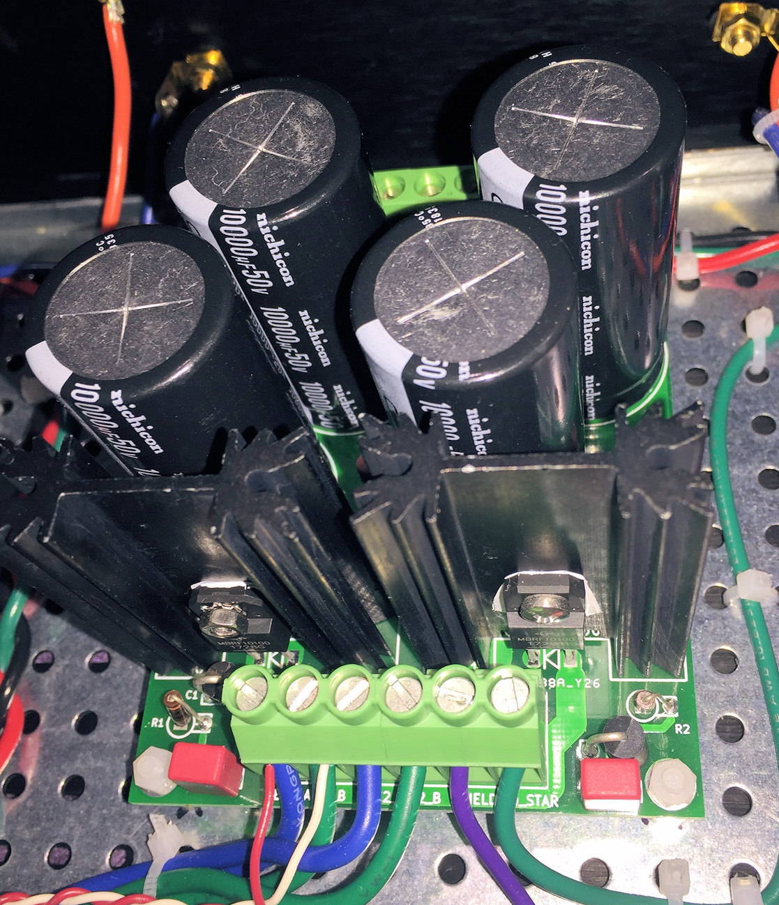

Here's a fun thing you can do with electrolytic capacitors in power supplies: take infrared pictures.
Click on each image to see it undistorted and full sized.
You can see that the electrolytic cans have a big zone of green-temperature (about 44 deg C) with a small region of yellow-orange-temperature (about 50 deg C). Then you can check the temperature-versus-lifetime equations on pages 13-16 of Cornell Dubilier's application guide, attached below.
Very curious readers might zoom in to the diodes in the photograph: yes those are Schottky rectifiers! And despite their low Vfwd, them babies are getting mighty dadgum hot.
