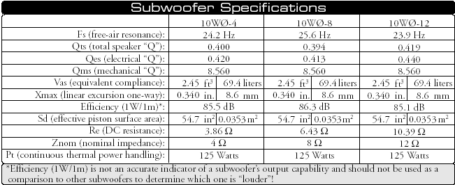

I really need help to figure out the volume of a ported enclosure
for 2 JL 10W0-4 , i cant find all the specs to figure it out. And i worried it might be to big to fit in my trunk. Is there any way to make the box smaller but still effencient. And is it a good idea to put 4 ports in it?

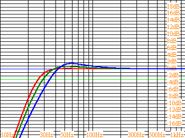

The following are WinISD simulations for the JL Audio 10W0-4:
A) In a 2 cubic foot enclosure tuned to 25 Hz.
B) In a 1.5 cubic foot enclosure tuned to 27 Hz.
C) In a 1 cubic foot enclosure tuned to 30 Hz.
All these are for one JL Audio 10W0-4 only.
For two, you can double the size, but I cannot vouch if the response will be the same-I have to conduct tests to see how the Q factor is affected by being hooked up in series and in parallel-or if it is affected at all.
If you hook the two subwoofers up to different channels, then it will not affect the response-simply double the volume, and tune to the same frequency.
diyAudio Moderator Emeritus
Joined 2001
I recommend either one 3" port or two 2" ports-the cross sectional area is very close. If the lengths are too long to fit in your box, any home construction type store will have PVC elbows. It would be a good idea to figure the port volume and increase your box volume by that amount.
I cubic foot enclosure tuned to 30 Hz: 3" port, 18.5" long, or two 2" ports, 17" long
1.5 cu bic foot enclosure tuned to 27 Hz: 3" port, 14.88" long, or two 2" ports, 13.75" long
2 cubic foot enclosure, tuned to 25 Hz: 3" port, 12.75" long, or two 2" ports, 11.8" long
Hope this is what you are looking for. Feel free to ask more questions-that is what the forum is for.
