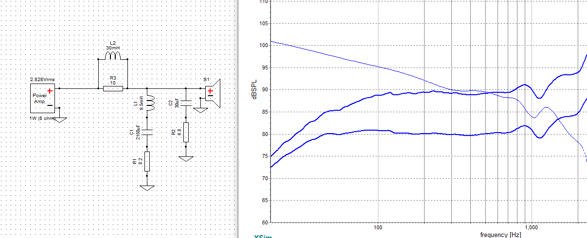

Now THAT's an inductor! 😱Here's another version which maintains the mid-hf extension of the original curve. The impedance notch filter may be best removed in this case as it gives a nice bass bump.
