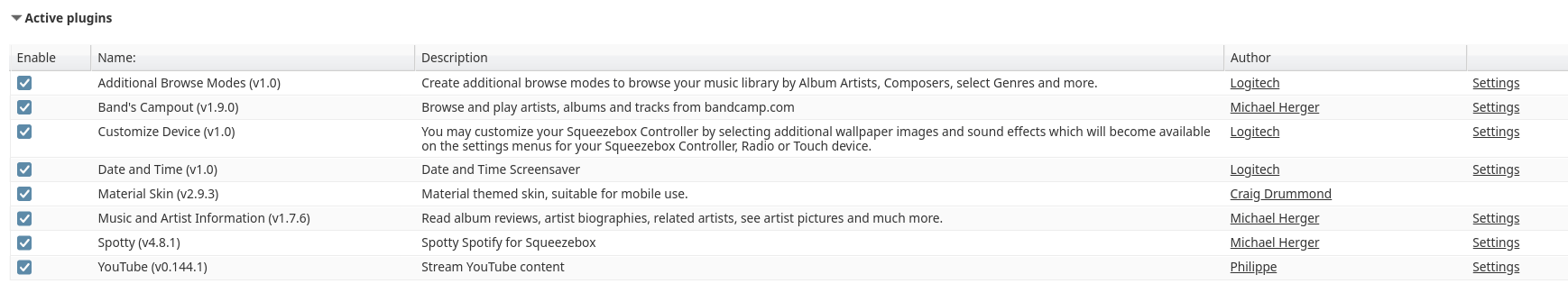

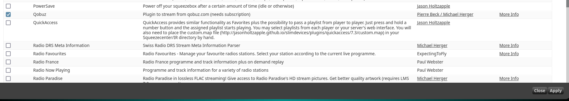

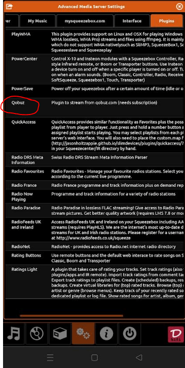

I see the Qubuz plugin in Advanced Media Server Setting under "Third party plugin" (see picture) but not in the "Active plugins".

I don't have my server running at the moment, but I think it was the main tab of the advanced settings area that has a drop-down where Qobuz settings appears after you install the plugin. You can enter your credentials there and set your default streaming quality.
I'm not using Daphile myself, but any Logitech Media Server (LMS) should work the same. This is from the original browser (which you can enter through <IP-adress of your Daphile-PC>:9000

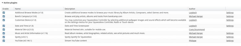

you should select the plugin from the Plugin-tab - click on the Enable button like this:
and click on Apply (bottom right).

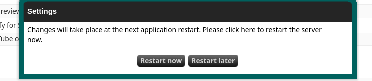

then the server needs to be restarted:

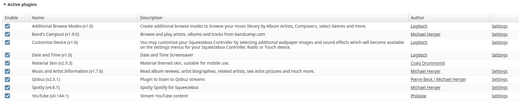

After restart you should see that Qobuz is added to the Active Plugins (in case you don't see reload the page).

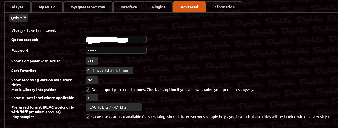

Now click on Settings
fill in your account/password.

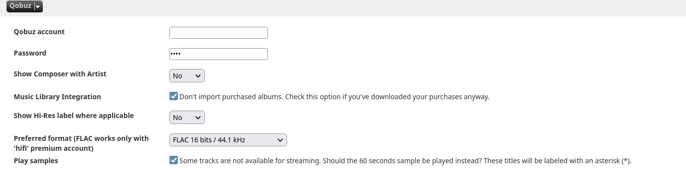

I have installed Qobuz and it shows in "My apps".
I've saved the Qobuz login and pass (see attachment).

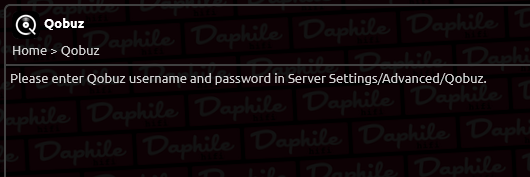

When I open the Qobuz app in Daphile there is this error: "Please enter Qobuz username and pass in Server settings/Advanced/Qobuz." (see attachment).
When that didn't work I've entered my Qobuz username, but unluckily still the same errormessage.
I've tried several times by reentering both my e-mail and my Qobuz username and of course each time my pass. Each time the same errormessage.
