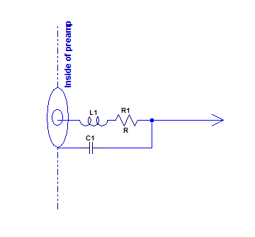

I am picking up RF interference in my turntable setup, which is located on the 34d floor of our home. I have a MC cartridge connected to a headamp that is connected to a separate phono preamp. With everyting connected, I can detect a radio station even at normal listening levels. When the phono cable is disconnected from the headamp, it's all quiet. I can't seem to solve it with grounding schemes - have tried all the ones I can think of. I seem to recall that RF can be eliminated with a small capacitor across the inputs. Is this correct? What size? Would this change the loading of the cartridge and hence its performance?

The LC filter is certainly a good candidate, I have used it myself many times with success, and for much harsher perturbations (high pressure Xe lamps starters), but to correctly select your inductor, you need to know the approximate RFI frequency: beads will work mostly for FM, but FM rarely causes audio detection.
The conversion mechanism is mostly envelope detection, which "works" best with AM signals.
Normal AM broadcasting takes place between ~100kHz and 2MHz, and the effect of most beads at these frequencies is going to be marginal.
An inductor, in the 200µH to 2mH range, possibly damped by an additional series resistor should work better.
If you use a very large inductor, you will certainly eliminate the interference, but you also risk damaging the audio highs.
It depends mostly on the impedances of your system.
Here is an explanatory diagram:

Try stringing one of your largest beads on the wire connected to your Cinch (inside the preamp), in combination with a cap of a few nF, as outlined in my schematic above.I can't tell what station is causing the interference so I don't know if it's AM or FM.
If it doesn't work well enough, substitute a 470µH choke for the bead
