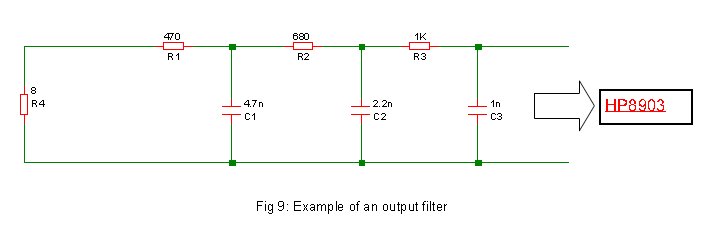

I found a filter for carrier wave, in IR AN1071 page 10

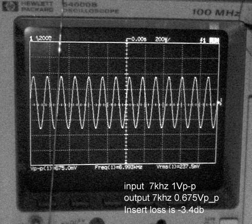

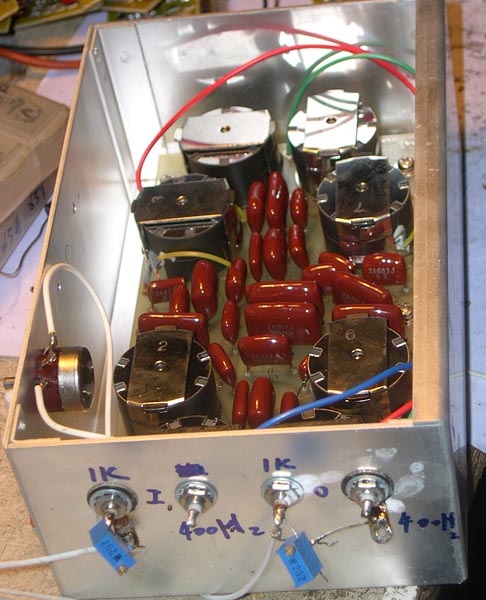

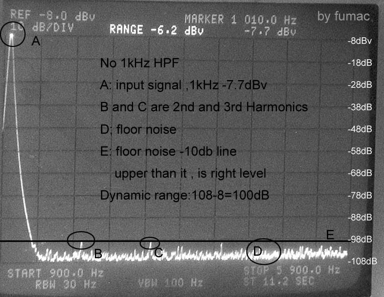

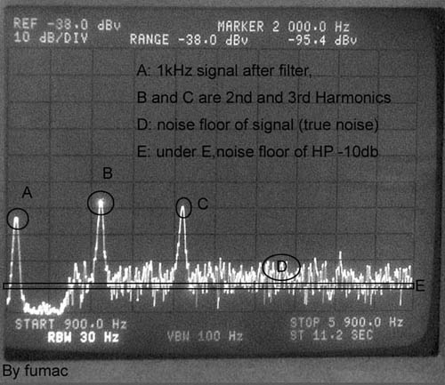

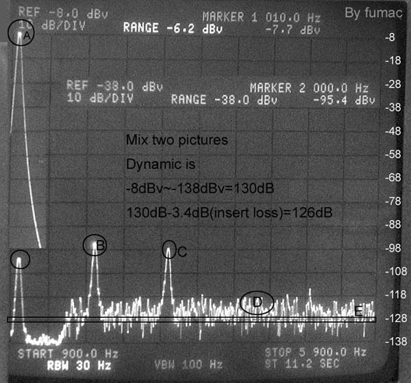

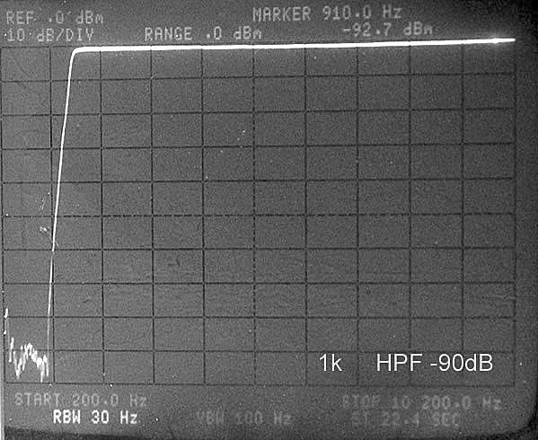

we are doing reasch at a high dynamic test,
a simple way to test at a large dynamic, more than 160db
so i will post some pictures for how to test it .
we have a hp3585A spectrum analyzer, 20hz ~40mhz
but dynamic of it is 100db(just can use 90db )
so we need to add something to expend the dynamic
from this we can get a very large dynamic equment
do a caculate
filter: -90db to 1khz
spectrum analyzer: 90dB dynamic
filter loss:3.4db
so we ge the dynamic: 180db(max)
db to %
-80db:0.01%
-100db:0.001%
-120db:0.0001%
-140db:0.00001%
we can see the true noise floor and Harmonics Distortion at same time,
just add a 10usd filter can do this .
next step we will find a way to build a very low Distortion signal genarator
