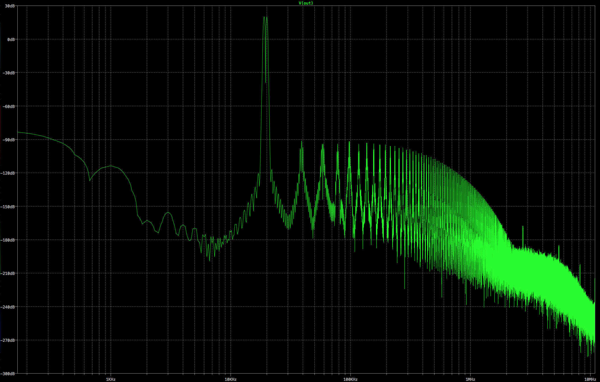

I know this thread is cold by now. Let's warm it over a little.
I've gone through this thread, and more, to figure out how to do this IMD sim properly, but I fall short anyway.
My 2 sources in series are at 18.5k and 19.5k, and my .four statement asks for 1k and 42 harmonics.
As I understood it, this should work, but the distortion reported in the log file is ludicrous at almost 10000%, and I posted my fft plot, which mostly looks ok, except for the fact that the 1k harmonic spike is pointing down instead of up, and I can see the tiny one right before the 18.5k fundamental is also pointing that way.
I know many are against using the info reported in the log, however, no matter how accurate it may be, obviously the number reported is a sign of a problem.
What Am I missing?
I ran the .tran using manual values instead of the calculated ones, except for the stepsize, which actually could be one source of the issue I'm having.
.param freq1 19.5k
.param freq2 18.5k
.param cycles=120
.param delaycycles=0
.param fft1=cycles*2*1024
.param simtime1=(delaycycles+cycles)/freq1
.param delaytime=delaycycles/freq1
.param stepsize=simtime1/freq1/((simtime1/cycles)*fft1)
.tran 0 6m 0 {stepsize}
.four 1k 42 V(out)
I don't think the .FOUR function can be used like this. Right now it certainly won't work because you're telling it 1 kHz is the fundamental.
Give the FFT a decent window function (Kaiser-Bessel, beta = 20), read magnitudes from there and be done with it. Oh, and make sure you've got .option plotwinsize=0 in there somewhere.

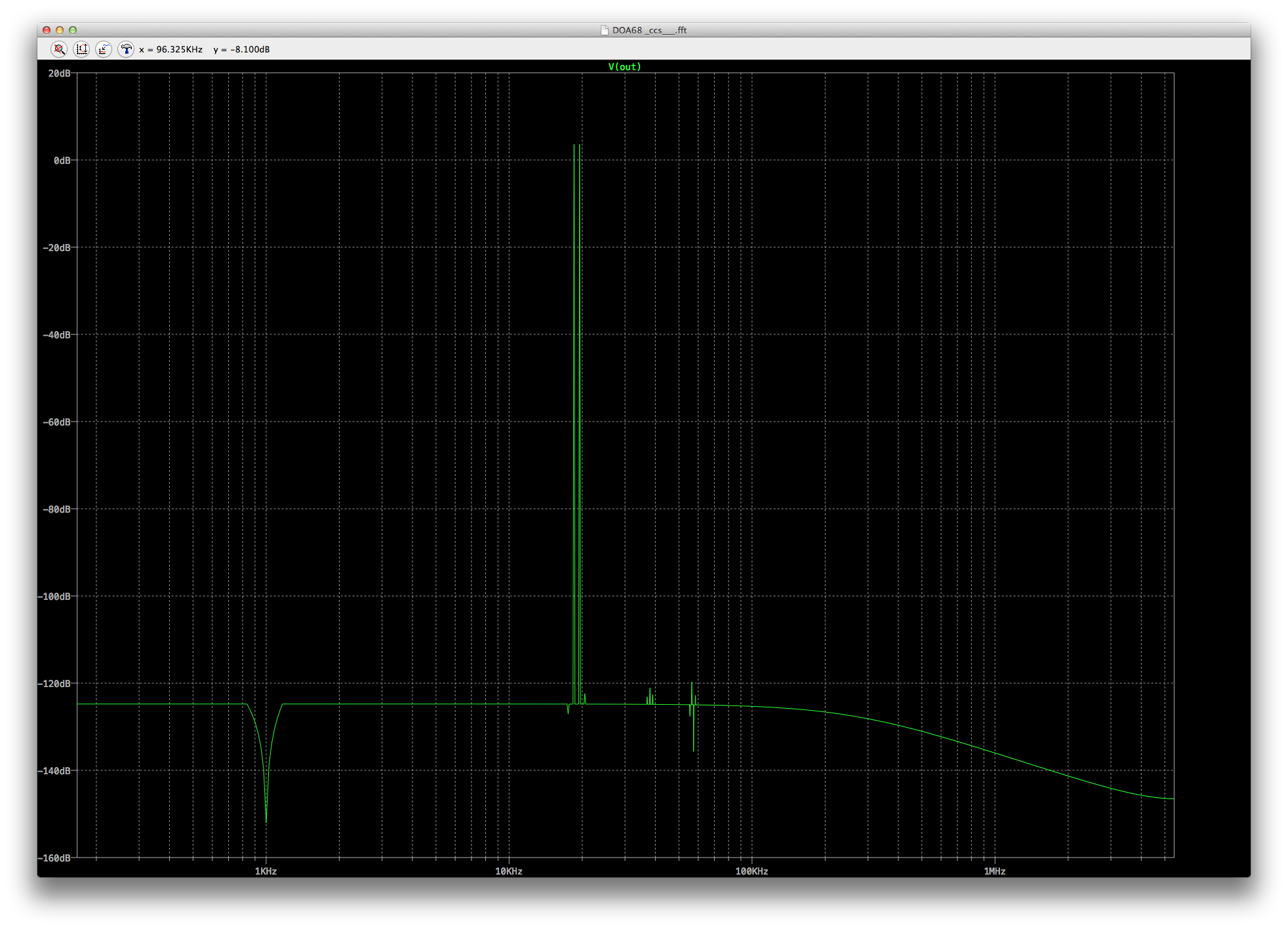

I just used this windowing function on one of my sims (posted here), and the result doesn't look to bad, however I certainly wouldn't call this "be done with it", as it's a quick visual, we do see the harmonics levels and all, but no end result with a simple number.
I suspect there are ways to add something to do calculations.
All I can really conclude from this visual plot is that all the harmonics are below the 2 fundamentals by over 110db, which seems fairly good. I just would like to have the data compiled into a simple number just like thd is done.

I use Blackmann, requires > 4x "oversampling" to resolve the spread peaks - but the floor, spreading suppression is very good
but don't rely on windowing alone - still make a strictly periodic composite signal - I use even n, m kHz with n, m integers that are relatively prime
allowed any needed low frequency transient settling time from the DC operating point solution - in extreme cases I have use load/save bias on a sim "bootstrapped" with no signal and coarse time step when the initial DC operating point is poor
