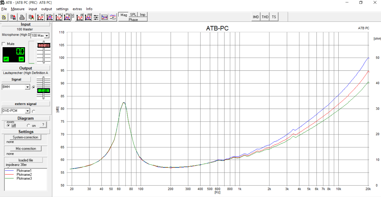

Imepdance measurement of a 38cm loudspaker with and without a single copper ring (approx. 2mm height).
higher impedance is without copper ring
middle impedance is with 60mm copper ring on the pole piece
lower impedance is with 62mm copper ring on the pole piece
the voice coil has 63mm diameter
so you see its important to get as close to the voice coil as possible
The driver is a AD Audio https://www.traumboxen.de/ad-audio/r1524.htm

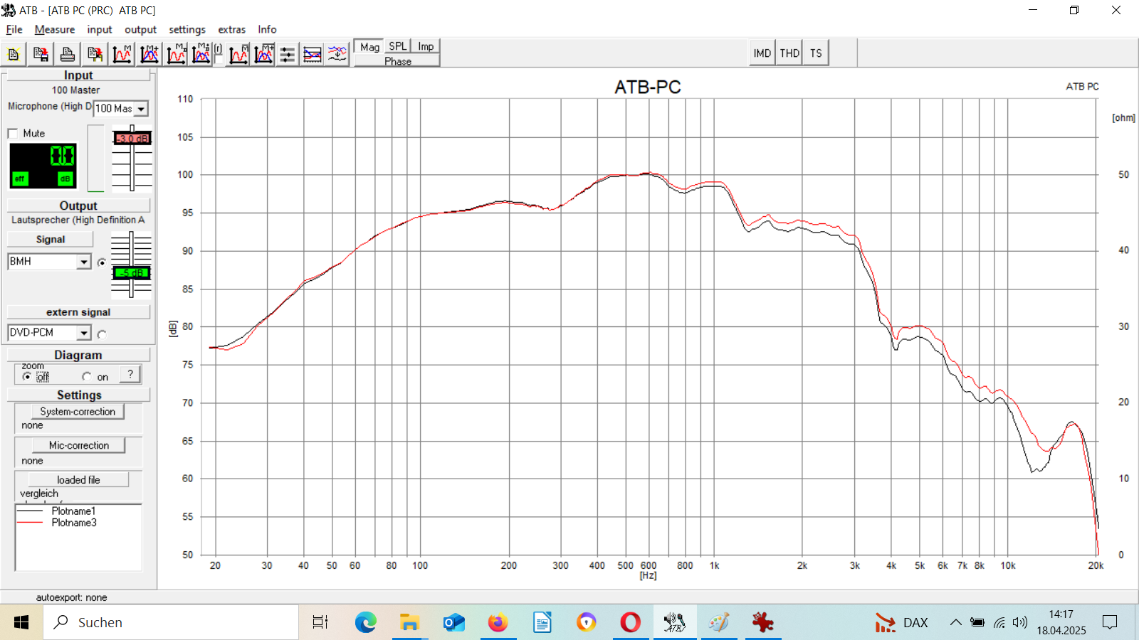

Thats the F response of the driver with two copper rings (4mm in height)

As far as I know there are manufacturers who do not add a "full sleeve" to their drivers but like in my experiment only a cover on the pole piece.
I found the Dongle and my measurement system.
Not difficult to make now THD and IMD measurement - if the software works on win10 like before on win7.
So when opening and modding a driver I could see what distortion looks like with and without.
In my listening tests a copper topping of the pole piece clearly won over leaving it out.

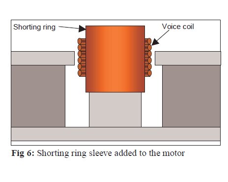

Feyz Pirimoglu wrote on this in his paper (posted in this thread)
In practice, the exact placement, shape and the number of these shorting rings in a
motor assembly vary from design to design. Some of them are on the base of the pole
piece, some cover the pole piece as a sleeve, some are wide and cover the inner surface of
the magnet, some are two rings that sandwich a T shaped pole piece from above and
below, etc. A shorting ring which is a coaxial sleeve with its radius equal to inner radius
of the voice coil and with a length that covers at least the over all excursion range of the
voice coil, has the most effect on the impedance of the voice coil than other ring
configurations that are used. Because of this and since this document is on the effect of
shorting ring on voice coil impedance, the shorting ring investigated here will be of this
kind.

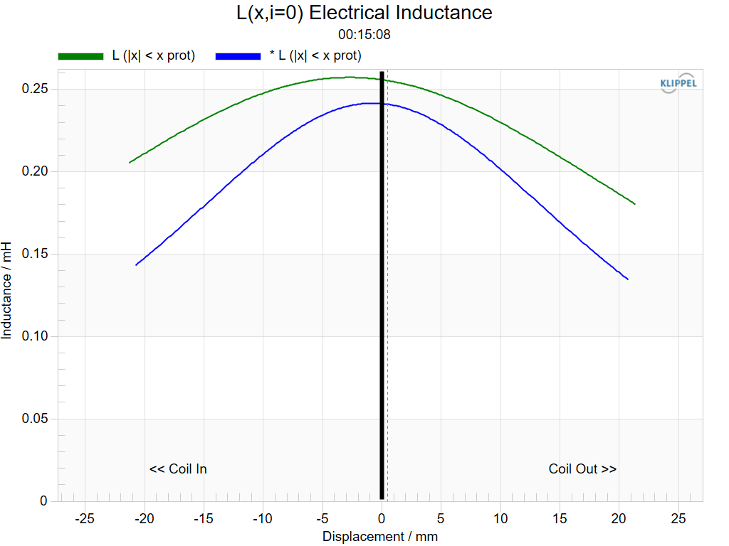

I design and build speaker motors with many combinations of shorting rings, including some with full pole sleeves. You truly do need to simulate the effects of them in software as steel and its saturation level also affects inductance. More time than not, just guessing on where to put shorting rings can hurt more than help. The Dayton reference line uses full sleeves, and their subwoofers also use a full sleeve in combination with a magnet ID ring below the gap.
Here is an example of how a pole sleeve does not always help. This is an underhung motor that I developed, and the blue Le(x) curve is what I measured with a full pole sleeve in the motor. The green curve is the same motor with a strategically placed pair of shorting rings and no pole sleeve. The compromise was a slight increase in global inductance, but a much better Le(x) curve.
@hurrication
the linearity of cone travel is better with the optimized use of copper. Nice to see.
