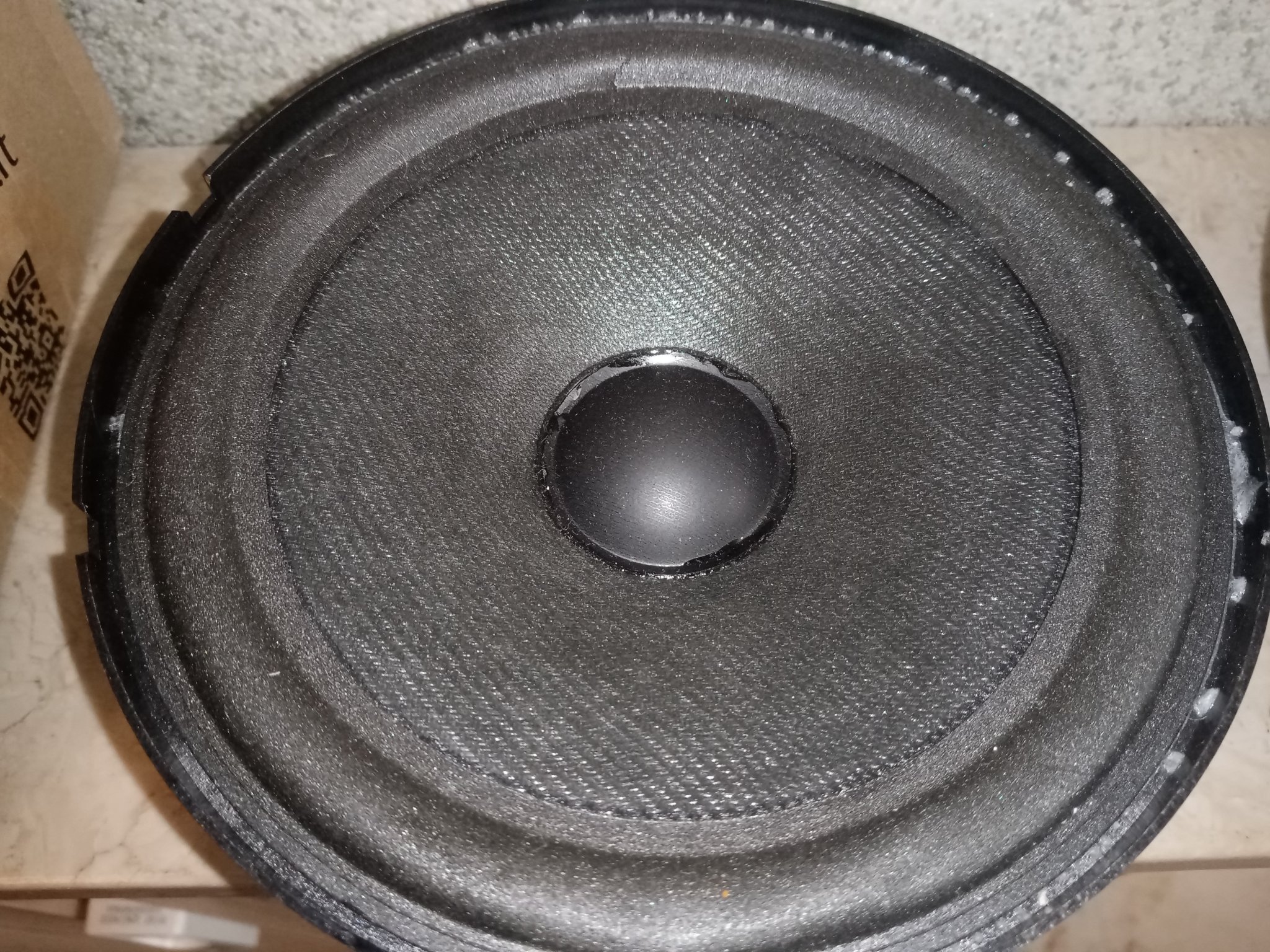

First some information on how to remove a dust cap of a loudspeaker driver (detailed description follow the link) :
https://www.diyaudio.com/community/threads/how-to-remove-a-dustcap.397165/

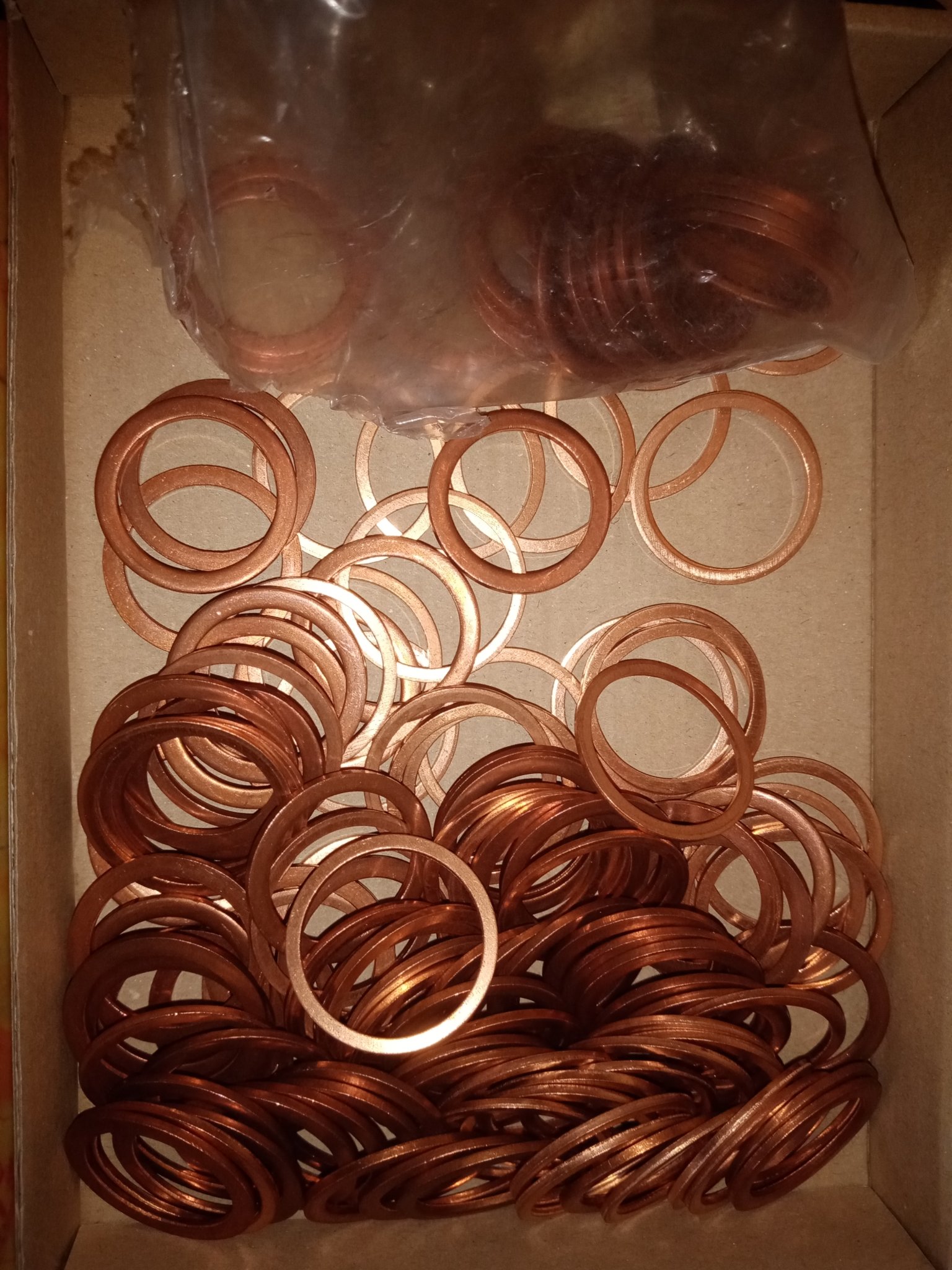

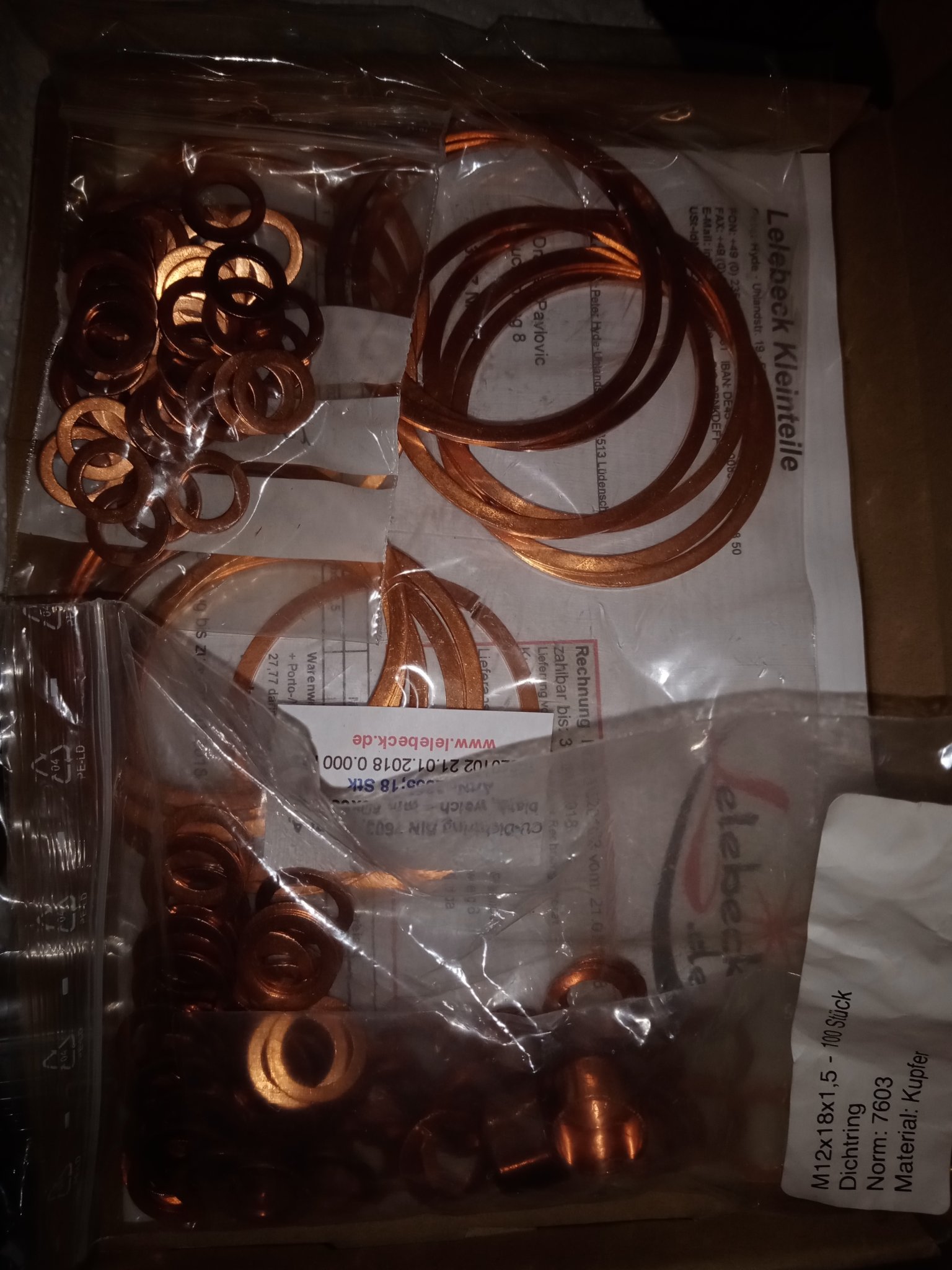

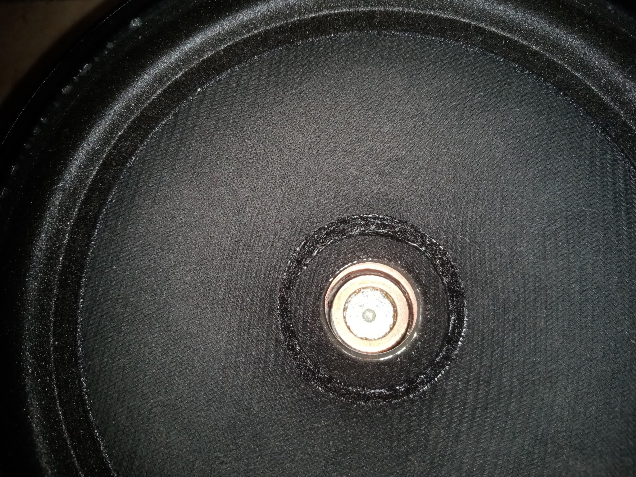

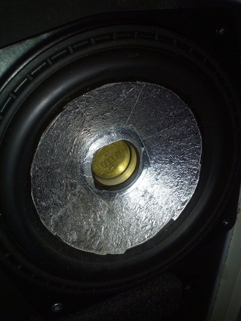

After you have access to the pole piece you can add a copper ring or a 20 euro cent or 50 euro cent piece to the pole plate.
Copper ring added of appropriate size:
https://www.diyaudio.com/community/...-firing-speakers.121385/page-175#post-6707993

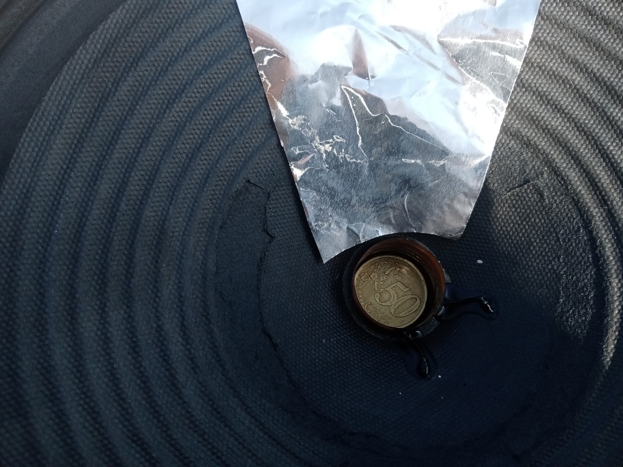

Read carefully how to use the glue for fixing ring or coin. Do not put too much glue as no glue is allowed to drop into the voice coil gap.

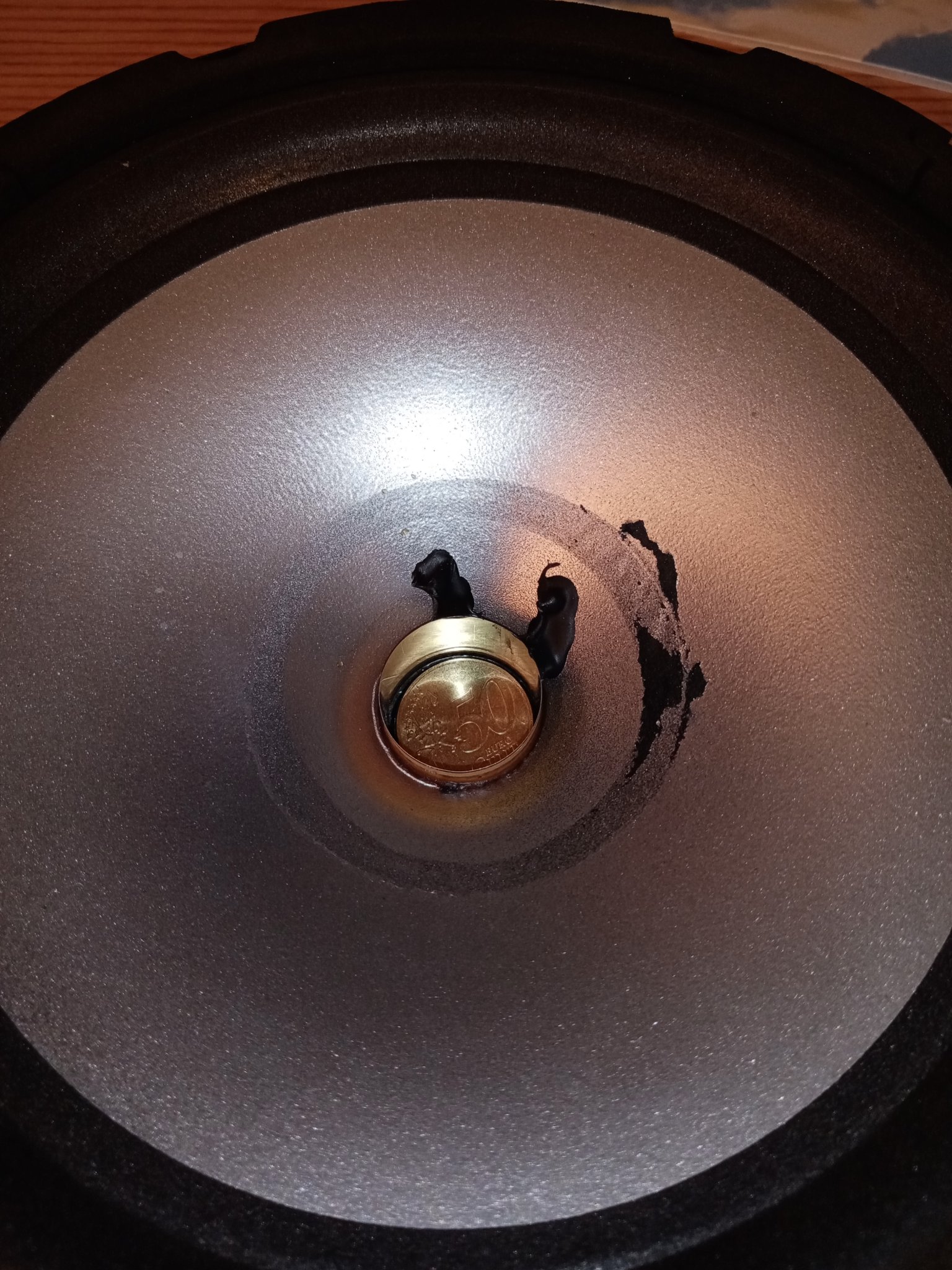

The small Euro coins of 10, 20, 50 cent contain copper so they can be used for this purpose
12cm driver with added 50 cent coin to the pole plate, I call it "50 cent trick":
https://www.diyaudio.com/community/...fication-to-current-drive.389985/post-7197710

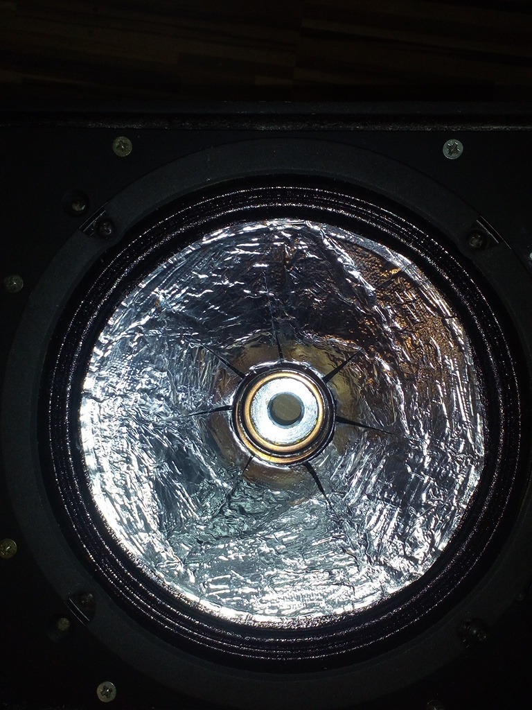

For who wonders about the alu foil on the paper cones -
My fullrange drivers get an aluminium sandwich cone DIY:

If you do this modification you can compare the effect by removing the dust cap of two identical drivers and listen to Mono music and use the balance knob of your pre amp to switch between the two drivers fastly. You just drop a copper ring without fixing it into one of both drivers on the pole plate.
25cm driver with "50 cent trick" :

You can add several copper rings or coins for covering / shorting the full travel of the voice coil in one direction.
I found no possibility of adding a "full sleeve" shorting ring which would cover the voice coil travel into the other direction towards the magnet.

faraday ring and if possible with some height covering the full travel in one direction lowers inductance and distortion.
Certainly most audible and effective is just one copper ring of 2 to 3 mm in height. Doubling was still measureable with small signals.
With signals using full cone travel and good measureing equipment you can see some more.
Easily was measureable the drop in impedance in the highs:
you could get down from 30 ohms at 20khz to 20 ohms and lowering in distortion was obviously already detected by listening to it.
