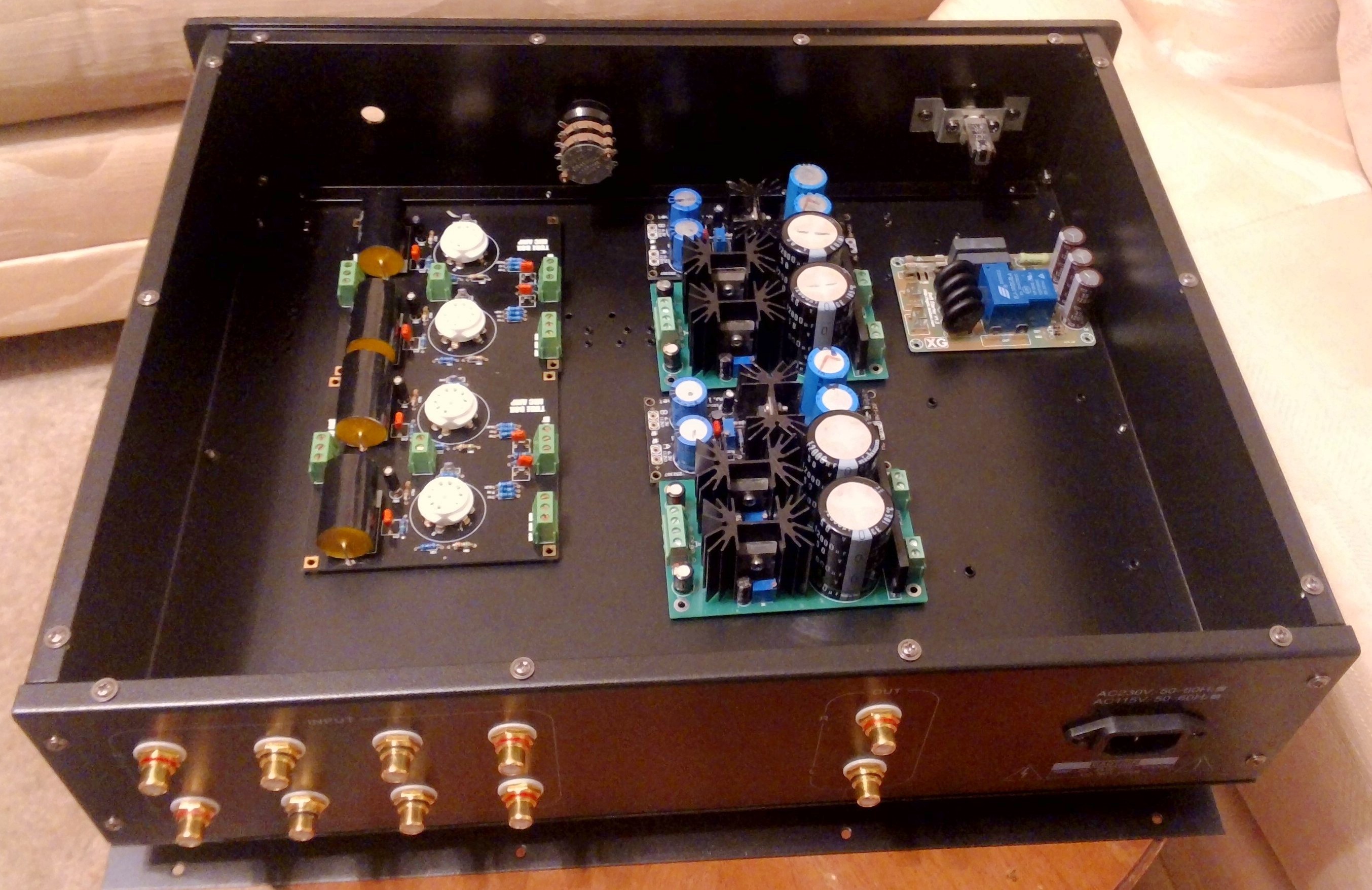

I built a board with an Alps stereo potentiometer ALPS 100KAX2 100K Ohm Audio Taper Stereo Potentiometer 6mm Shaft and buffered output. It's all on a very small board. You can change the gain with on board jumpers.
It works great. Putting the buffer right next to the pot means that you can run long leads to the next circuit without making your volume control act like a tone control too. You can use this module to drive line level output jacks.
