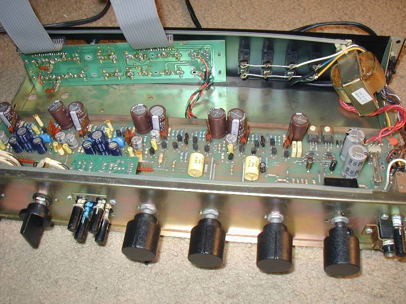

Must... reuse... 20 yr old lytics - is this a joke?
Ok, the listening continues.
Plugged in my other Hafler 280 and immediately noticed the same thing. If I had to describe it, it's like the sound is running through an equalizer and the 20kHz band is set to -10. Weird and very, very irritating.
I'm hearing this mainly in the cymbals, chimes, and steel strings. All of the tinny 'metal' is gone from the sound. It sounds utterly lifeless and flat.
After 'The Flaming Lips' I tried Bob Dylan's 'Time Out Of Mind'. The sound is clear, don't get me wrong, but the edge is gone from Bob's voice and, as usual, the cymbals sound like they are coming from under a pillow. 'It's not dark yet, but it's gettin' there' - you said it Bob.
After that, I put on a recording that I know to be too bright, The Smith's 'Louder Than Bombs'. Even this sounded muted and was astonishingly lifeless considering the original recording was lacking to begin with.
At this point, the IC caps are on their way back in, and, yes, it rubs me the wrong way to put 20 year old lytics in anything - but I cannot live with this any longer than I have to! I can let the new stuff 'burn in' until next week when I will have time to put the old stuff back.
One last thing, I can hear this difference in the preamp with 2 different pairs of headphones, not just my amp/speaks.

I just looked up the schematic for the DH110, and noticed that is uses 3-terminal regulators. You need to be careful with these, as low ESR output caps can cause them to oscillate. Normal-style electrolytics like the Panasonic NHG series have enough ESR so that thay should be safe.

Yes, it does use a couple voltage regulators, and the caps in conjunction with said regs are now very low impedence Panasonic FM caps, that is, the 50V 1000uF and 22uF. I did leave the unit on all night last night, and this morning it was completely cool to the touch with the exception of a bit of normal warmth over the transformer.
One of my inspirations for acquiring the ELNA SILMIC II caps for the rails is the fact that the schematic reads exactly this:
470mfd, low ESR electrolytic, 25V
Now that's from David Hafler Co. themselves.
I do find wrenchone's comment very helpful because I was thinking of trading out the ELNAs first, then the FMs if things did not improve.
At this point I will probably not power it up again and will switch the 4 power caps first. Thanks again to all who have made suggestions, I will keep you updated on this.

Here's a theory... Low ESR caps provide the OP section with enough current that some sort of beta droop is occuring in the OP or driver stage as they strive to drive the load..... with softer caps, the rails sag more reducingdelivered power... Granted MOSFETS are relatively immune, still. A softer supply will sometimes sound better as the OP as the active devices are not taxed as much and perhaps may work in their linear range.... Just a thought...
In support of the theory... if the kick drums sound punchier but the highs and mids harsher, then it is a stronger possibility of this phenomenon IMHO.

The truth is, when I performed my 'mod', I did it over the course of a week or so, Elnas first, then the FMs for the PS. The problem is, I also changed a signal cap that I entirely forgot to mention.
In the excitement of 'destroying' my equipment, I had forgotten C21. C21 is a .01uF PP bypass cap that bypasses one of those magic IC bipolars at the output of the line amp. The schematic calls for a 50V .01 PP, the Haffy came with a 100V axial standing on end. I switched it to a 63V WIMA FKP, supposedly for 'audio' use as they claim. Whatever. Cymbal killer.
Just for good measure I changed those 1000uF jobs back to the original IC caps and put the original PPs back at C21/121.
No other changes were made, that leaves the new Elnas and the FM caps as the 50V 22uF PS caps.
Sounds pretty much like it did before.
It doesn't sound like much at all 😉
As some of you have mentioned, a working PS is a working PS with pretty much any working caps, so this probably means DO NOT use WIMA FKP caps (hee hee).
Things seem to be back to normal, and I have achieved my goal regardless of whether I can hear the Elnas or not, I have extended the life of my equipment and that means a whole heckuvalot to me these days.
I'll try to attach a pic...
