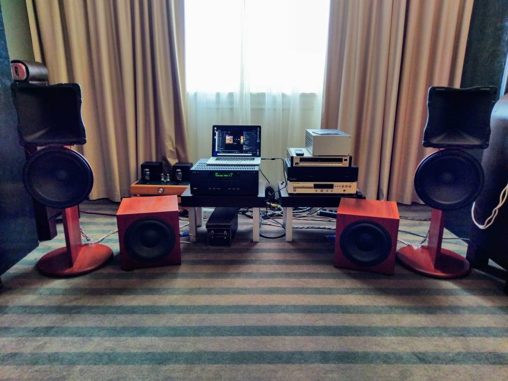

These are my speakers on audio show in Warsaw. There were four set of speakers in our DIY room. My baffle-less speakers were the most difficult to place. Moving nearby objects even a little bit changed behavior of midbass frequencies. Bass-reflex loudspeakers were much more forgiving.
Nearfield equalization doesn't work for baffle-less drivers. If baffle-less driver is equalized near field, the equalization is completely useless from listening position in my room. Don't be fooled by pretty "8" directivity of dipoles. They actually exhibit a flower like behavior with many-many petals.
On the plus side, imaging is really good. Speakers completely disappear. In my speakers horn section is vibroisolated from the midbass and doesn't move when playing.View attachment 800875

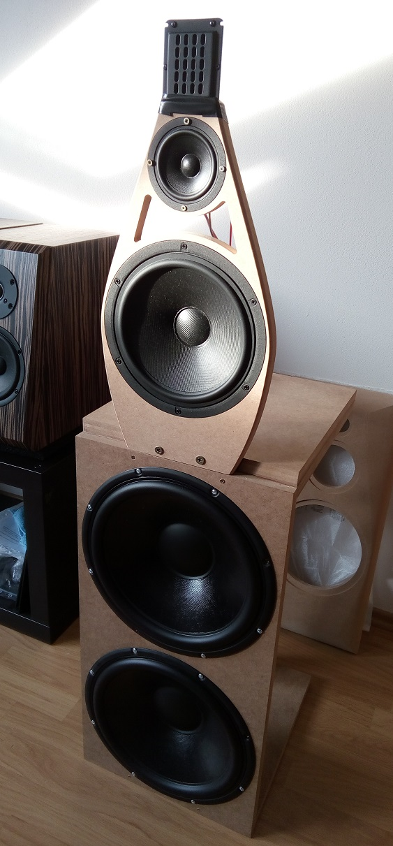

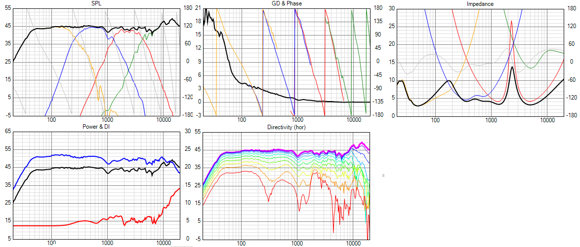

Audfrknaveen, maybe little inspiration for you. I tried 4w open baffle constant directivity just for fun, ~3years ago. Fully passive. I have never finished that, as crossover was quite complex and parts count was huge. All LR4 filters. It took several proto baffles. After all experimentation, I found 2kHz area the most problematic, it was about finding balance between no baffle and at least some baffle to provide support for tweeter.

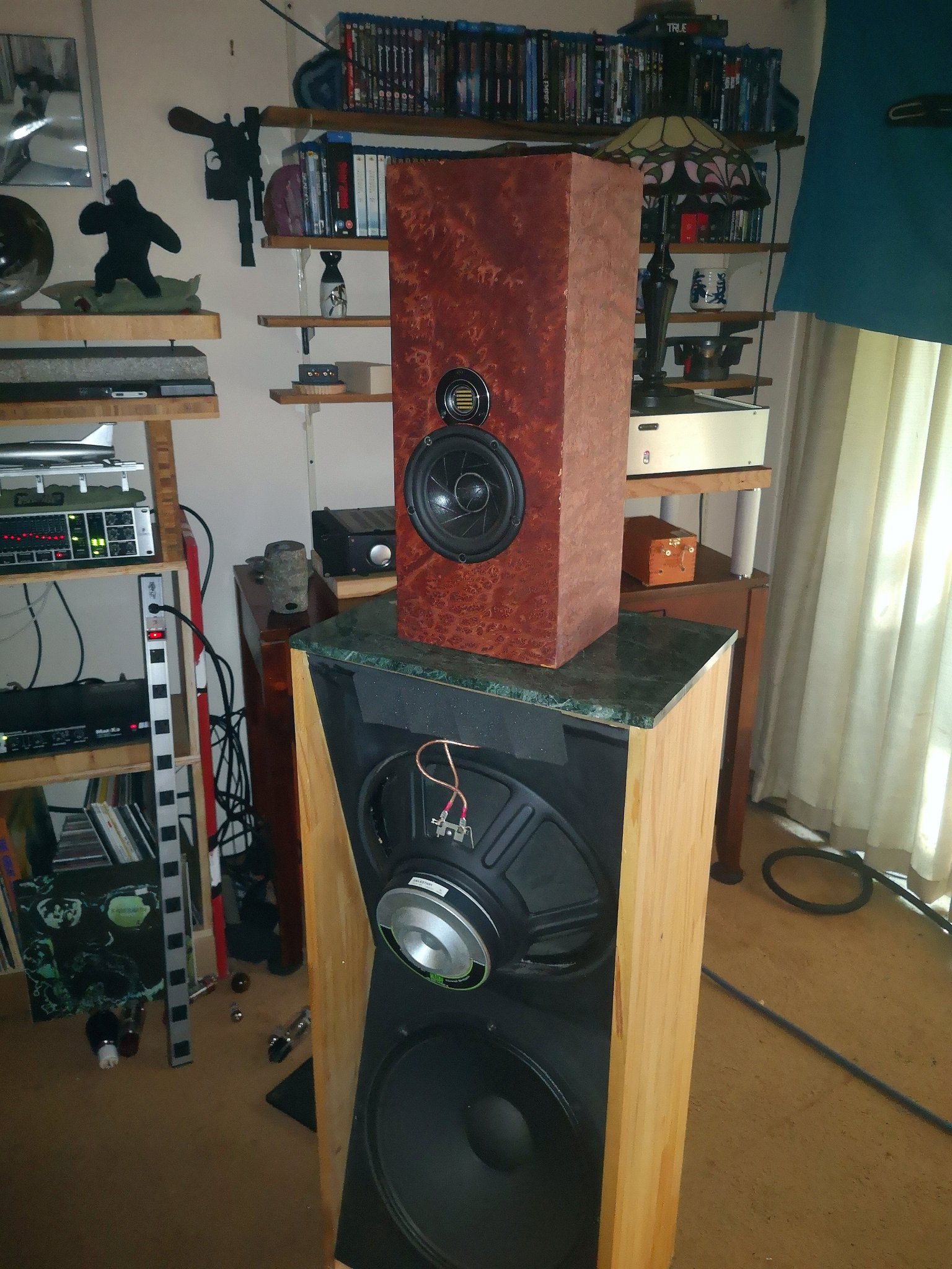

In the meantime, I am working on the third version with an Heil AMT on top and driven by Hypex Fusion DSP plate amps...

Another interesting design with minimal baffle.
The Totem of Tone, an active 3-way dipole and active subwoofer

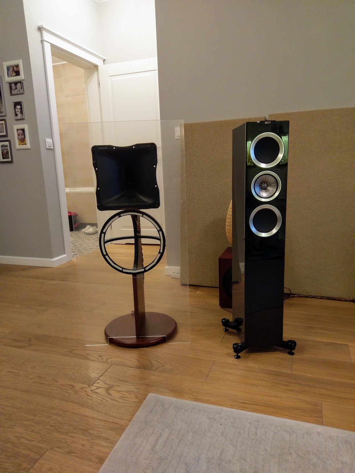

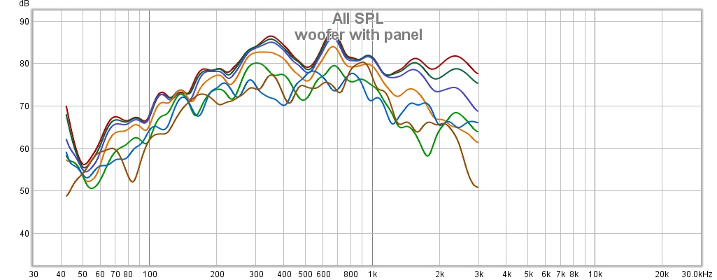

I did a comparison between "no baffle" and 55 cm baffle using the same 12'' driver. I ordered a plexi wall for my baffle-less speakers:
There is a sheet of transparent plexi in front of the speaker. The plexi doesn't touch the driver. It's right around it and doesn't vibrate because it's mounted to the horn which is vibroisolated from the woofer.

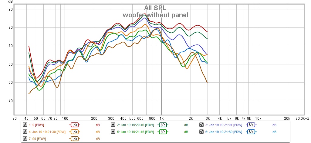

Here is a comparison of on-axis and off-axis responses from 0 to 90 degrees horizontally. In-room, mic is 1.5m to the speaker, at horn's height. The woofer is about 1m from the floor and 2m from ceiling. 1/6 smoothing, 1/6 FDW.

Puppet, thank you. I actually did not finish them. This was just an excersise to see if it can be done, and passively. It seemed it can, just parts count was quite huge. Anyway, I still like that concept, and I would like to get back to it in future, with at least woofers crossed over in active + DSP.
Pida, that build looks great. Bet it sounds great, too.

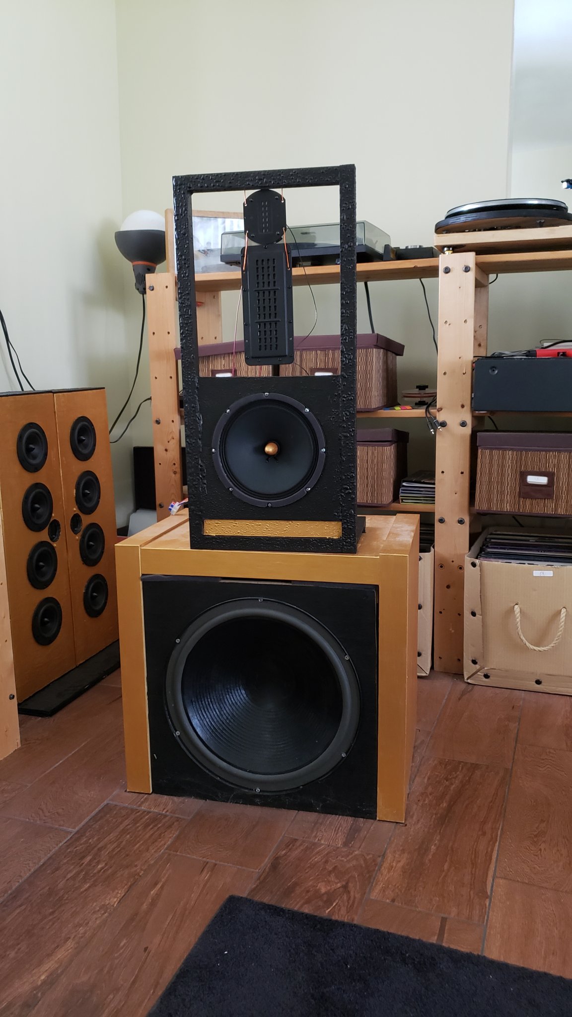

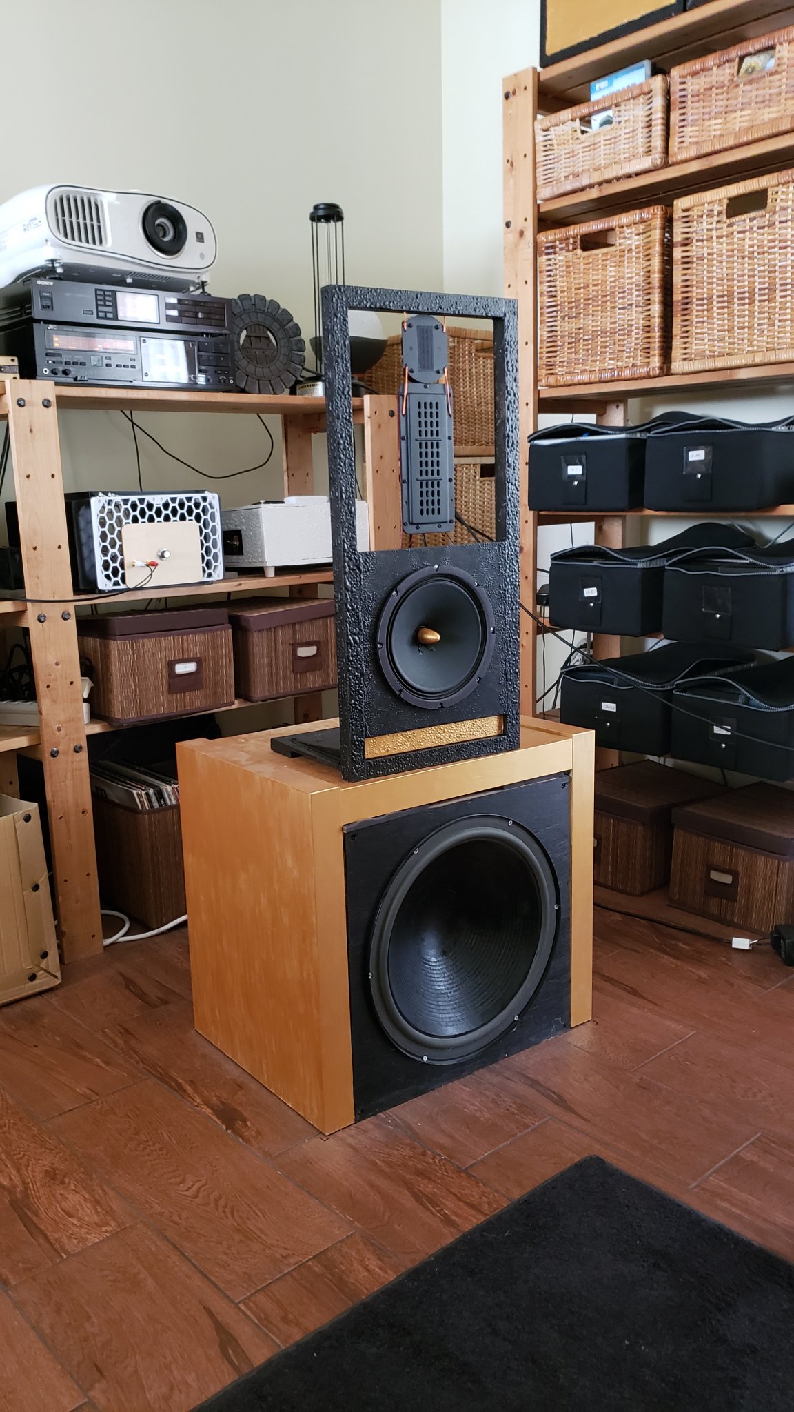

I made a couple of open back W Frames, and am trying out different "head" units for them.Try this Gainphile: Dipole Bass Array.
Four 10" drivers per side will give you greater than 15" driver surface area.
Solid to the 40s, and no issues with a turntable.
