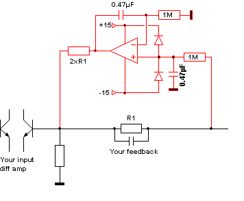

maybe its easier with a schematic, see attached file.
Add the red components.
Be sure your timer of the output L.S. relay is longer than the integration time (maybe 3or4 seconds) because the integrator starts with an unknown value.
If you don’t have +/-15V, make it with +/- Vrail , res, zener and capacitors.
For the ampop, use low offset one like LF411, AD711, or more expensive but not usefull (you dont mind +/-2 mVdc at the output of the amplifier)
If the voltage at the output of the opamp is higher than +or- 10V, choose a lower value or ”2xR1” .

Rservo (Your 2xR1) should be at least 10 x R1
You won't probably need these protections diodes and if you put them between the inputs instead.
If both the servo and the main amp are fed from the same voltage you won't probaly need any diods at all, especially if the amp has a transisent free startup.

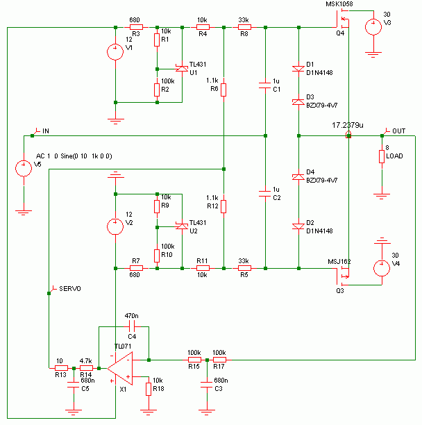

Thank you guys for the hints and especially peranders for the sim files. I now have a better impression how the servo output should look like. The circuit values I had before didn’t give anything near to results peranders has. One thing is that my amp doesn’t have a negative feedback loop. The servo of this amp should inject DC to the output biasing circuitry to balance the DC offset in output. Servo’s performance and also amplifier’s output bandwidth depends also from the biasing circuitry and input capacitor values. I draw up a whole schematic of the amplifier with servo to simulate it. It takes quite a bit fiddling to get the results similar to peranders’s because the situation mentioned above. Ill put the results up to you to evaluate if the sim plots are coming close.

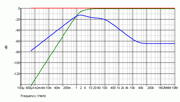

Don't forget that it doesn't matter if your main amp has feedback or not. The regards the main amp as a gain block only.
Avoid this first filter of the servo. With 3 poles you can get oscillations or get long settling times. One pole is the best but two poles are also OK but you will get small hump in the lowest bass.
Your component values are a bit missmatched but I let you fool around with simulation a bit more. I think you should calculate how you "injection circuit" should look like.

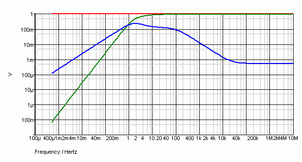

Looks great. The slight hump in the servo curve can be seen to keep the green curve up just a trifle longer, but that's very, very minor.
Should have no negative influence on the sound.
I agree with P-A that you probably can get away with just 2 RC's, cheaper and even more gentle curve. Also, I would increase the resistor from servo output to the amp to get an even better isolation from servo to amp.

Looks great - thats good news. 🙂
What you mean by 2 RC's and having resitor from servo output to the amp (right now I have 2 RCR's one in input of the servo and one in output)?
The simulated offset is 17.2379 microVolts😉

If you want to make the servo otimimal you must first examine the real circuit and check how much offset you have or will get. When you know than you can choose resistor values.
My recommendation is that you have a more high ohmish bias network. Remember that mosfet's are only like a cap so DC wise you won't need any currents. Increase the values to 100 kohms or more. If you have higher impedance for the bias circuitry the DC servo will get an easier task.
What Jan means is that you should only hav a plain intergrator plus may an output of the intergrator, not a filter in front of also.
I'm totally sure that you can get away with this without any temperature control. Maybe it better to have two current sources as bias and the servo stabilizes it?
