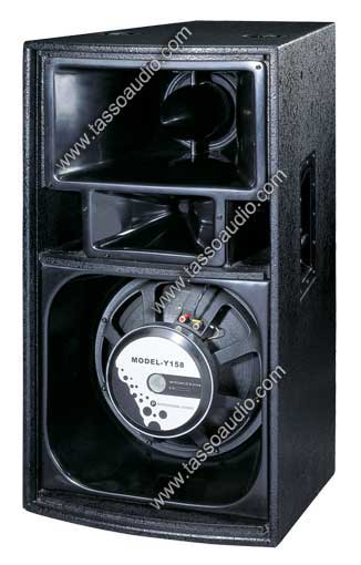

PA speaker designs
Hi
A lot of speaker designs for PA use very short horn like solutions.
I guess the theory is not amplification but more in regards to wish for control of direction of sound.
BassBoss VS21 is using some "hybrid" horn. It cannot achieve 1/4 of wavelenght. So my thought would be that the desire is to direct sound instead.
The speaker above goes to 25hz (-3db) and quite loud as well.
Is it possible to direct sound with such a short horn?
Kind regards
Asger

You can get around physics. If you want to control the directivity of 40Hz, you're going to need something that's about as big as 40hz. That's 8.5 meters long.
At music festivals, this is why the subs are set up in a wall:
Also, BassBoss VS21 is a slot loaded ported subwoofer:
It's not a horn.

With bass frequencies it is best to think of supporting a wave, rather than guiding it.
So we use a panel to connect the baffle to a boundary, and reduce the dissipation of the wave's energy.
Pretty much all we can do.
