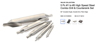

Get a set of Center Drills and have bonus deburring with the included 60 degree chamfer:
https://www.mscdirect.com/product/details/01035054

Bear in mind some tables give ideal cutting speeds in feet or meters per minute, you have to calculate the ideal rpm for your bit size using the circumference.
And get center drills, they are a handy item for many jobs, particularly for pilot and starter holes.
