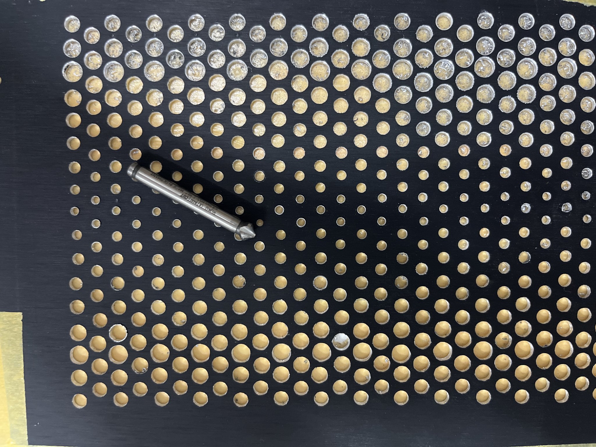

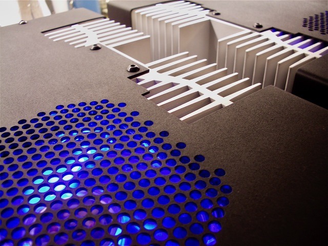

So I may have bungled a bit on my custom top-cover by sheer over enthusiasm.

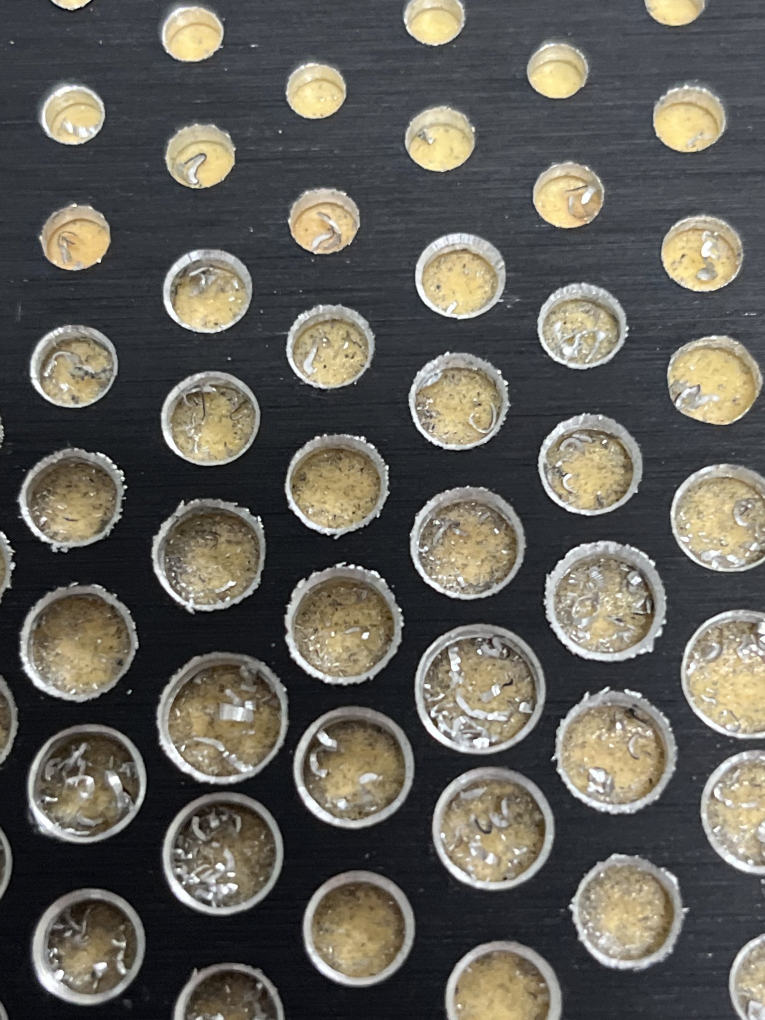

I drilled all these and was confident the holes would be shard and clean on the upper side, but the all have that tiny little sharp burrmaking it looking and feeling a bit rough.
I want to have them clean and, well, somewhat shiny, but don’t want to make the countersunk by ≈ 1 mm…
The tool I use tends to not bite unless I press so hard that it instantly cuts off too much material.
What should I use? Something to go with a very simple table-drill, or just a hand-tool?
(I was thinking of something that would rather grind than cut, but it’s 2 - 5 mm diameter…)
As you can see, this particular plate already is, erm, failed, but nevermind I fine if I can improve it (better than starting over, right?)
Thank you!

The job you did isn't bad at all IMO, and if that cover were mine I wouldn't touch it anymore.
Since you have (rightly) decided to paint it, I would give it a couple of coats of emery cloth of at least a couple of different shades to eliminate those (small) burrs and then I would repaint it.
In my opinion it would be great! 😉
Sand the whole panel flat/smooth with 320grit to remove the standing burrs, submerse the panel in sodium hydroxide solution to chemically remove the feather burrs remaining, then sand again and repaint.
Any kind of mechanical deburring will always leave tiny burrs remaining, and given the terrible machineability of most soft sheet aluminium, often quite big ones!
You'll always leave a tiny bevel with a countersink. If you make them all identical you could just market it as a design feature. The insides of the holes won't be anodized anyway, so what's the harm in having a little bevel showing?

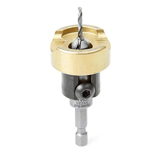

I use a countersink intended for woodworking and use a drill press. It leaves a clean bevel that can actually be pretty small. Certainly less than 1 mm.

Yes, sometimes perfectionism leads us to underestimate what we do ourselves. 🙄
The different diameter of holes are also nice.
All it takes is a little sanding, which you can perhaps insist on on some holes in particular, a splash of primer, a splash of matt black and it will be beautiful. 🙂

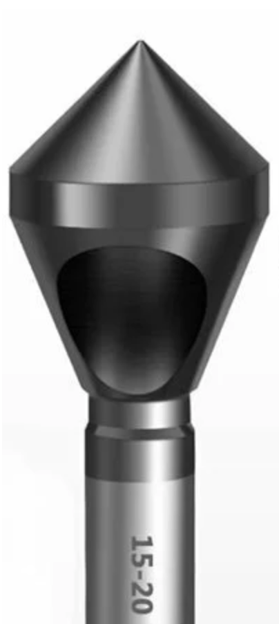

The angle of countersink bits is too steep to remove burs without cutting into the hole, as you indeed mentioned. For large holes you can cut through the bur with a special debur tool/knife. Best option with these smaller holes is follow the advice above and sand them with fine emery. Start with light pressure so as not to push the burs back into the holes.
