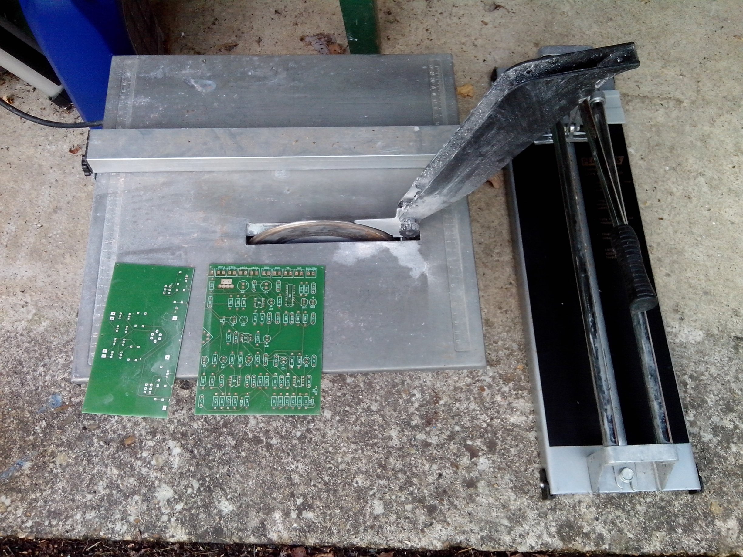

Does anyone know of a way to cut PCBs at home? Say you have a large board and you want to cut out small pieces.
One way is to use a Stanley knife to score the copper on both sides and as much of the board as possible and then try to snap it on a clean straight edge. This method is too slow and prone to accidents and slips with the blade.
I have also tried an electric jigsaw - the problem here is that the fibreglass boards destroy the jigsaw blades very easily, a few centimetres cut and the blade is worn out.
Can someone please suggest another method? I have looked at shears, like these: Sealey 3S/4R 4 x 10mm Metal Cutting Shears: Amazon.co.uk: DIY & Tools
but I have never used such a tool and am not sure how it would work. Would the PCB stay still or would it fall off and crack maybe?
Thanks for suggestions

A 24-36 TPI carbide tipped 5-1/2" circular saw blade would work very well so long as you prepare for the dust. Framing blades for these saws have a very narrow kerf with all the obvious advantages. I don't know if the finish blades can be found as thin but for a sheet of glass-epoxy the more teeth the better. An appropriate blade in a tile saw would be nice if you have or can borrow one. The water would trap the nasty dust. Just some alternative, alternative ideas.
Amazing. As soon as I read "tile cutter" it clicked! I remembered I had two tile cutters in the garage. The manual one, seen on the right works by scoring the tile and then snapping it, obviously not good for PCBs (but I tried nevertheless). The tile saw on the left is the business! It cut through the PCB like butter, and it gave off a little dust, but nothing significant. I am not sure I want to put water in there, since some PCBs have pressed paper in between. Anyway, the results are fantastic and it seems I do not need to buy a new tool!

Thanks for all suggestions. I think I will use the tile cutter which is like a small table saw, as in the phone above.
